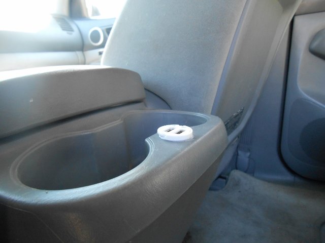

    For a couple of bucks more you could just install a cigarette lighter / accessory plug there and plug the USB thing into it. Makes it so you don't have to worry when the USB thing craps out (I've had them die on me before) about replacing it (just plug in a new one) and allows you to use other things that aren't USB powered.
