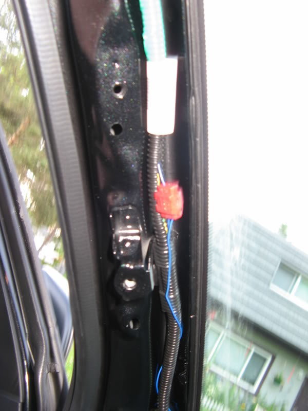

    No need to wire up to the pillar, you can connect to pin9 on the wire harness in fuse panel lower left corner.
    this is my version
    http://www.tacomaworld.com/forum/li...ome-light-circuit-lots-pics-wire-routing.html

    I dont seem to have the same colored wires on my 2010, almost the same but not all the same. Anyone done this on a 2010?
    Also, when using the locker in 4Hi, does it disable TRAC?

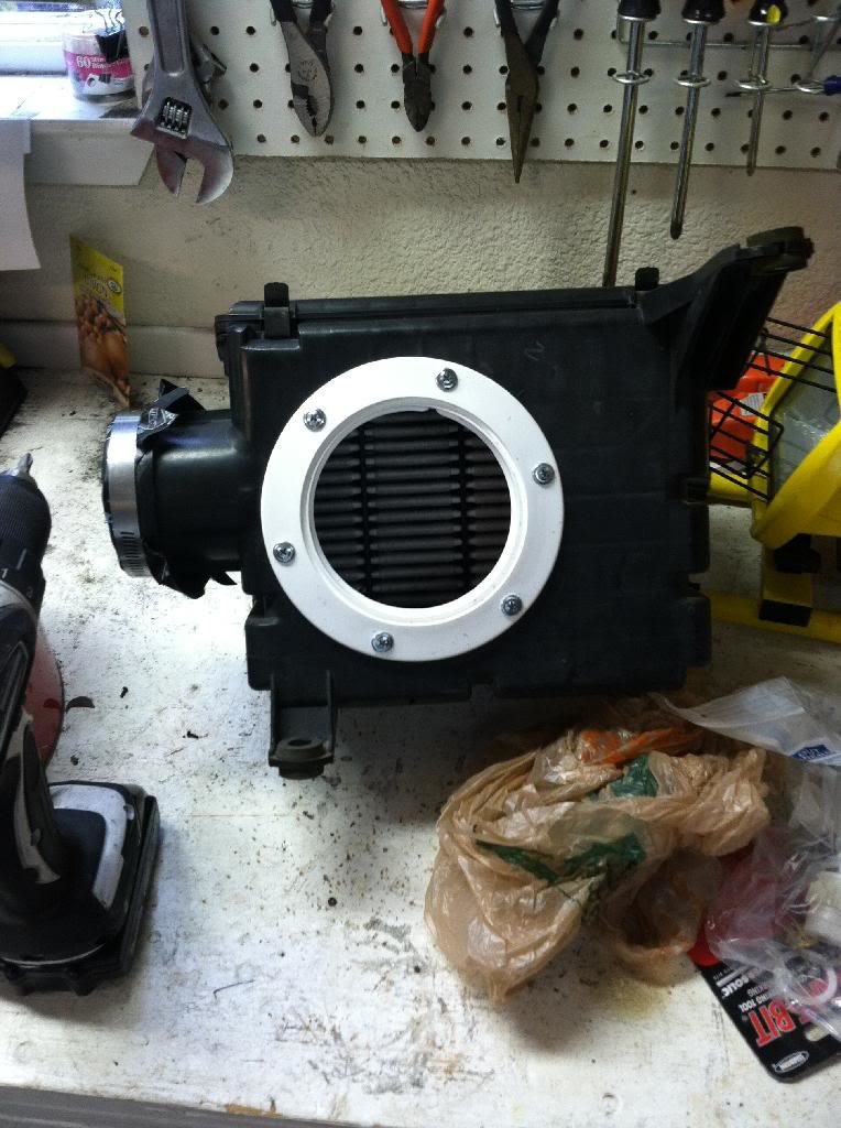

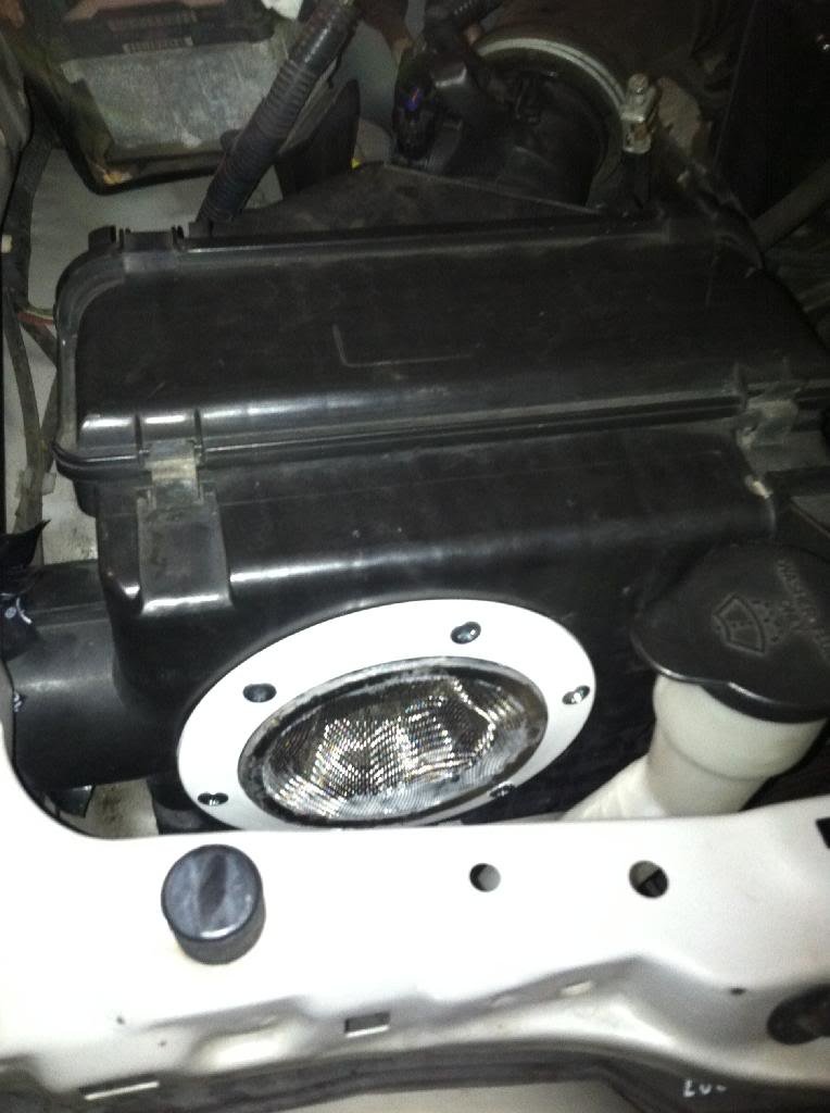

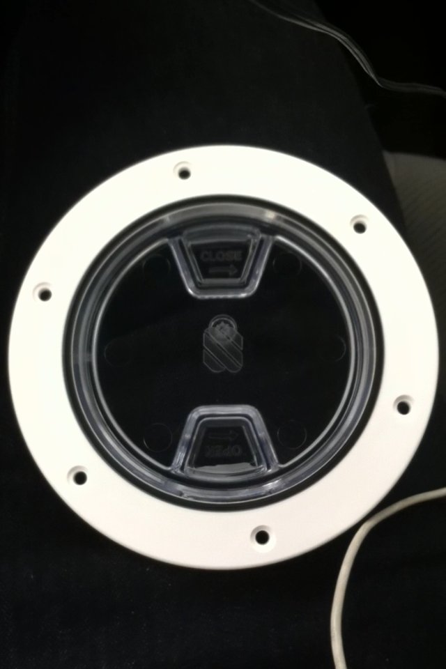

    I saw this one the other day on a different website, old school mod...Here's a cheap mod for you guys only about 20 bucks... Apparently alot of cold air intakes are not good for our motors and heads and everything, so I referred to this old school mod. Going to pismo this weekend I had to do something so I wasn't gunna suck sand straight out of my wheel well( the OEM location. First go buy a deck cap from a marine/ boat store it's cheap!
    CF8A72FE-4CD4-4641-BB27-952C23DCD3AA_zps_9f5ee6fddd6201a12aeec4d8f6029b8b093c866d.jpg

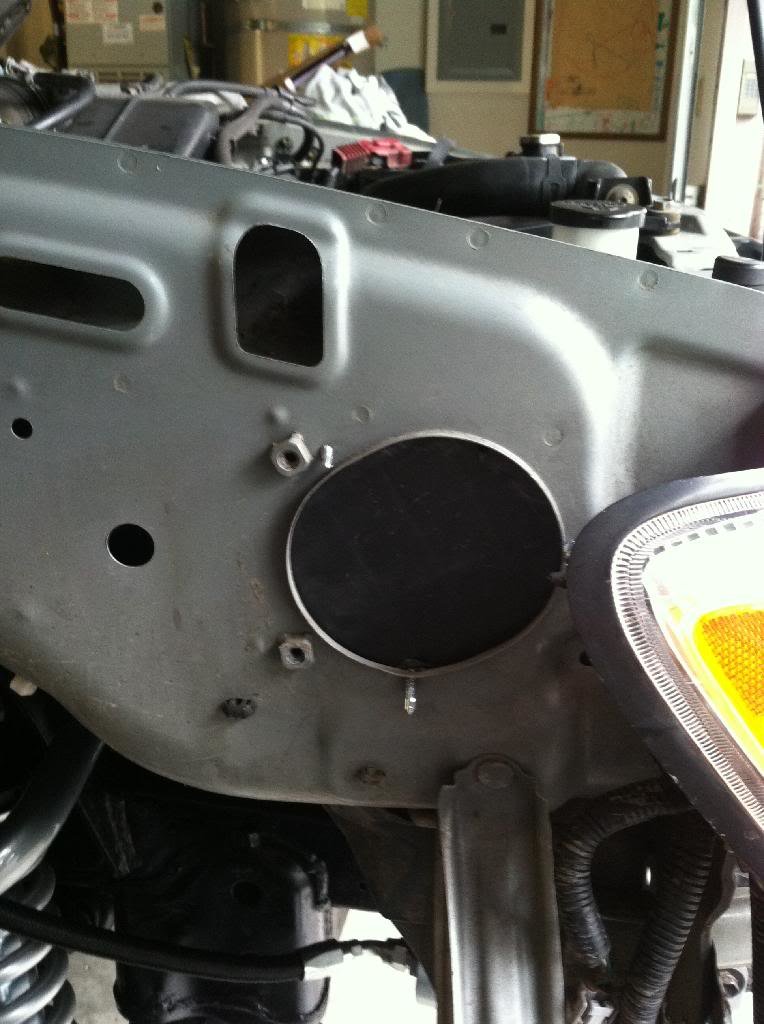

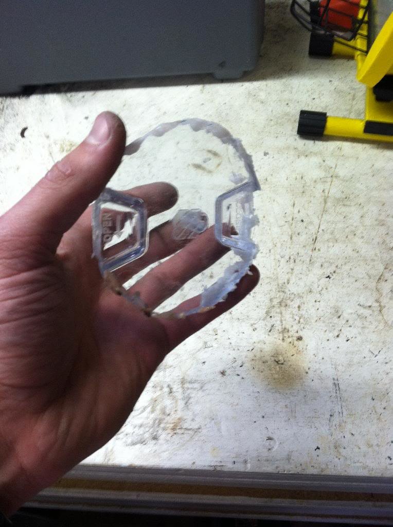

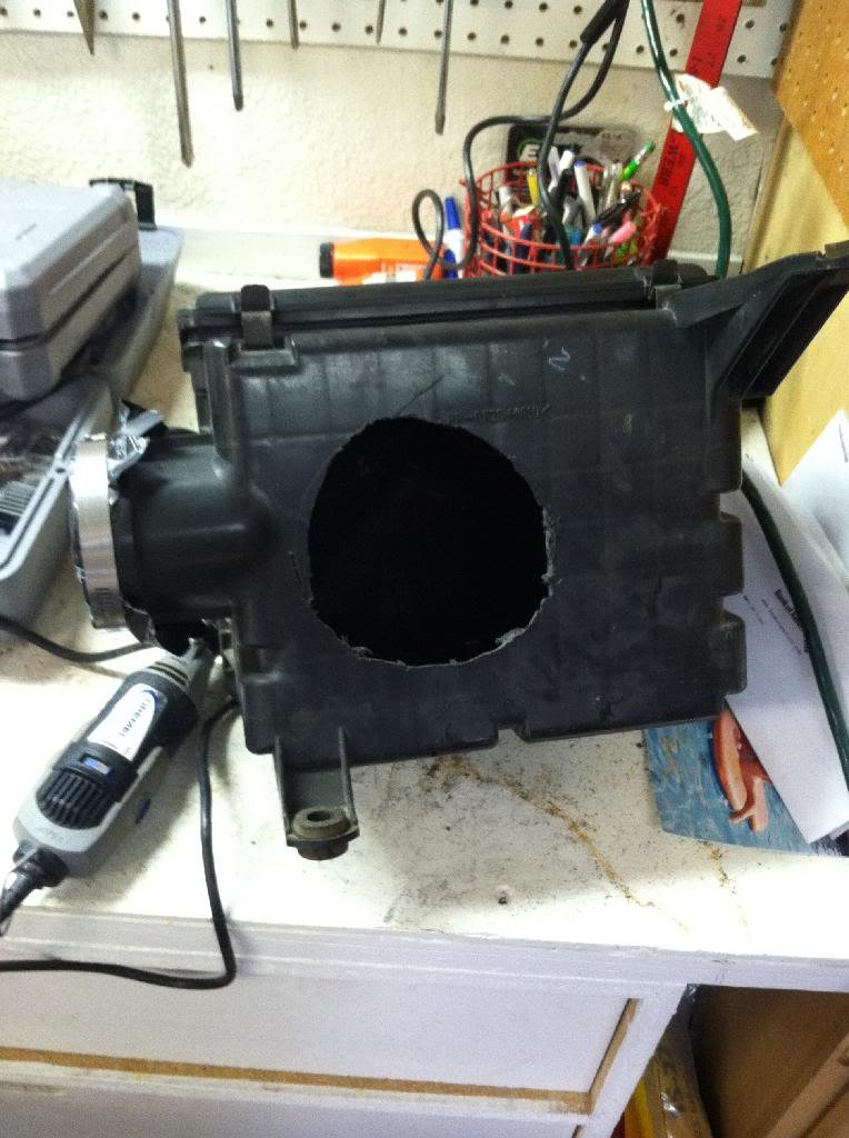

    Then cut a 4inch hole in the front of your air box ( location will be behind your headlight), and block off your OEM intake port... Be creative I used a hose clamp and plumbing tar tape.
    094B4269-A063-4AF9-BFA1-DCA0BE87D82B_zps_6ebb8b13388ae8032ecdb6a0e09a1eee9bbbf79b.jpg
    ADAD2D19-E6E5-4C1A-A830-9B9F0BB4910C_zps_671c285dfb601d846f963a77fdb970a7b1f753a4.jpg

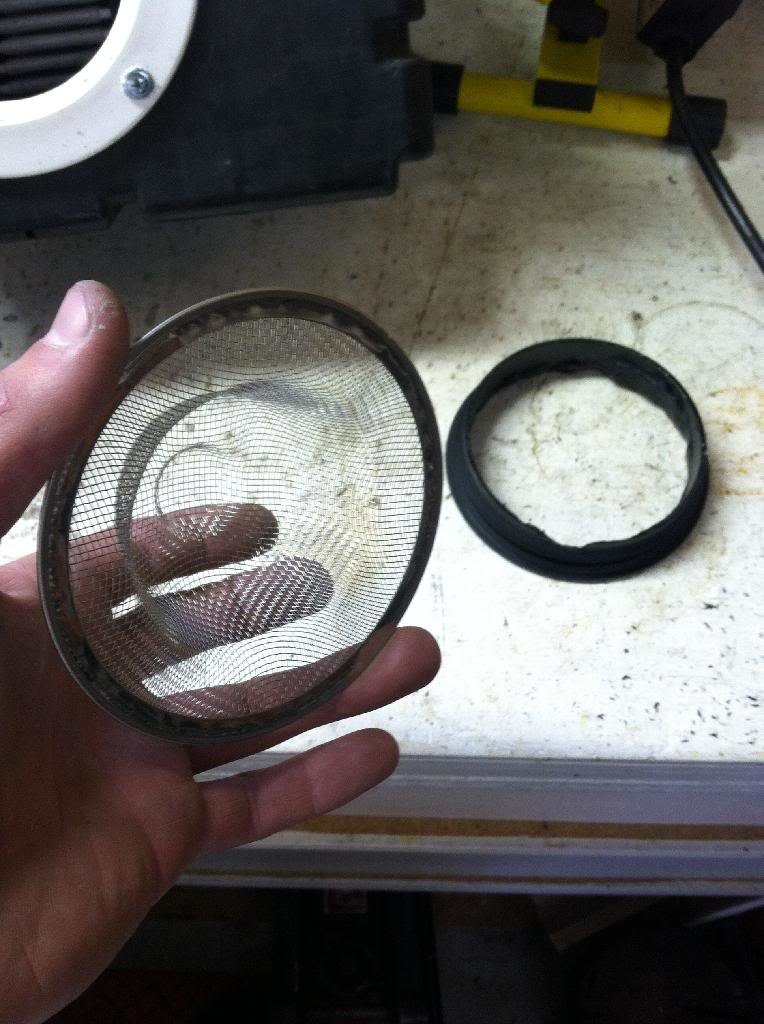

    Also buy a kitchen sink drain catch mesh thing lol
    2B863DBD-754C-4C73-A97E-9AE869BD3BF0_zps_ea3c99296dff5ffd9fe58a2cc53ac38cdf9c2fbe.jpg

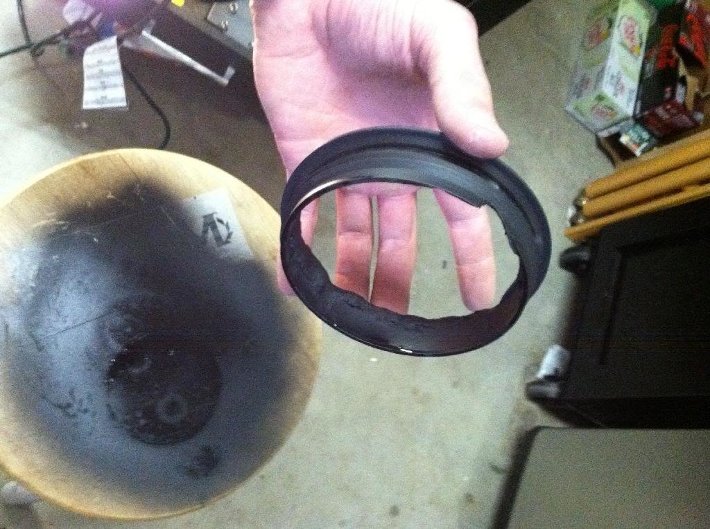

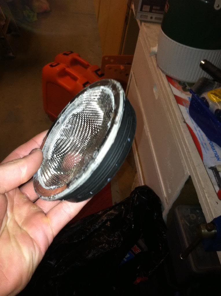

    Then unscrew the center of the deck cap out and cut the center out to fit the drain mesh in and jb weld the screen on
    4F2190FF-C96F-4479-A0D4-446E82C5FD8C_zps_6ae75a84fc7274b5096e7e5de497732fb99c0a51.jpg
    3AD5E08F-B994-4C7C-A57C-6C61F931F063_zps_73070e56745acde8b5ee6df8bef121e5117616cb.jpg
    D494050C-00B7-43AA-8DC6-D1A1D42C4D50_zps_670b572a5100b10215948c5a21a3a266ad672d0f.jpg I painted my ring black btw

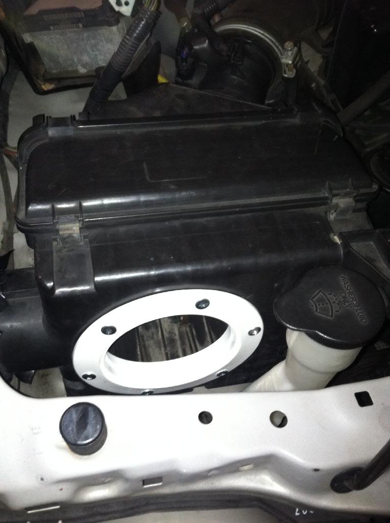

    Fit in the outer ring into your airbox and screw it into place
    ABCC38D9-6DBD-46CD-8281-60E4DE7AB3B3_zps_6211c5791f3ec20f3993c53395f6314344c27df1.jpg
    Now reinstall your intake... Without the screen insert you will get the most performance increase an I DID notice a small increase in throttle response and power but this mod for me is more for the intake location so I don't get stuff in the box. You can now screw the screen in for off road use and keep it off for on road if you want to.
    8E06F8A0-BF15-4117-86C9-CAE038CC9DEA_zps_323bb3a32cf441ce5b9fbb02da515f1bd1d3046e.jpg
    22BDD6BE-C0FD-4D71-8AE8-19B8AD3E4FA3_zps_8e92f12c1190aa7b90f8f4198abbaa309b054a59.jpg
    Anther thing to note as well is if you are not worried about your wheel well oem intake location, you can keep the original intake port how it is and just by adding the port infront, therefor creating 2 ports, you will gain the most performance out of this mod, but I deleted mine due to debris getting sucked in the wheel well. This mod is apparently better for your motor than most cold air intakes. It doesn't look as cool but I'm about function I guess. Although the aem and k&n systems look sick! Well enjoy!

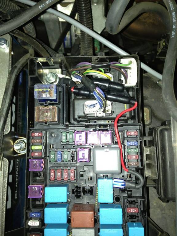

    Here's a twist to the good ol' fog light anytime mod. There is no reason to cut into your factory wiring harness for this mod. There is a perfectly good 12V hot right there in the fuse/relay panel.
    Items Needed
    Crimp ring terminal
    In-line fuse holder
    Crimp female spade terminal
    You still have to bend the leg of the relay, but you don't have to splice into the factory wires. The fog lights will come on even if the truck is turned off so don't go draining your battery over something silly.
    The in-line fuse holder that I picked up had a good length of wire attached so all I had to do was crimp on the fittings and wire it up. You do need to make an access hole between the partitions. I used the dremel to make a divot in the plastic.

    ^is that one always hot though? I the mod I posted you don't cut the factory harness, you use a quick splice that leaves the wire intact, and the fogs only come on when the key is turned to on so you can't leave them on accidentally and drain your battery.

    That is the main feed for the fuse/relay box, so yes, it's always hot. Don't leave them on and you won't have a problem.

    Thought so. Bumped too many switches and come out to a dead battery too many times to do that. Might be helpful for others thought.
