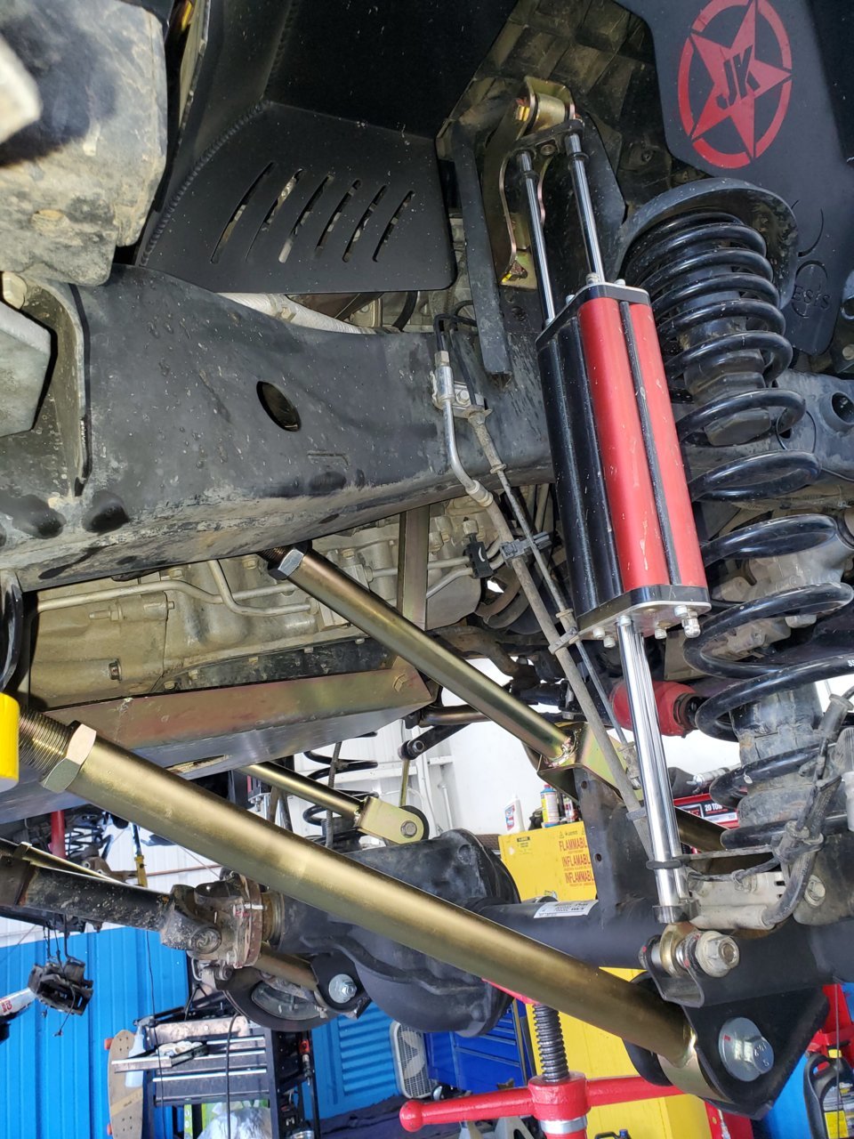

    Idk how to do emoji's but I'm drooling over here, 24" of up travel and 24" of down travel, whole Lee crap...
    Metal Cloak 6 pak shocks look crazy cool.
