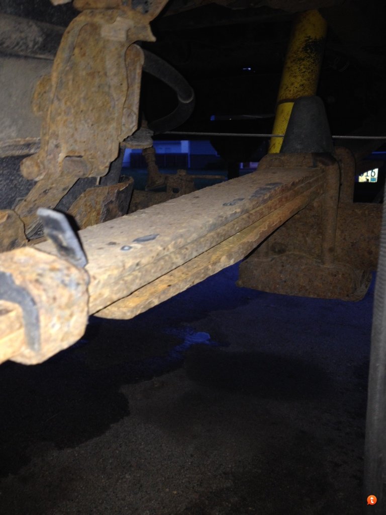

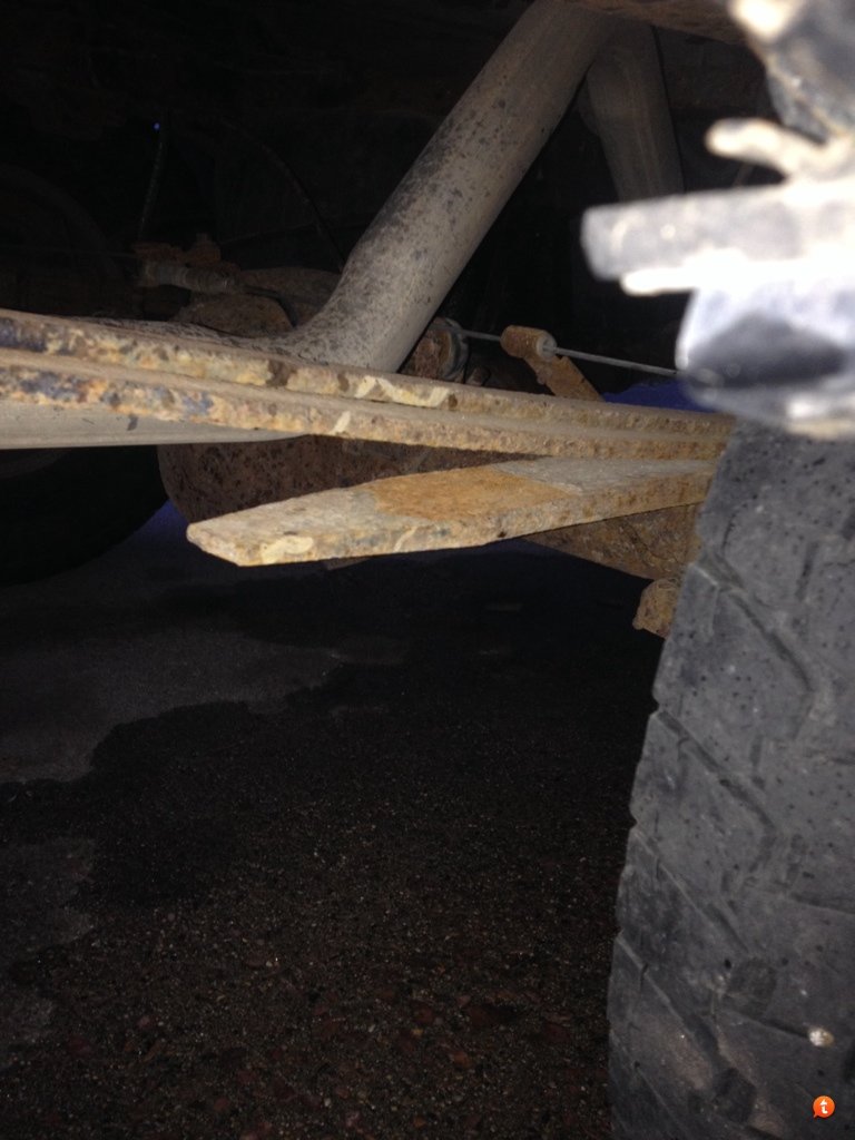

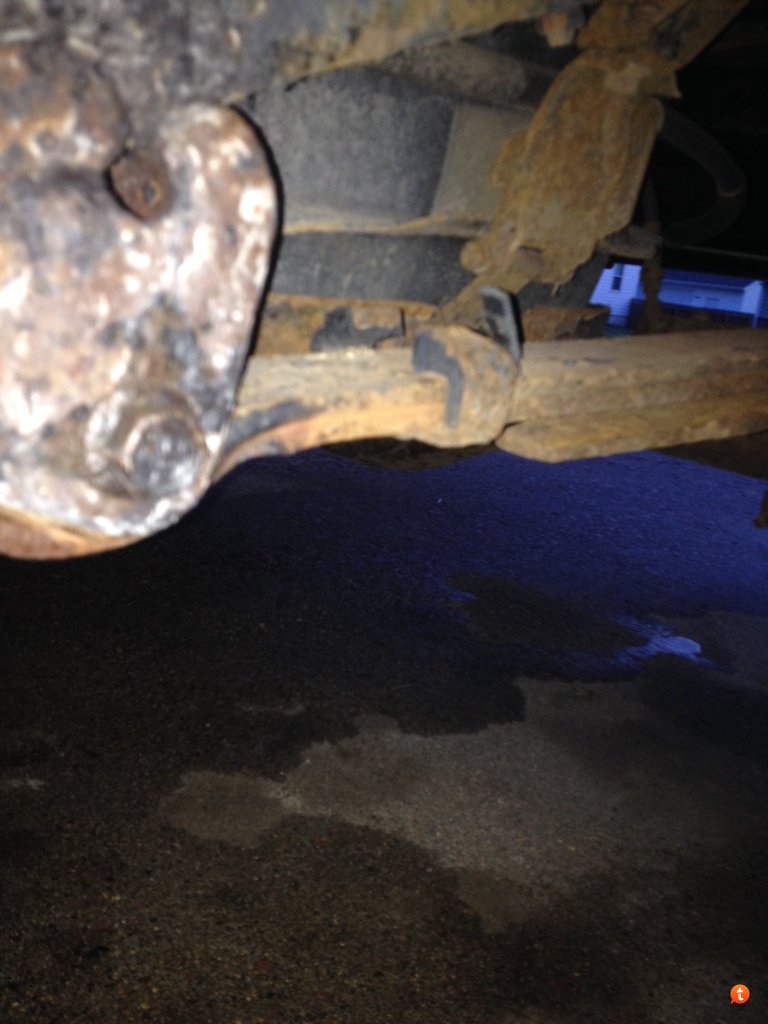

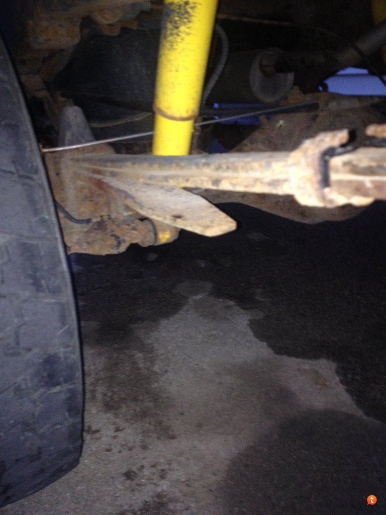

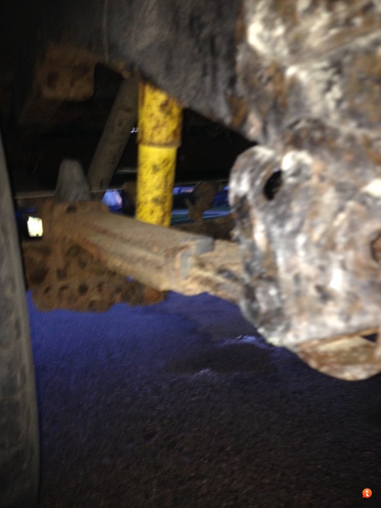

    Passenger side:
    e4emuvar_aab7902a9a1afdc73f451606ad4aa23a8345896d.jpgsama2yva_8ef7a55e52f9de36c1038dd4676373d384e972a5.jpg
    Driver's side:
    yruruvev_8b30ec86a6d7c8b322340ca150de5387e0e93eae.jpgtumemaqa_0c4d74826480cfdbff8e4974823758147bdd4f26.jpguru9y5u8_71992fa5f551eb312ff2b712f51acb6f730aedde.jpg

    Were you able to make anything out of the pics of my rear leafs 4wd? (Other than they are rusty lol)

    Sorry for lagging,:eek: Haha, yeah you have a bit of a rust issue for sure , from what I see, I thought you had stock springs at first now I'm a little confused, in first pic you have what looks like 3 springs minus an overload, but appears to be 2 leafs collapsing on what looks like an overload thats been flipped over, other pics look like stock leafs minus 1 (2 leafs with overload) I agree tho' theres something not quite right going on, stock 1st gen 6 luggers have 3 leafs & overload, now for the front if you get some 5100's (I run the 5100's for 1st gen tundras) you can use your stock coils & get your 2.5" lift by moving adjustment clip up to highest setting
