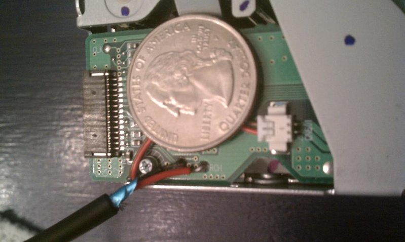

    I'm new to the forums and wanted to say thanks for this Mod. It works great. The only time i get bleed through is when I am not playing any music on my phone but it is still plugged in. Then I get the muffled sounds of the current CD, the muffled sound goes away as soon as music is being played, even if playing silence.

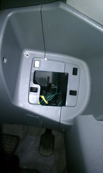

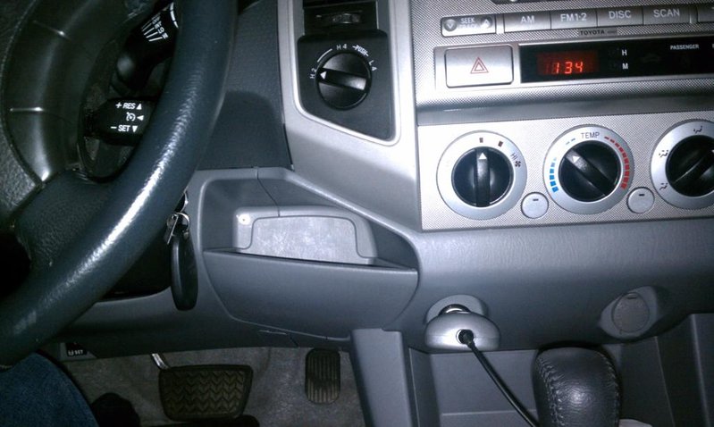

    Here is one picture I wish I would have seen, I was unprepared for the size of the sodder points when I opened up the radio. I chickened out, put it all back together, then felt like a wimp so i took it back out of the truck and went for it. I'm glad I did, it works great.
    Here is my jack location, It was easy and well hidden, just in case the next guy doesn’t appreciate my modifications. (resale value!)
