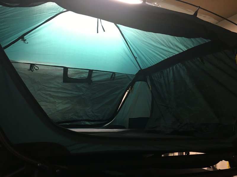

    I will be going on a couple day off-road trip at the end of April in NH. I will be going with a few others and we will be camping at a couple of state parks. I have a regular tent but wanted to see what I could come up with for a cheap and easy RTT alternative to get me up off the cold ground. I have a 2016 double cab with the short bed covered with the factor tonneau cover. I had a Thule rack from a previous car that I decided to modify to work with the tonneau cover. This would then give me the load bars I needed for holding my RTT idea. So for the RTT itself. I looked around for ideas and came across the idea of a tent cot as a RTT. So I did some research and decided to pull the trigger on a kamprite double cot tent from Amazon warehouse for $150. It weights a little over 50lbs and has plenty of room for just me. In order for it to work with my load bars I had to take the four legs off that come with it. This is an easy task as the just bolt on. The only thing I had to make were some easy little wooden legs for a bar that runs down the middle of the tent and a cover for it while bolted to the load bars. To secure the tent to the load bars all I needed was 4 u-bolts. So far I have tested it out in my garage and it seems really comfortable and very stable. Hopefully this might give others an alternative if on a budget.

    Can you get some pics of the inside?

    I only have one picture right now that isn't that great but I will try to get more tonight.

    I really don't know yet from my own experience as I haven't had it out in the weather yet. I have seen many good reviews on it though. I does come with a rain fly which I will try to get a picture of it. TSki might have some better real world experience with it since it sounds like he has used it for camping.

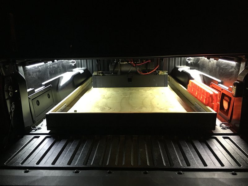

    Thank you. I have been struggling for a bit trying to find a way to sleep on or in the truck for short trips and I came across a site where another person did the same sort of thing. For me it is great. It is pretty cheap, should keep me warm and dry, easy to setup, and allows me to still use the tonneau cover to keep my gear dry and protected. I made a bed slide also which makes it handy to get to the gear.
