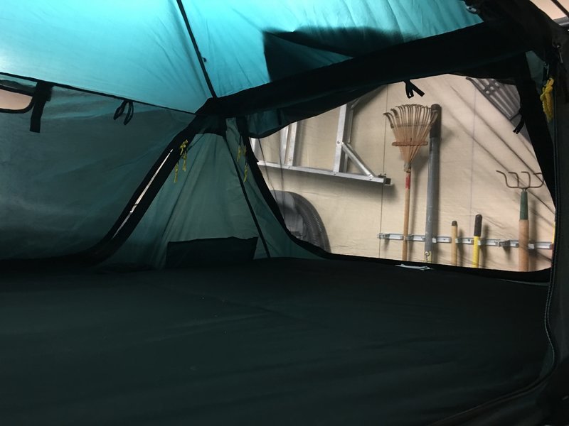

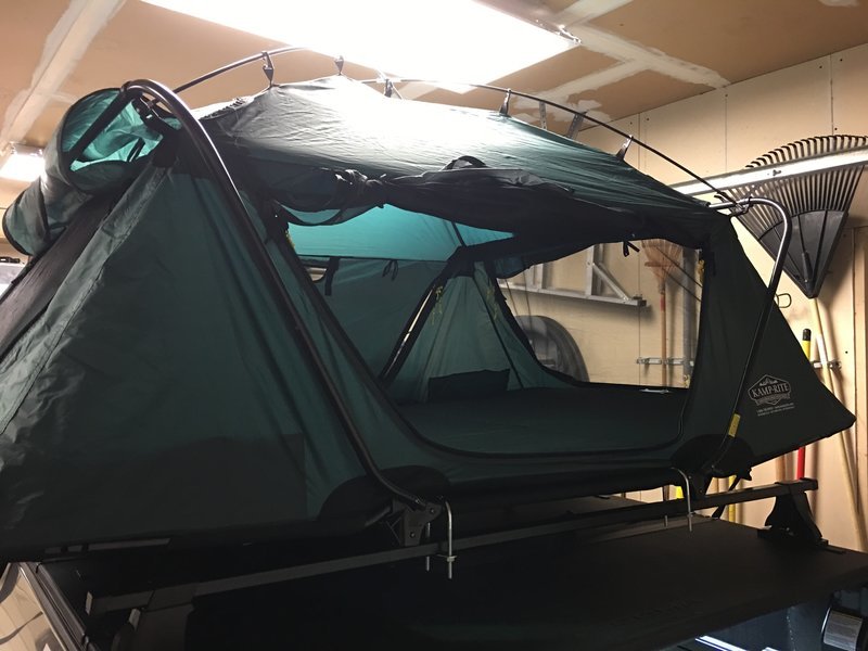

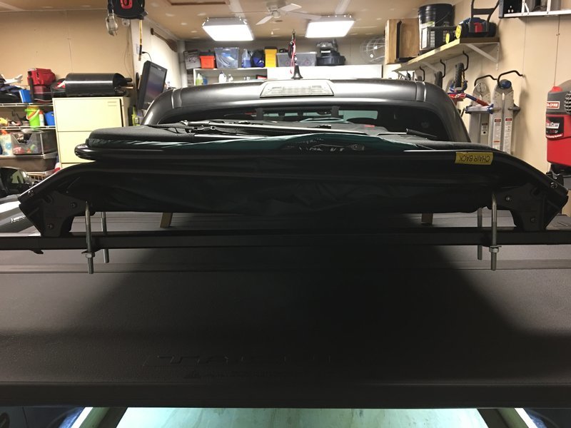

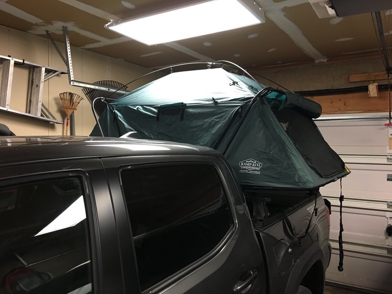

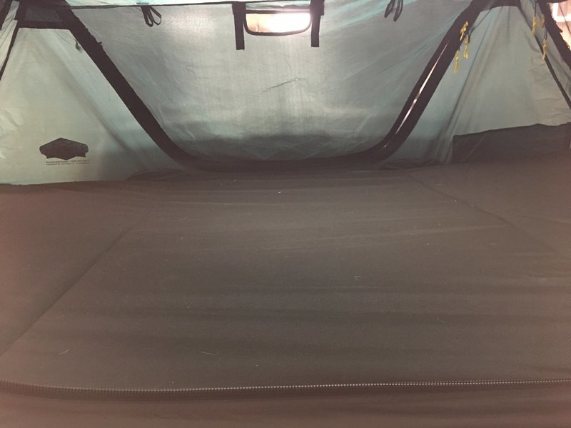

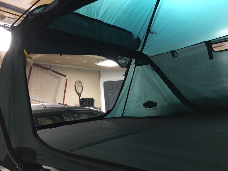

    Here are a few more pictures of the inside and outside.

    So is that the regular or double tent?
    Thanks for the pics.

    You are welcome. It is the double tent.

    Love your idea. Question. What are you doing for the floor to make it rigid enough to hold weight.

    How did you mount the Thule feet With the tonneau? This is a great idea

    The floor of the tent is made like a cot. This means it is made to take your weight without needing to be hard. The only extra bracing I had to do was cut some primitive looking wood legs to bolt to a post that goes down the middle of it. You could put plywood on each section of the folding tent if you wanted to but I do not really see the need for it. I hope this helps!

    Here are some pictures of how I modified the Thule feet. Basically the Thule feet have an outside bracket that has some sort of angle piece pop riveted to it for the specific model of car it was being used on. I removed that piece and bought some L shaped aluminum from Home Depot and cut it to about 4 inches in length. I then drilled holes in it and pop riveted it back on to the outside bracket. Then I had to even out the rubber portion of the feet due to them having an angle on them also for the vehicle I had them on previously. They kit very tight and don't move at all. If I didn't have the Thule ones laying around I would have bought the ones voodoo sells.

    It is simply mounted to the Thule load bars with four u-bolts that go over the metal bracing built into the cot. You can sort of see this in this picture.

    The floor is built like a cot so it is like a canvas material that gives with your weight but is supportive. I believe it can hold 500lbs.
