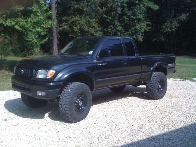

    Deckplate mod, black KC slimlight fogs, hurculined bed, NRA sticker mod, painted rear chrome bumper black, black fender flares and front grill surround, HIDs, All-pro rear leafs and UCAs, Eibach coilovers, billys all around, flat black pro comps, 31x10.5x15 BFG KM2s
