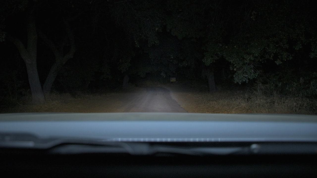

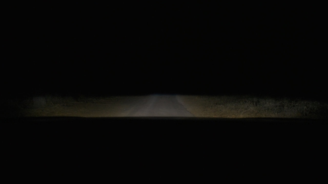

    We all know who's going to win and I did not seriously compare the 2 lights. It was just for fun and to satisfy my curiosity to see how much better the expensive lights are and how close the performance was despite the big price difference.
    The CaliRaised 40" slim light bar is 200 watts and has no claimed lumen output. The Baja Designs XL80's are 80 watts each, 160 watt combined and produce 9500 lumens each with 19,000 lumens combined. The XL80's actually draws less wattage and produces more lumens, although I dont really know if the specs on the CaliRaised light bar is true or if they just got their number from thin air, could be why they don't list a lumen output. I would guess that it produces about 15,000 lumens and that's being on the high side. I seriously thought the CaliRaised light bar would perform much better, it was a serious disappointment and the color temperature is not ideal for me at all. The BD's color temperature matched and blended with my low beams nicely, the CaliRaised did not match or blend with my low beams, it created a harsher light.
    NOTE: The Xl80's were aimed a couple of degress outwards and not straight forward creating a less intense hot spot, both lights are set at 90 degrees vertically and are combo/driving beam pattern.
    All photos were taken on my Nikon D7200 with a 18-140mm lens in Manual mode with fixed shutter, aperture, and ISO.
    HID 5000k Low beams:
    Low beams + CaliRaised light bar:
    Low beams + Baja Designs XL80:

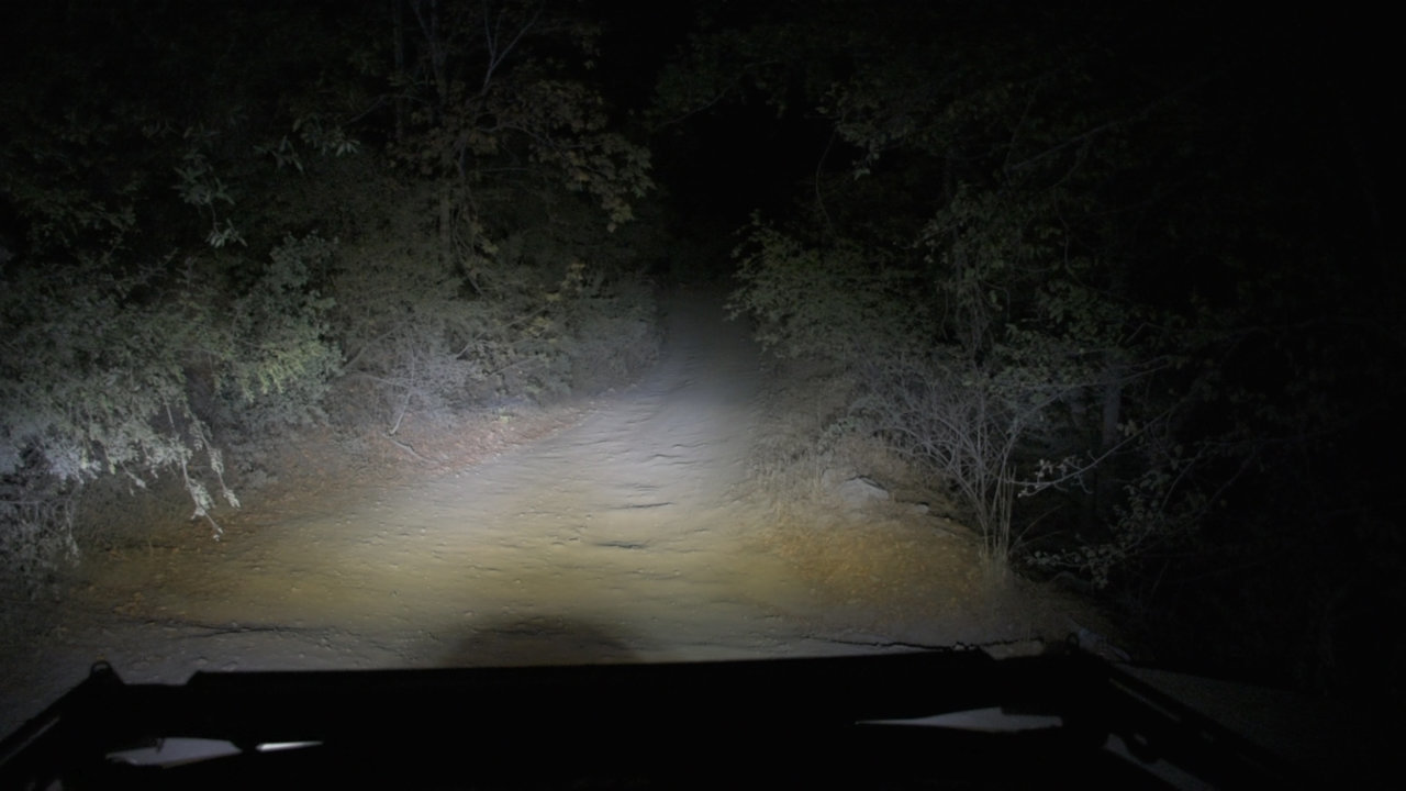

    Different location

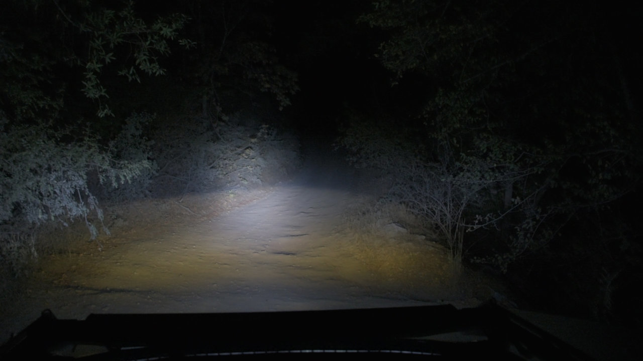

    As usual, you get what you pay for. Light output, color quality, and build quality all come into play. Baja is one of the best and Cali caters to budget buyers. The color temp is something I think many overlook, as high color temps are really not ideal. Note that led lights advertise ‘raw lumens’, the conversion to ‘actual lumens’ will be higher in high quality name brand lights.
