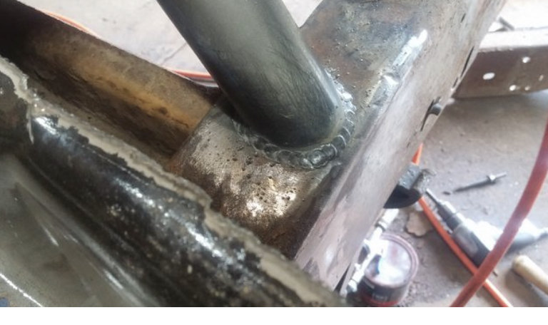

    I have this welder. My 12-yr son has done some competent welding with it after taking a MIG welding course. We are building a go-cart. The welder is very picky about having a good ground. Use a flap disc in a grinder to clean the metal you are welding and for the ground and you'll be fine.

    Same welder I have. With anti-spatter spray I've laid some impressive beads with solid penetration. Go for it
