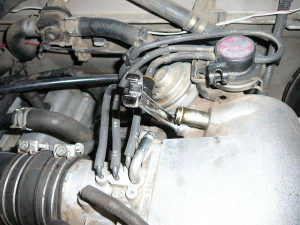

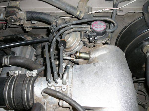

  16. Feb 2, 2014 at 9:13 AM
    #16
    tan4x4
    tan4x4 Well-Known Member
    Nov 30, 2011
    #67982
    3,809
    Rick
    Folsom, CA
    99 Tacoma EC 4x4 2.7L Auto
    Bilsteins, OME 881's, 3-leaf AAL, Detroit TruTrac, Tundra brake swap, Michelin LTX AT2, Tranny skidplate, TC skidplate, CBI rear bumper, TG sliders, UltraGauge, PowerTank, Reverse Camera
    Maybe the will help. This is what I had to do. See attached photos.
    This just shows the EGR area:
    This is the same view with 2 annoying hoses dettached:
    Same view with wrench fully engaged with sensor:
    I also soaked the sensor thread area with PB Blaster and let it soak for a few hours before I put any force on the wrench. Be sure to push the top of the wrench toward the firewall (lefty loosy). I know there is not much arc there for the wrench, but once it 'broke free', I could unscrew it with my fingers (after disconnecting the pig-tail of course).
    The evap hose split a bit at the end, but its still holds a vacuum. I may have to replace that eventually. Those vacuum lines of mine are likely original (15 years old), so I would expect to have to replace them (picknpull trip?). Its all part of the process of wrenching on old vehicles. Sometimes electrical tape is enough to prevent a vacuum leak. Those pre-bent larger vacuum lines can be pricey.
    Good Luck
