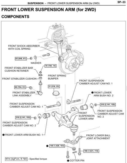

    Well if anyone else can help I have another question on my problem. If my problem is with my LCA bolts, since my truck is a 2wd not a 4wd does that mean the torque on them would be different than 100ft/lbs?

    This shows 155 for 2wd LCAs: https://www.tacomaworld.com/threads/the-torque-spec-guide.318116/

    Just go to 120 lb/ft. It's fine, you won't hurt those bolts, they're super strong
    Remember to counter-hold the other end of the bolt so the whole thing doesn't rotate and throw the alignment off. Even though technically once they're popping and shifting the alignment has already moved..

    Tried to do 155ft/lb but couldn’t even get it that tight. Just got it as tight as I could and popping sound went away. After I noticed when I’d turn my wheels all the way left and right (while in park or stopped) my bushings would make a creaking sound. Makes no sound while driving but still worries me. Got my mechanic to come take a look and he said it’s fine and not to worry about it but idk, fingers crossed.
