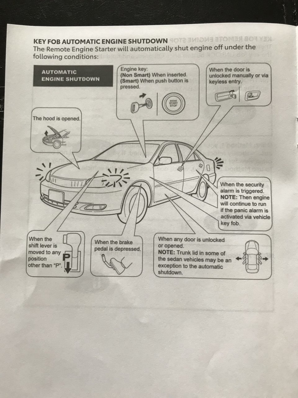

    Thanks man wow that explains a lot I will save that for future use. For once I see instruction with Canadian laws etc. Good find
