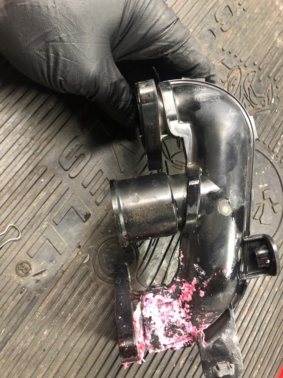

    Makes me wonder if the hook in the end is sometimes being used to assist in engine installation at the assembly line. If so, that would explain some failures. I would be tempted to try some plastic-weld if I could locate the exact leak point

    What are the other reasons?

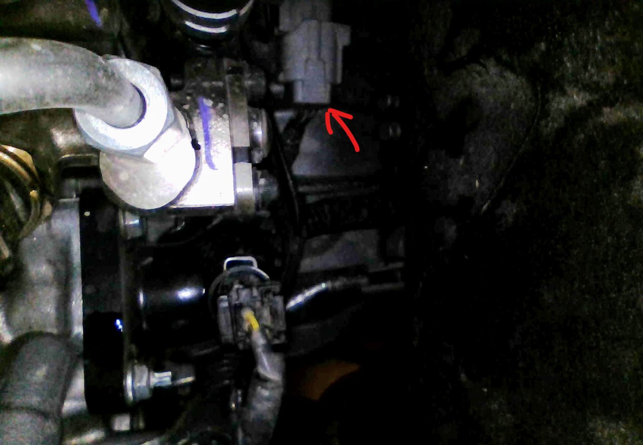

    I could be wrong, but it looks like it could be the support for this connector:

    Yes I saw that and it appears to be its main purpose. However, during installation I'm wondering if its sometimes used to ease installation.

    Just shooting from the hip, but I would not think so. I believe the driveline is assembled on the frame first, then the cab is tossed on top? With all that room, I think they would have a bunch of more useable points of supporting the engine / transmission combo.
    In his thread, I think @Jowett had a theory about the mold design that contributes to the leak issue. I'll see if I can find it.

    No, what you say makes sense I'm just thinking there may be some maneuvering of the engines from the time its assembled in one factory, to the time its assembled.
    Its really just me shooting off at the hip trying to find a logical reason for the failures because that should not be happening as it is, or creating worries about ownership.

    I couldn't find the post that I was looking for. Given that the part is fiber reinforced nylon and has some steps in some area of the mold, bad infill or porosity in the mold combined with heat and pressure cycling could be the explanation. Fiber reinforced nylon is stronger but more brittle than plain nylon.

    The only reason I think of the hook being used to maneuver the engine around from one place to another is because I've seen it done in other applications (makes/models) to maneuver them and since the hook is there, it maybe tempting to some to use it.
    Plus it make me sleep better thinking that mine may not have been used like that lol!

    Hahahaha! It is silly if the mold is flawed and they used a million of them.
    Of course, there have been plenty of flaws in metal castings also.
