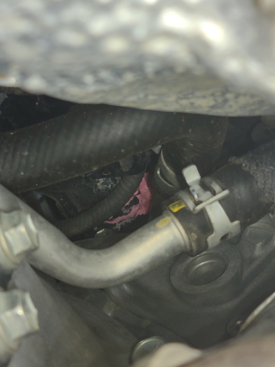

    I did some research on that right before I bought my 2021. The way to see if you have the problem is to look at the right side of your transmission at the connection point. If you see pink stains, you're affected. The actual repair itself requires Toyota to lift the cab off of the truck (I don't have the link but there is a youtube video detailing all of this)

    Removing the intake manifold is enough to gain access to replace it, still tight, but doable. That was the way mine was replaced

    Fyi no coolant leak looks brand new still

    I had to change my oil today so I figured it would be a good day to check

    This little endoscope is badass

    Thanks @tonered for recommending that product

    Great to hear!
    I think it is sporadic, but comforting to verify.

    After my ECGS Bushing install, I caught a glimpse of it, 47k
