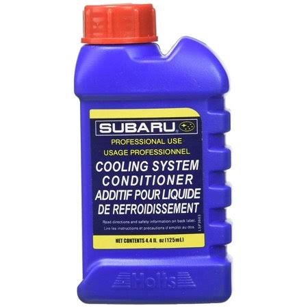

    That stuff is a band-aid, but can buy some time if the leak is very small. I've had a head gasket seep on my Impreza stop and stay leak free for 7 years, but probably only about 20k miles, after using that stuff.
