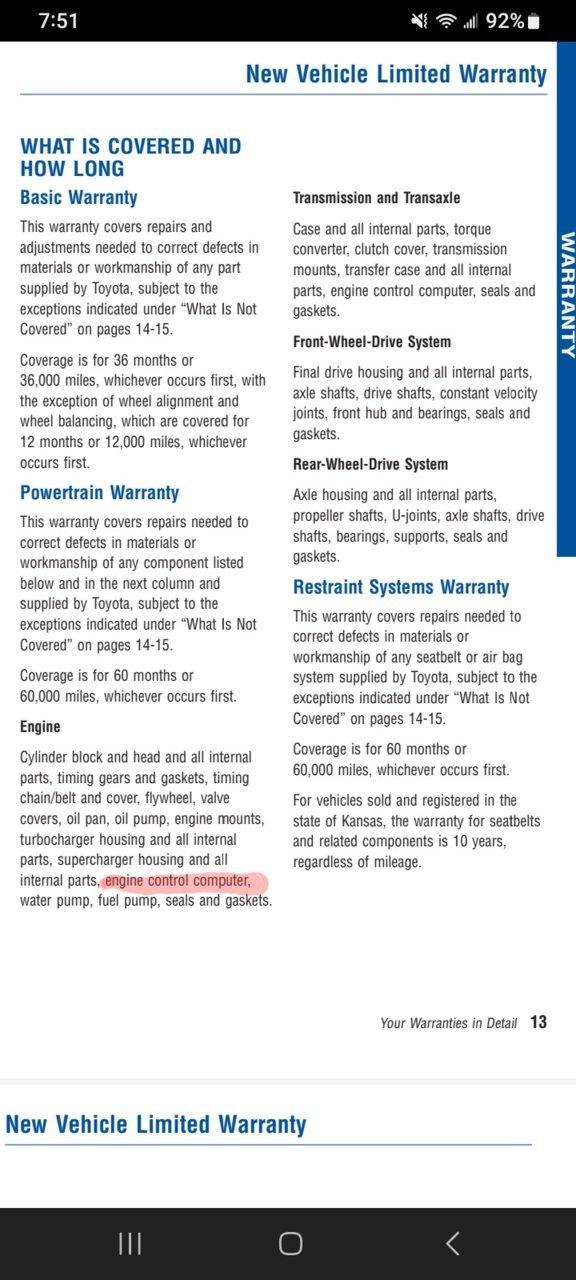

    Are you saying you were successful in getting it covered under warranty?

    I used to be a service writer for car dealerships. Power train warranty is anything that is a internal lubricated component and computers that control power train. A coolant hose or pipe would not fall under that.

    The Toyota service writer explained to me any computers are not covered under their power train warranty.

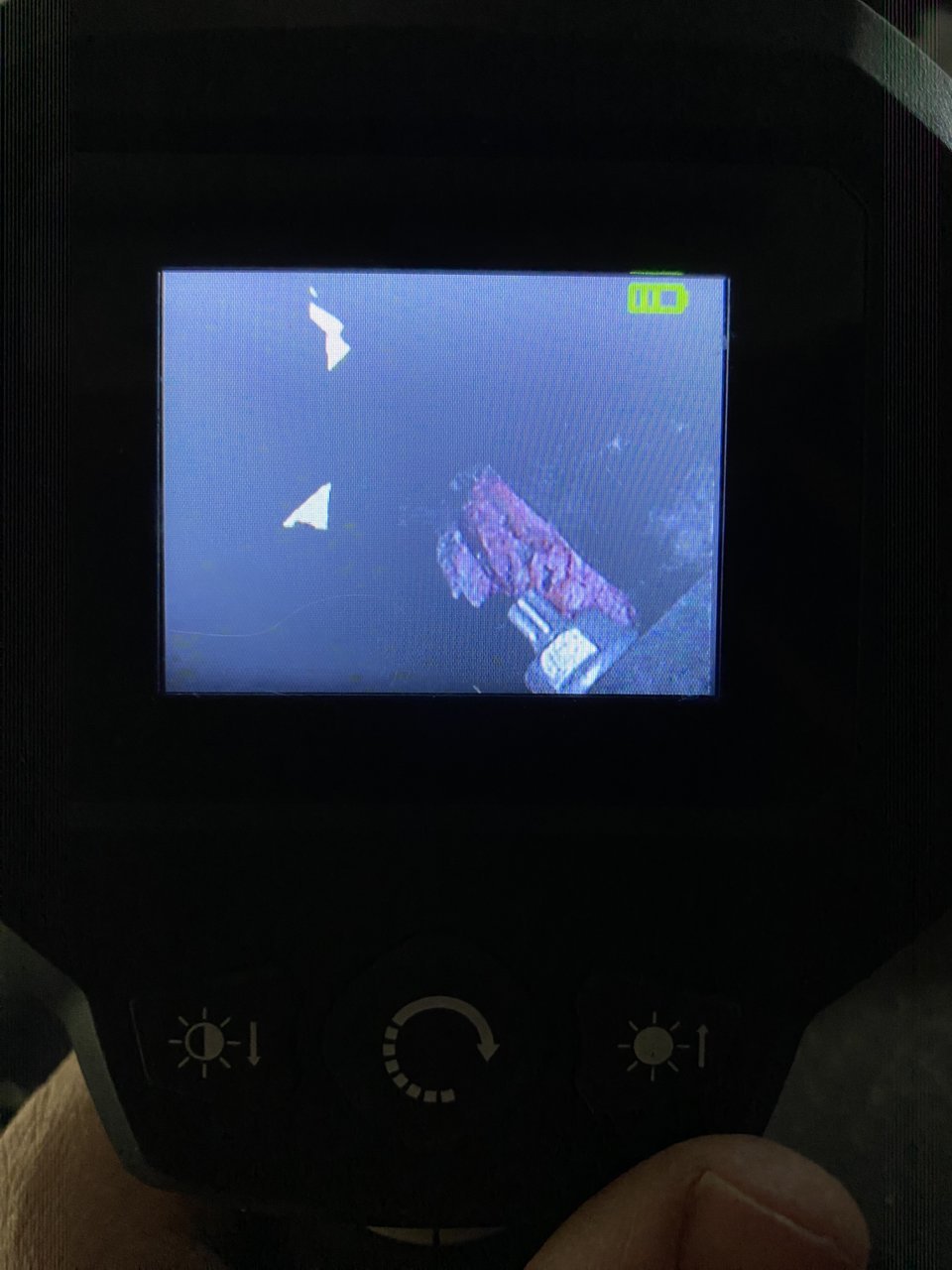

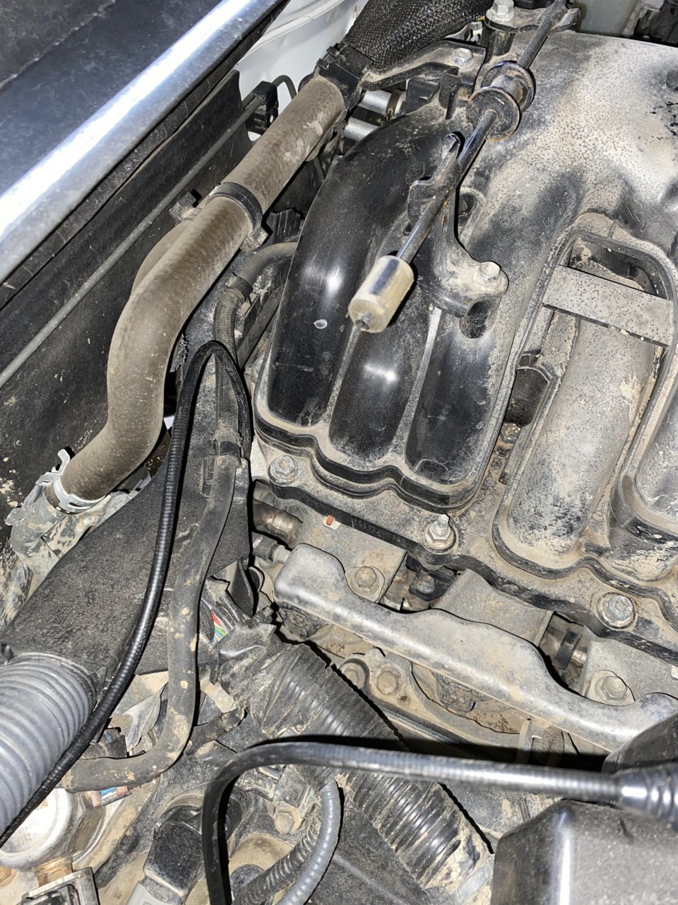

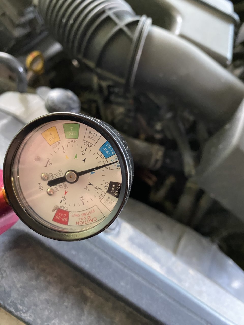

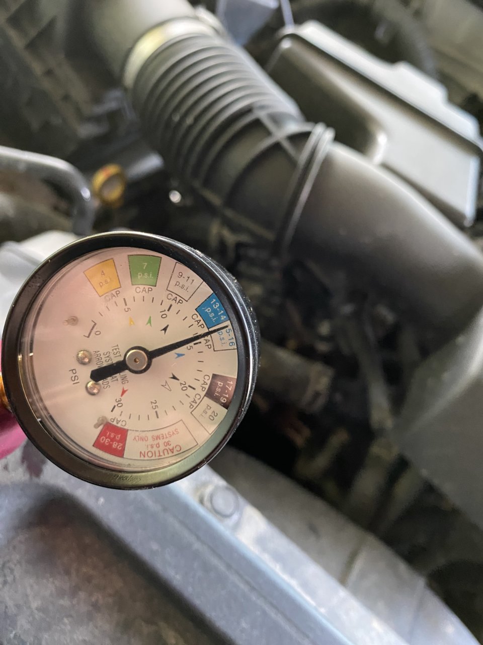

    2016 TRDOR coming up on 140k. I noticed symptoms of low coolant on Friday and got around to doing some checking today. IMO it looks like mine is cracked at the passenger side cylinder bank but let me know if you think otherwise.
    2 minute radiator pressure test showed a .5-1 psi drop. A44A768A-3ADA-4642-825D-589F8C2F4BF7.jpg2343619F-7171-4FD7-B3F1-134BB3A4A4F0.jpg
    Dropped the skid plate to look for leaks but didn’t see much.
    Put the borescope down as shown here BC55008B-8AEB-41ED-BEDF-FA8283CE3DD4.jpg
    Inlet flange
    What does everyone think? For sure cracked? How much have people been paying to get this repaired?
