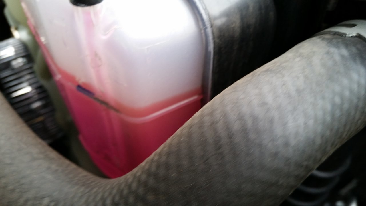

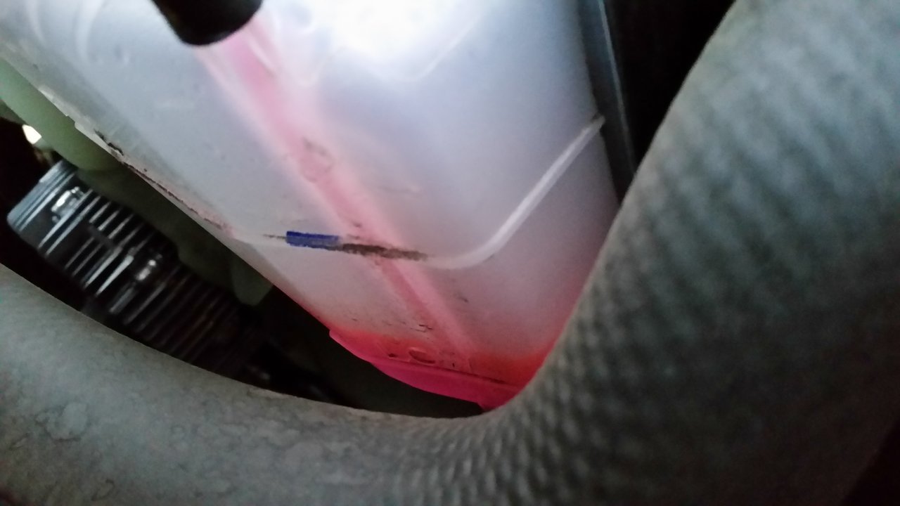

    I understand mine was within the acceptable range; I've just never had a vehicle use that much coolant in 21,000 miles. Mine started out life 1/4" below the full mark-cold.
    Note: First pic I posted was cold; second pic was hot
    Oh well...I'll get around to scoping it this weekend.

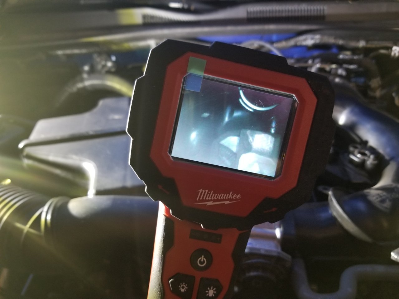

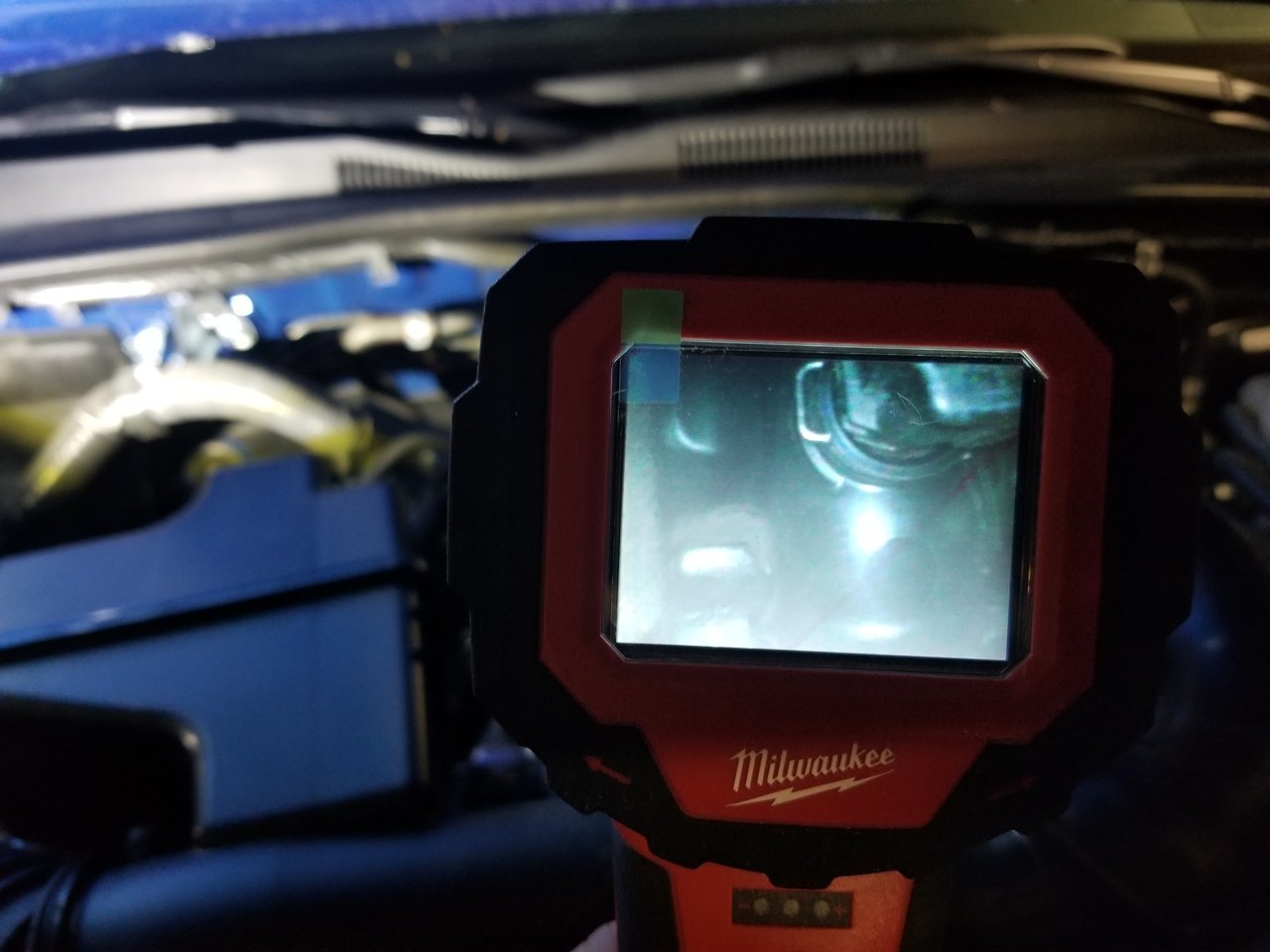

    As long as you aren't iOS or anything running AOS Nougat or Oreo... I have a GN8 running Nougat. That solution wouldn't work in my case unless I bought a cheap unlocked handset running KitKat- Marshmallow... Then I'm almost back to the price of the dedicated scope. Still a good budget option for anyone with an older phone.
  19. Feb 1, 2018 at 8:04 AM
    #39
    tonered
    tonered bartheloni
    Sep 25, 2017
    #231055
    31,200
    tony
    Lynnwood, WA
    Good info.
    I haven't tried this particular one with my Pixel since I still have my old Note3 from when I bought the scope.
    Also, there were iOS (lighting cable) versions of this when I bought it. The rest of my Fam are on iOS but were stealing my phone to use the scope.
