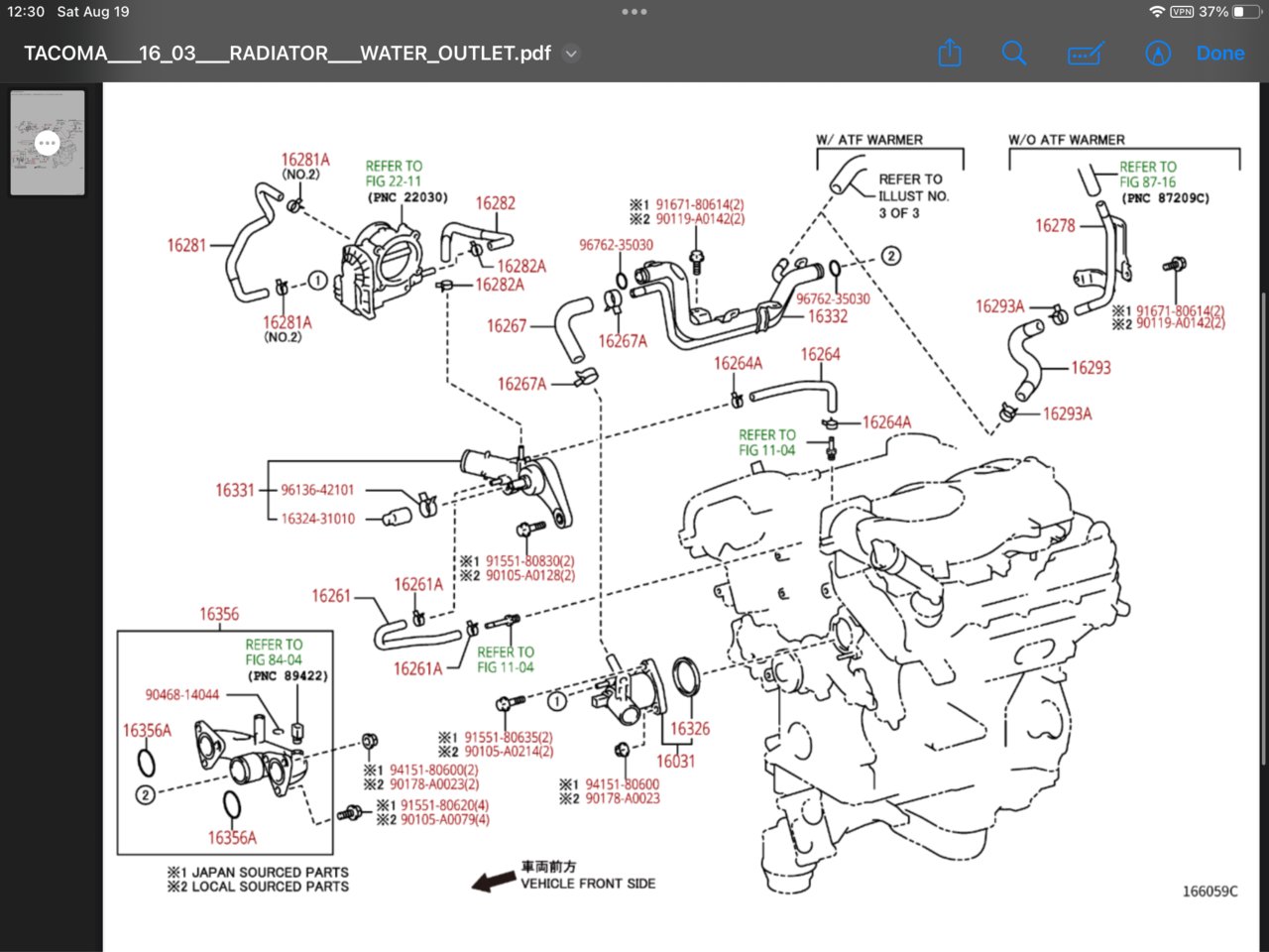

    Here’s the schematic… impossible to find this online but the dealer sent it to me. $122 from the dealer and will have it in 2 days.
    now off to harbor freight for a tranny jack for $129 and were all set.

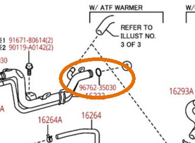

    Here is the O-ring on the pipe going into the center of the by-pass joint, I would replace that, too.

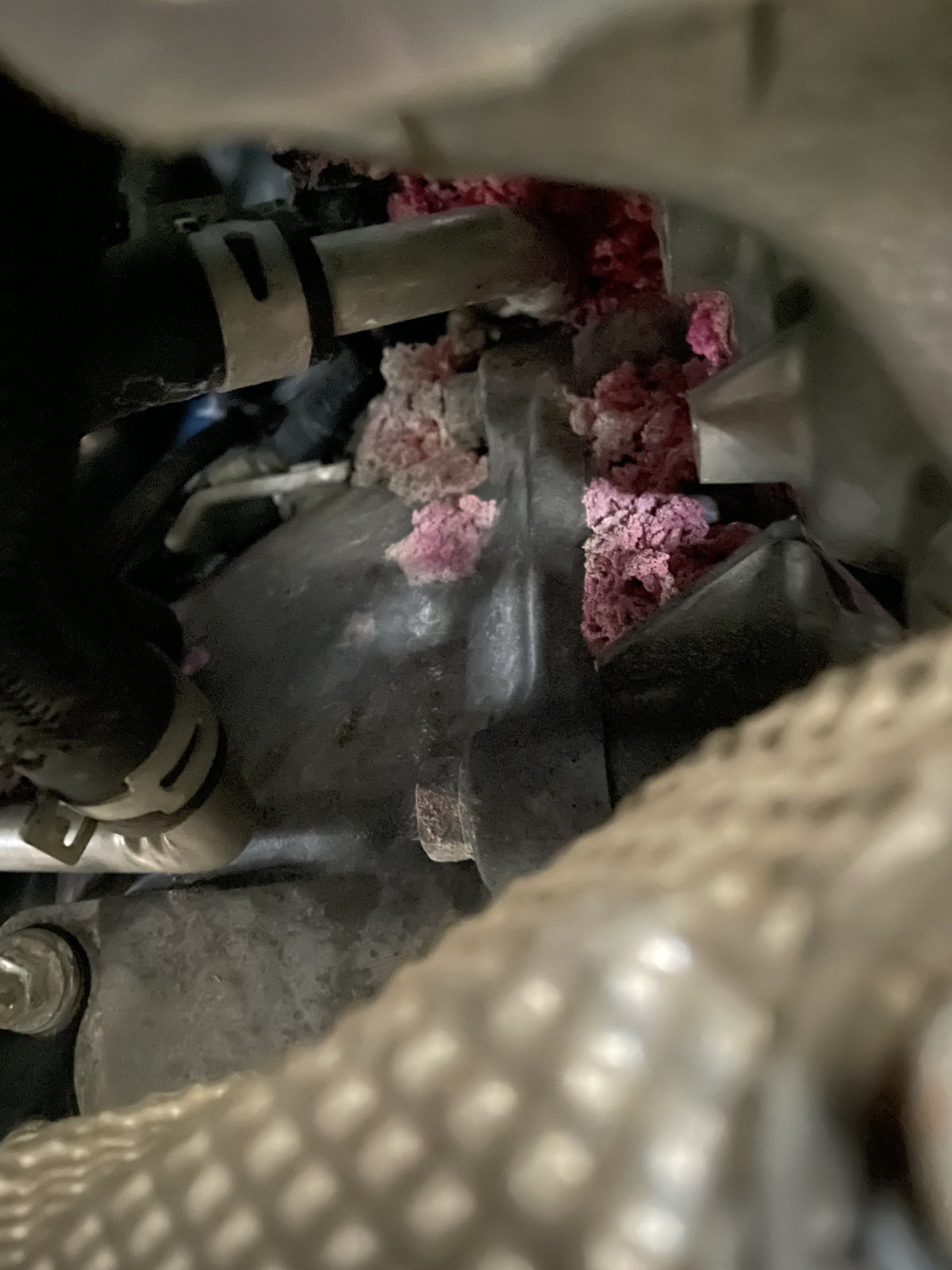

    Happened to be under my truck looking at something else and saw the pink buildup on the back of my motor. Took it into the dealership so they could check it out... Over $2,600 to fix! They have to drop the trans! 2016 Taco with 49,000 miles! Out of warranty... F$#K!
    Haven't had it fixed yet... Found this thread after the fact. Opened a claim with Toyota...

    My dealership says they have to drop the trans! $2600!

    I would get a second opinion on the quote. Mine cracked at 52k on my 2018 and the dealer removed the intake manifold and replaced from the top. this was a few years ago and pricing was around $1,500. Also, FYI, they would not replace this under the powertrain warranty which was still in effect at the time.

    The official Toyota repair method is to lift the cab from the frame, which makes a lot sense. 13.5 hours of labor.
    Dropping the tranny is a shortcut, but the coolant bypass is still partially blocked. But a good tech can drop the tranny in less than couple hours with proper shop equipment, without breaking the AC lines.
