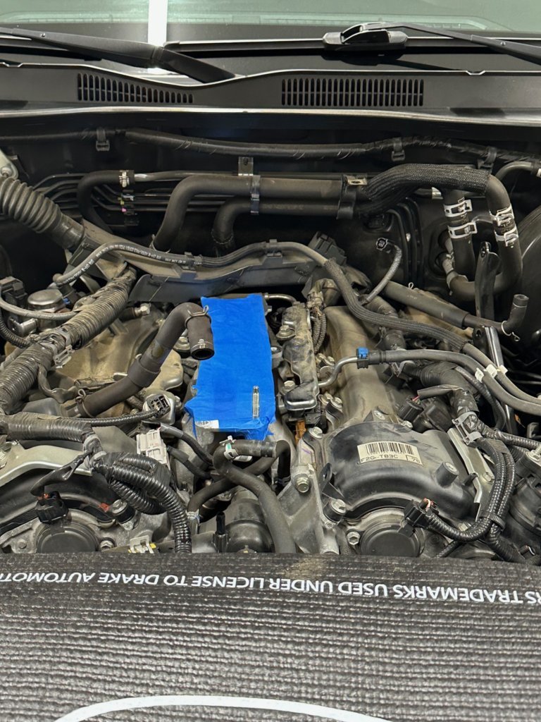

    I did mine at 58K by removing the upper intake manifold or what is called the "intake surge tank". I did not disturb the injectors or fuel rails. What made it easier was a topside creeper. I also loosened up the front exhaust pipes and removed the trans mount bolts at the crossmember and stuck a jack under the tranny and jacked up the rear of the tranny about an inch which gave me more room to get my hands in there. Took me about 6 hours taking my time. Also changed my plugs while I had it apart.

  19. Aug 31, 2024 at 1:05 PM
    #419
    willtill
    willtill Well-Known Member
    Nov 18, 2007
    #3502
    760
    Maryland
    2018 Cement Off Road V6 Access cab
    That plastic housing that the wiring looms run through at the rear of the engine, looks like a real PITA to negotiate.
  20. Aug 31, 2024 at 1:12 PM
    #420
    99Mike
    99Mike Well-Known Member
    Jan 17, 2018
    #241488
    84
    Fayetteville, NC
    2018 SR5 DCSB
    It is. I was able to loosen it up a little to get more room.
