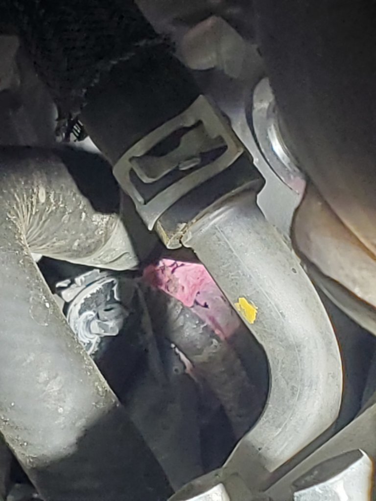

    Adding another data point here.
    2018 Tacoma. Built April 2018. 90k miles. Canadian truck.
    I haven't noticed any substantial drop in my coolant levels (unless Toyota has been topping it off during my service visits?)
    How much time do I have before I have to replace it? Will this pipe let go without warning?

    Yes, I think all reports have been slow leakers. Coolant level will be the first indicator then the visual confirmation. No catastrophic failures to date as far as I know. 1.8 million of these made and they have not become the norm thankfully.

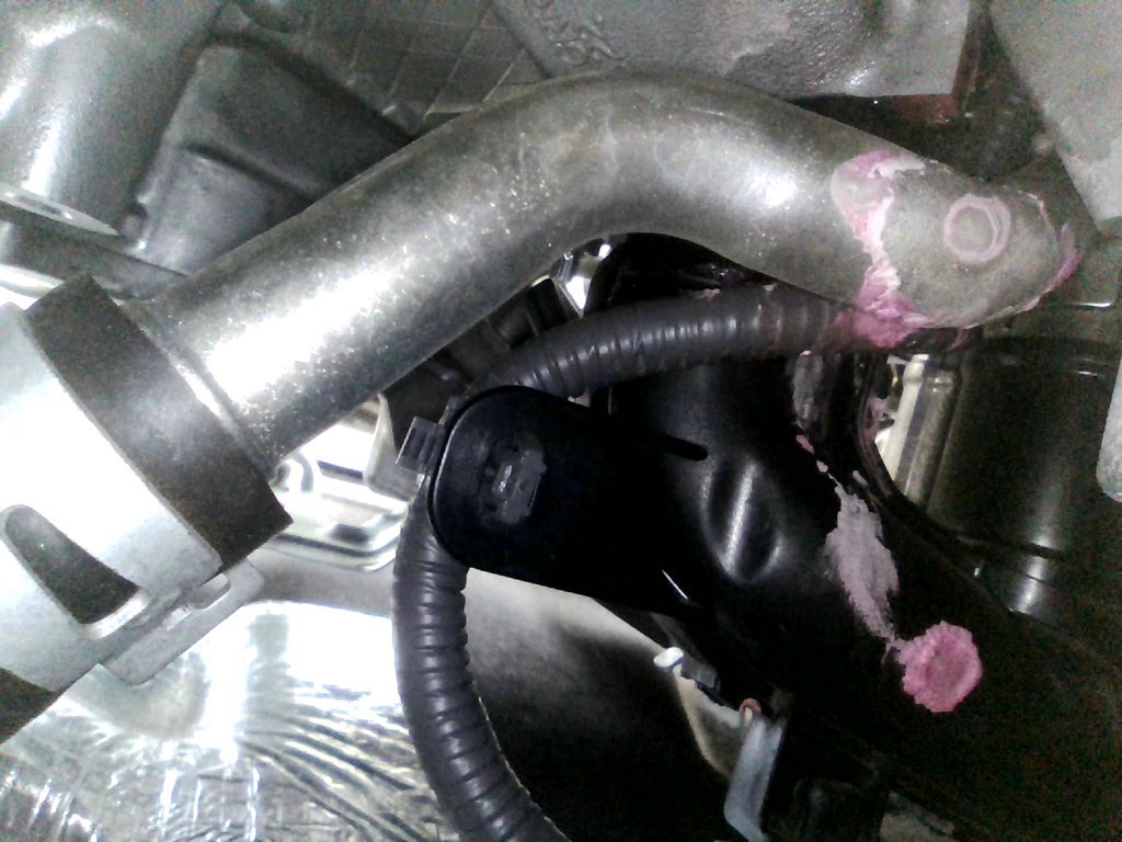

    Add me to the list. It's not just '16s and '17s, it just happened to my '21 at 34K. I noticed a small collant puddle underneath the trans on Friday night and got my endoscope out and sure enough, it's the bypass line. I bought a 100K/10 yr. factory VSA warranty from Wolverine Toyota a few years ago though (for $1360 IIRC). I think there's a different dealership that people go through now to get the best deal on these factory extended warranties, but I am SURE GLAD I bought it when I had the chance because my local dealer (Toyota of Redlands) approved the repair without any trouble at all. Gotta give them a shout out because they have been a great service dept. for years now, for both our 4runner and Tacoma.
    You guys with '22s and '23s that are still within the regular factory 36K/3 yr. can still purchase a factory extended warranty from any dealership until your regular warranty runs out. I got mine from out of state because they were less than half the price the dealership I bought it from was "willing to do on it". I had to have my thermostat replaced under warranty about a year ago because it was stuck open and the truck wouldn't get up to temp unless I drove it for almost 30 min. So between that and the bypass line, this VSA saved me probably $3K+ so far, with 5 1/2 more years to go. Something to consider...

    Did they let you know which way they were going to replace it? Transmission removal or intake manifold to access it.
    thomasburk and JmsWms like this.

    Good question. @brian2sun And congrats on the coverage, and nice pic you got a good endoscope. Not a happy sight but glad you got the solution.
    brian2sun likes this.

    They called to tell me they couldn't quite get it done before quittin' time tonight, but it'll be ready tomorrow. The tech said he removed the manifold to do it, but said he's done it both ways and neither one is much fun, haha.
