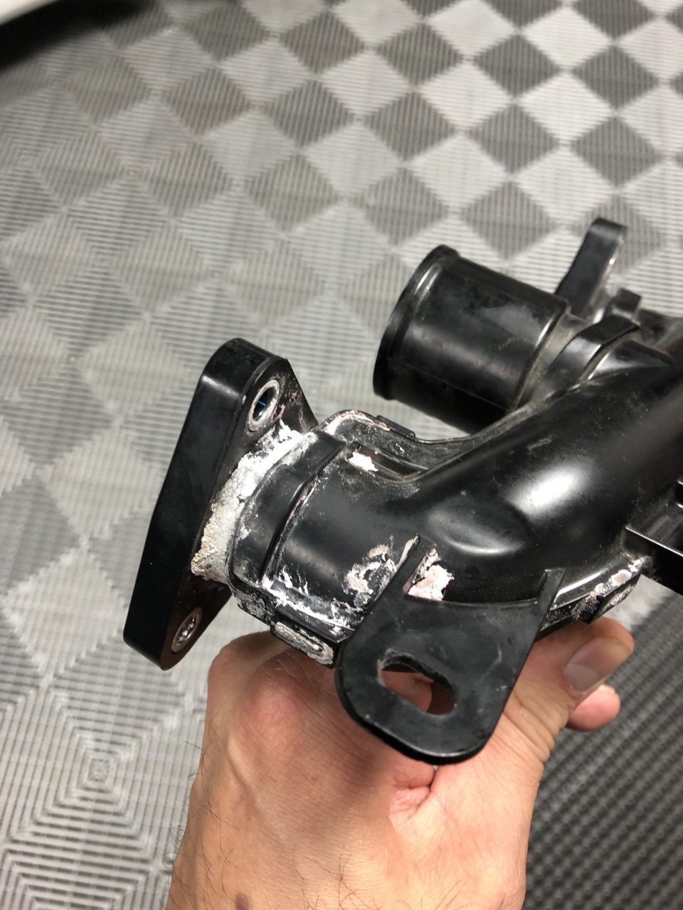

    63F4AFD2-ED4A-42F0-9023-6406C613AFCD.jpg 63F4AFD2-ED4A-42F0-9023-6406C613AFCD.jpg I had to have mine replaced as well and it cost me around $850 or so to have it replaced.

    Nice garage floor. Is that dealer pricing? Any idea on their process?

    Yes I did have that done at the dealership. They wanted $900 something but the little complaining I did brought it down $100 or so down. They had to replace the intake gaskets as well. I asked them for the parts which they did give me.

    To add to the VW info... In the 90's, when VW began the move to plastic water pipes. They we're inadequately designed, just like the Taco, and they cracked. Someone coined the term "crack pipe", and it stuck. Aluminum replacement were produced.

    I had to change the crackpipe on MY BILs GTI years ago. What a pain in the ass.

    So they had to pull the plenum eh?

    Are they replacing these with the same exact part? Hopefully they've updated the design
