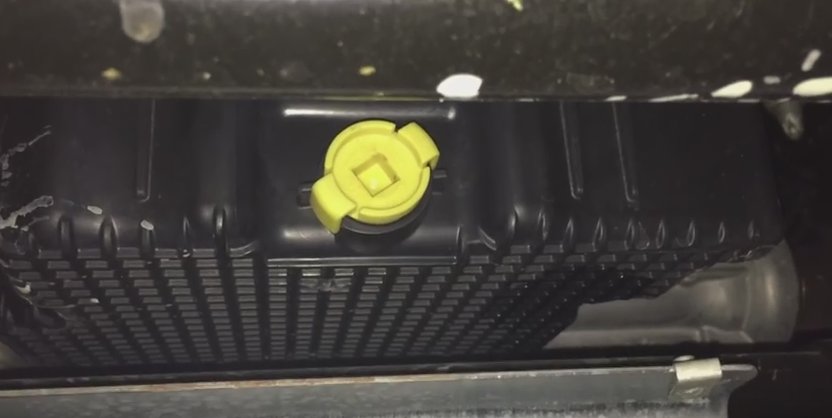

    My daughters boyfriend has a 18-19 F150.. She brought it by the house last summer for me to change the oil. He works the night shift and was asleep, so she wanted it done before they took off on a road trip.
    I had the WTF look when I seen it. Hell, the drain plug is composite as well, And toolless at that. I just needed an oil filter wrench for a complete oil change. By the way... that 5.0 holds 8.8 quarts. Was glad I used the big pan to catch it all.
    TacoBuffet likes this.

    Toolless eh? Composite drain bolt? How'd ya remove? Pretty interesting

    It’s a twisty with two fingers. Squeeze the tabs and turn.
    sample pic. His is a little different.
    shakerhood and whatstcp like this.
  10. Jan 26, 2020 at 8:11 PM
    #110
    Skydvrr
    Skydvrr IG: @kalopsianick
    Sep 13, 2017
    #229889
    12,654
    Nick
    YMH
    Black '17 OR
    That fuckin blows my mind man! Not that I think it's unreliable, it's just such a departure from what I'm used to. That's awesome
