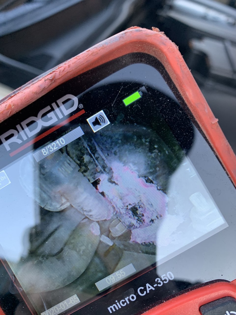

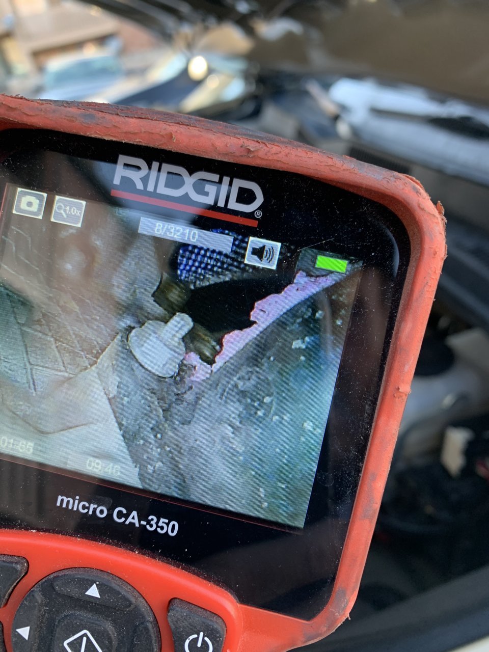

    where are you putting in the scope? I couldnt see shit but I dont know if im in the right spot.

    found it first from the driver side, but it’s easier From the passenger side. Back left of the engine maybe 8-10” down. I actually could see it when I was standing on a stool looking down into that section without the camera too.

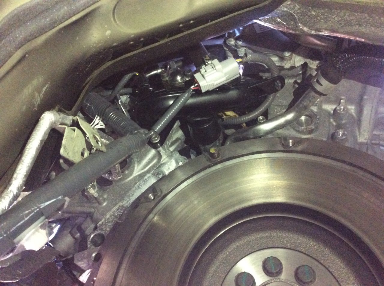

    you definitely don’t need to pull injectors, I work at Toyota, first guy in our shop to see/do one. I didn’t even remove the intake manifold (should have) took me a few hours and scratched arms but it’s not that bad.

    If I end up doing another I will remove intake manifold but leave all the injectors/etc in place. It’s a tight fit but def. possible with some patience

    I noticed the coolant expansion tank nearly empty during a multi point inspection (customer had no idea or any overheating issues) when I had the truck up on the lift I could see the dried up pink coolant had ran down the passenger side of transmission. Just followed the trail up to that bypass. Replaced it and haven’t seen it since. Of all the Tacoma’s that come thru the shop I’ve seen a total of 3 leak. Not very common in my personal experience

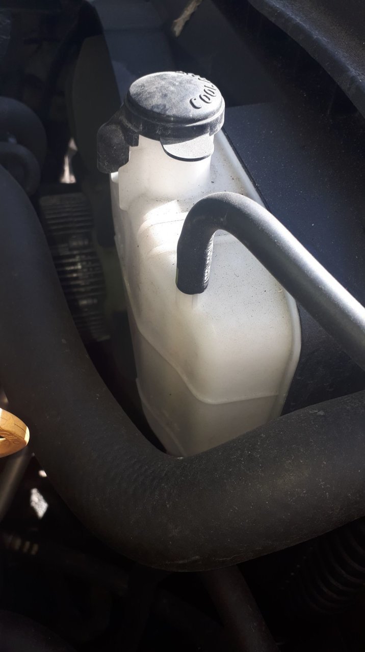

    2018 SR5, 34000km (21000 miles). Was doing checks today and noticed both my coolant reservoir and rad were bone dry... wtf! Started looking around the engine down past the manifolds and can see some areas where there is caked on white/pink crystal residue (see example below). Looks like a coolant leak that is burning off.
    Dealer will be looking at it Friday. I am guessing it is the passthrough pipe. Surprisingly no overheating or signs of stuff not working, must of been just enough left in the system that it was not showing as a problem yet. I have no idea how long I had been driving around like that. Topped the coolant off for now to hopefully last me the week.
