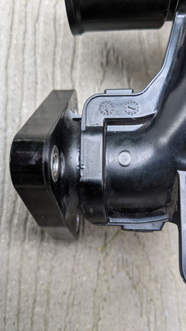

    Here's another one. 2017 - 42k miles. Spotted coolant drips at the rear of the engine. Dealer replaced it but not under warranty. They claimed it was the first one they had seen, suggested opening a case with Toyota. Said it was "worth a try". Replaced with Part #16356-31051. Photo shows the area of the leak, right at the seam. PXL_20210114_233229618.jpg

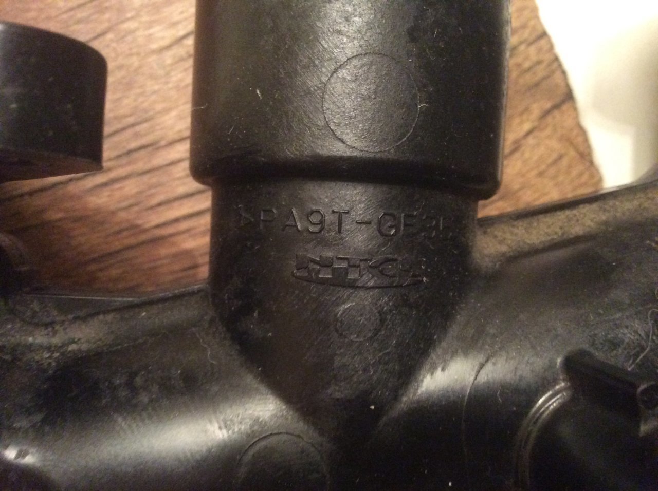

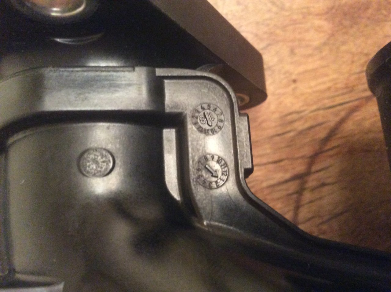

    Here is the non-leaking unit from my 2019. No idea if it's the updated piece.
    Production date.
    Manufactured by NTCL/Nippon Thermostat Co. Ltd. Longtime Toyota Supplier. Material is PA9T GF35.
