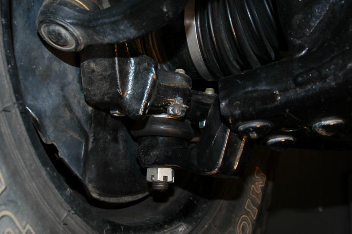

    Too many folks come away from this kind of thing feeling that OEM is the only way to go and everything else is junk. There is no doubt OEM is tops and the only "junk" is the Chinese bastard joints. The aftermarket 555 joints simply don't last as long as OEM and have the unfinished mount issue. On the other hand they are significantly less expensive. They are plenty strong and are not going to "just fail" out of the blue. Plenty of folks beat on them plenty hard.
    Longevity vs price is really the bottom line. The increased potential for the mount bolts to loosen can be mitigated by proper use of a thread locker and putting a dab of thick paint across the bolt heads and the body of the joint as a "tell tale". At a glance you can see if the bolt is backing out.
    Below I used a dab of "JB Weld" brand epoxy as a tell tale and that's with OEM joints and new bolts. I recommend a tell tale and thread locker regardless of the joint brand.
