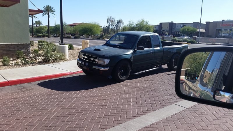

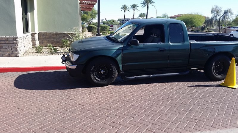

    Another one bites the dust. Seen this little Taco down the street from my house.

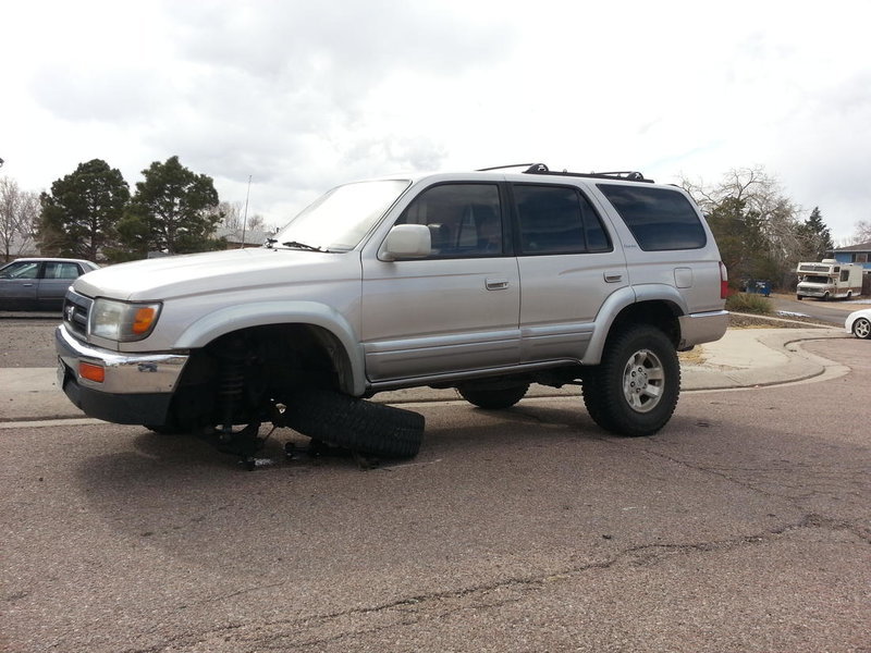

    The 555 sankei were inspected after 10k miles on the 4runner forum and the ball had major scarring. This will wear the joint till it fails.
    The 555s are pretty pricey also. Might as well go OEM.
    When my joint failed it took out UBJ, tie rods, steering rack, cv, tire and brake line.
