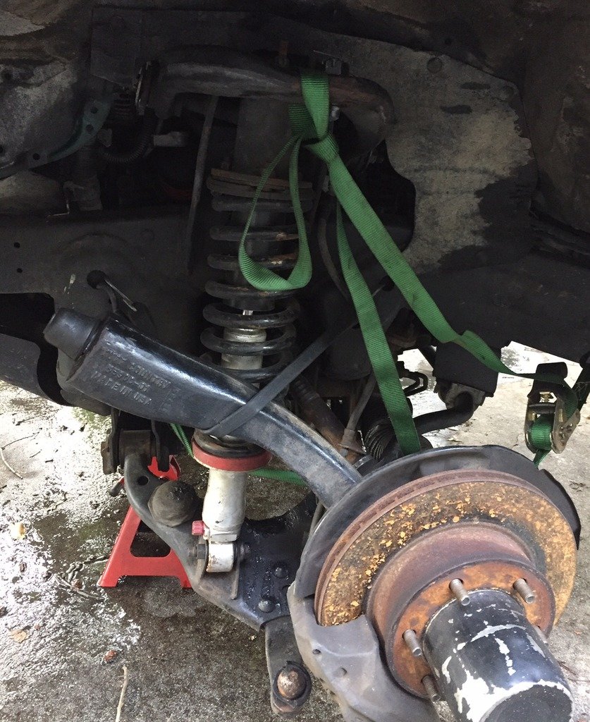

    Its been upper ball joints. The last incident blew up the lower as well, But I think it was the upper failing. The upper is sheared off. I can post pics. I'm really new to this forum and forums in general.

    Its been uppers and twice. The first failure and rebuild led me to buy the Moog's and take the torque spec seriously. I just don't have a clue whats going on all of the sudden. Speculation from a guy who works in packaging is that it has to be something to do with redoing the shocks and coil springs. I just cannot see how that would be snapping the ball joints though. Its very expensive each time it happens and I have been lucky that no other vehicles have been involved and I have been uninjured. I think I'll reach out the lift kit company. I'm going to attempt to load some pics up soon.

    This is the aftermath of the ball joint
    Yes . Looks stock to me.

    Thanks. Still not sure if I'm getting it rite. There is a shop in town that installs lifts and I think I'll give them a call and see if they will give an opinion. I dont think I'll see this kind of "Luck" 3 times.

    That is a huge ass spacer on top of the coilover. And the spindle doesn't look OEM. Is that a drop bracket lift?

    Has to be a DB with that big of a spacer. i think we found your problem.

    Well.......I mean it says it right there on the spindle
    "TUFF COUNTRY
    XXX-XX
    MADE IN USA
    Would be this kit
    http://www.tuffcountry.com/lift-kits/toyota/tacoma/
    EDIT: says lifetime guarantee, maybe you should call them and tell them you were scared for your life when the pussy balljoint snapped.
