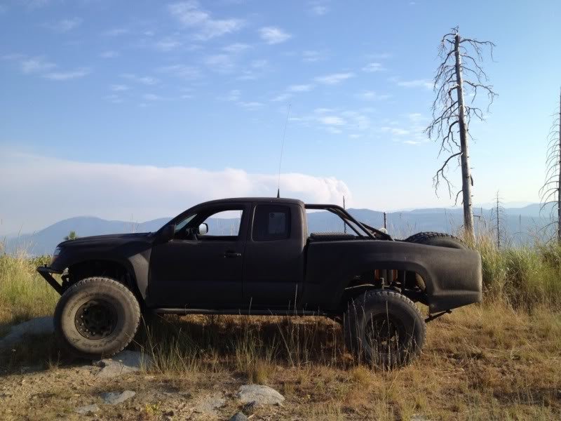

    I figured out how to fix this problem. Fuel door eliminator mod-

    If Toyota wants to pick up the tab to provide me with this solution, I will gladly accept! That is one awesome truck!

    They will if you figure out how to get into their race program. Know anyone who knows Ivan Stewart? :D

    Ha, I wish!
