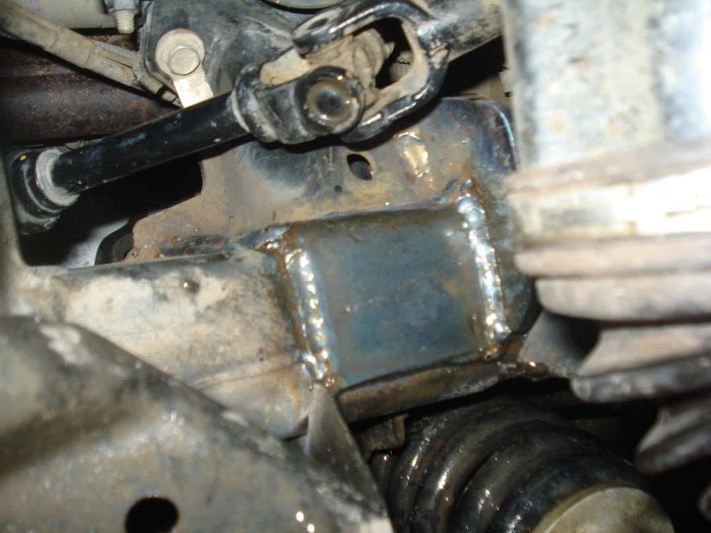

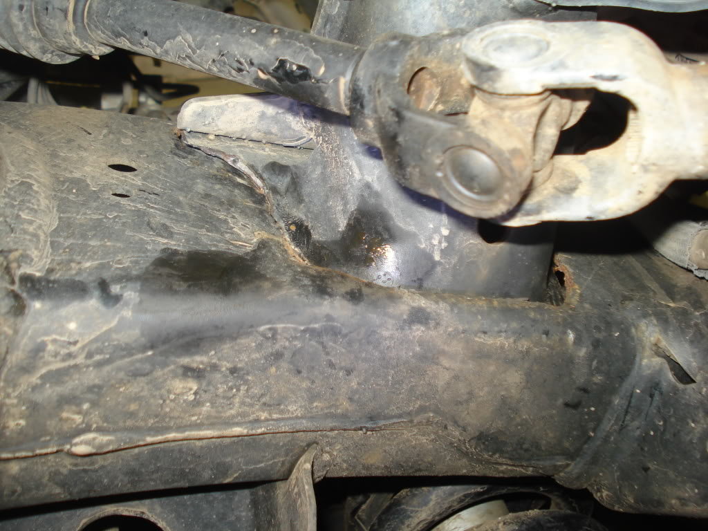

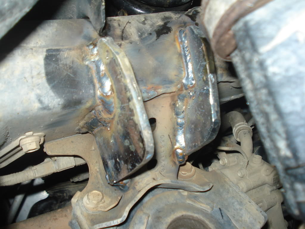

    its associated with the 4.0L/V6 related. If you have a 4cyl I wouldnt really be worried, but still keep and eye on them. Here are my mounts before they failed and after I got them fixed. Also im only picturing the passenger side after it was fixed. My passenger side had a big crack in the weld but hadnt collapsed yet.
    Before:
    After:
    Passengers Side After:
