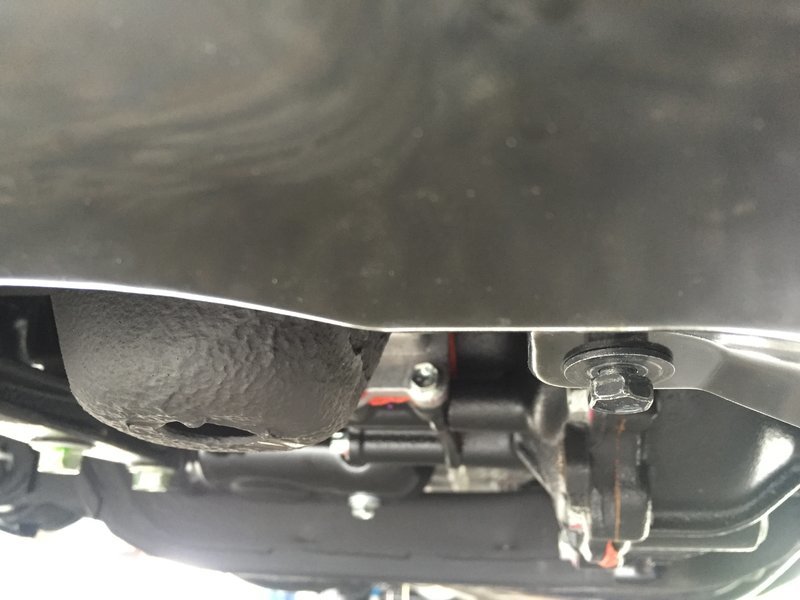

    February built Texas truck, checked mine (u-bolts), torque is forsure 52 ft-lbs. Didn't exceed it to see how much required to actually turn nut.
    My skid plate though was a different story as you can see. (And what I'm not posting is the fact one bolt is missing)
    Serves me right for over paying on the undercoat from the dealership...
    Day two of ownership, going to be a fun day Tuesday when I go to pick up my rubber bed mat!

    Try again after about 500 miles; gives the springs a chance to settle in.
