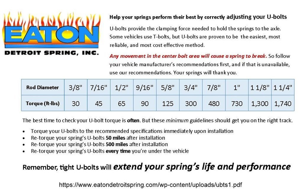

    So to confirm, the U-bolts should be tightened to double the factory recommendation? I have zero experience in this area?

    I wouldn't double but definitely can do more than factory spec. 50% more will be good

    I don't know the current factory recommendation...

    some and more and more and more and
    And what Dia. are ours?

    14mm.

    I can see were you came up with 75 according to the chart. That just seems like a long way away from 37 though

    And I would argue 37 is a long way from correct...Toyota is not infallible.
    Anyway, that's why I provided a link to 4WD's thread on the subject...
    Do some reading and come to your own conclusion.:)
