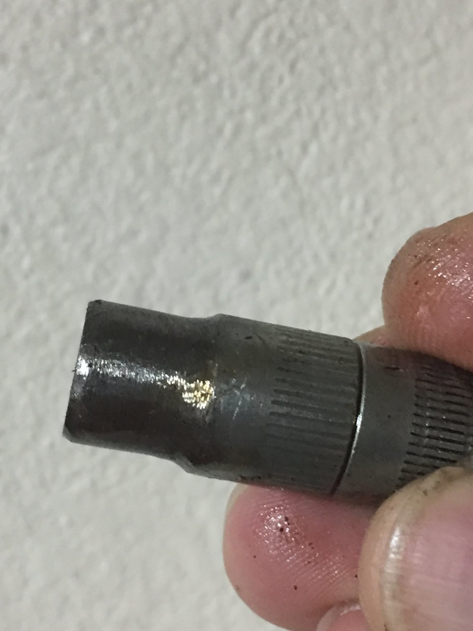

    It's custom, you gotta grind until yours fits, and works for you. For some reason, my photo won't load. I'll try again after a while.
    Okay, had to synch my phone to transfer photos. This is what works well for me and gives me clearance. Too bad that there doesn't seem to be a readily available slim snout grease gun and you have to make your own. One of the other things I do is splice in a flexible hose instead of the rigid pipe that comes on most guns.......also, on the U joints I use a mini gun, the kind that holds 3 oz cartridges. Guess that's enuff "how I do it" for now.
