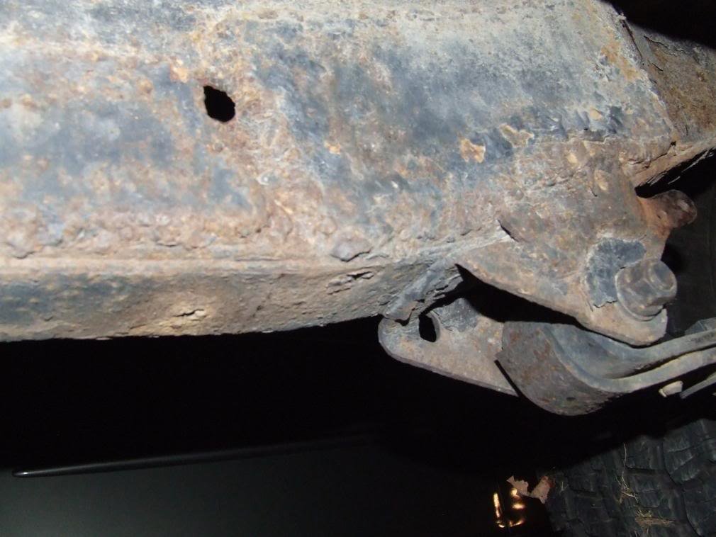

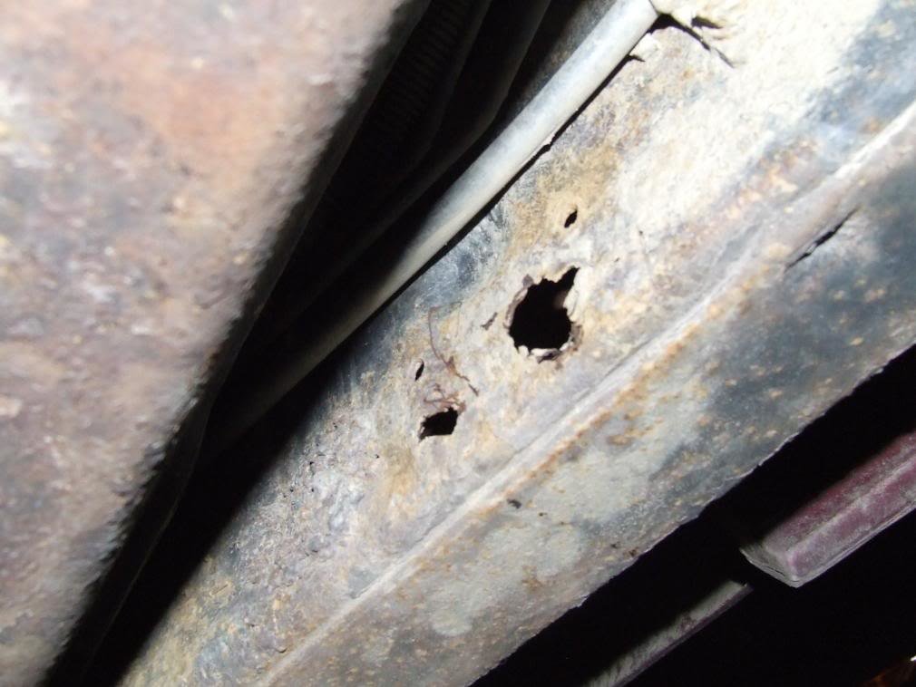

    well i have an appointment on monday to have the dealer look at my frame. I was wondering if you guys could tell me if it sounds like it will qualify? I scraped some rather thick (1/4 inch) flakes off the top of the frame behind the rear wheel. there is no perforation of the frame but it is very rusty looking and pitted. Also i did a comparison to my wifes '95 pathfinder and its frame is nice and smooth and still black! and its 2 years older! Anyhoo, just wanting to know what to expect, thanks for any insight:thumbsup:

    Put up some pics so we can see how bad. It sounds like a bad one...

    If you can poke through the frame it will fail. The tech is going to hit it with a ball peen hammer. Also, check the cross member that runs from the frame to the tire carrier.

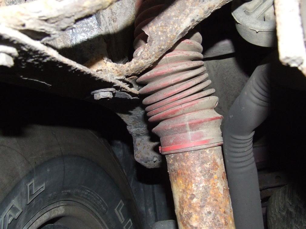

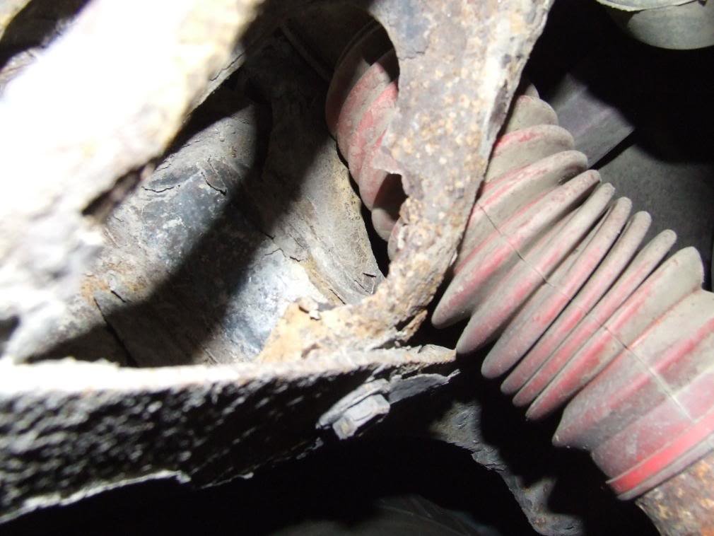

    Pic #3 is questionable IMO or probably will be a problem before long. A half hour with a wire brush and a rattle can every couple of months will eliminate 99% of that. Where are you located?

    Yeah, that appears like it will pass with flying colors based on those four pics.

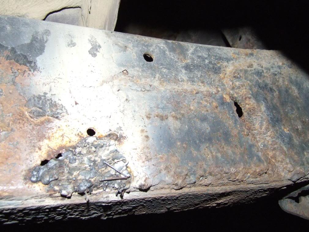

    Here is what a failure will look like
    ^^Cross member that goes to tire carrier
    Snotty weld job to fill the hole
    Opps! Missed a hole
    Another crossmember pic
    These are steel plates I welded over the previous holes.
    Mine was a 98. I started patching my frame in 2005. Well before any buyback.

    when you say pass do you mean it will qualify for the buy back or its not bad?

    Pass the inspection as it won't qualify for the buyback. Fail = buyback. But that is only based on those pics. They inspect the entire frame. The tech will have a drawing of the frame where he will highlight the bad spots. He pretty much circle the paper when mine was inspected.
