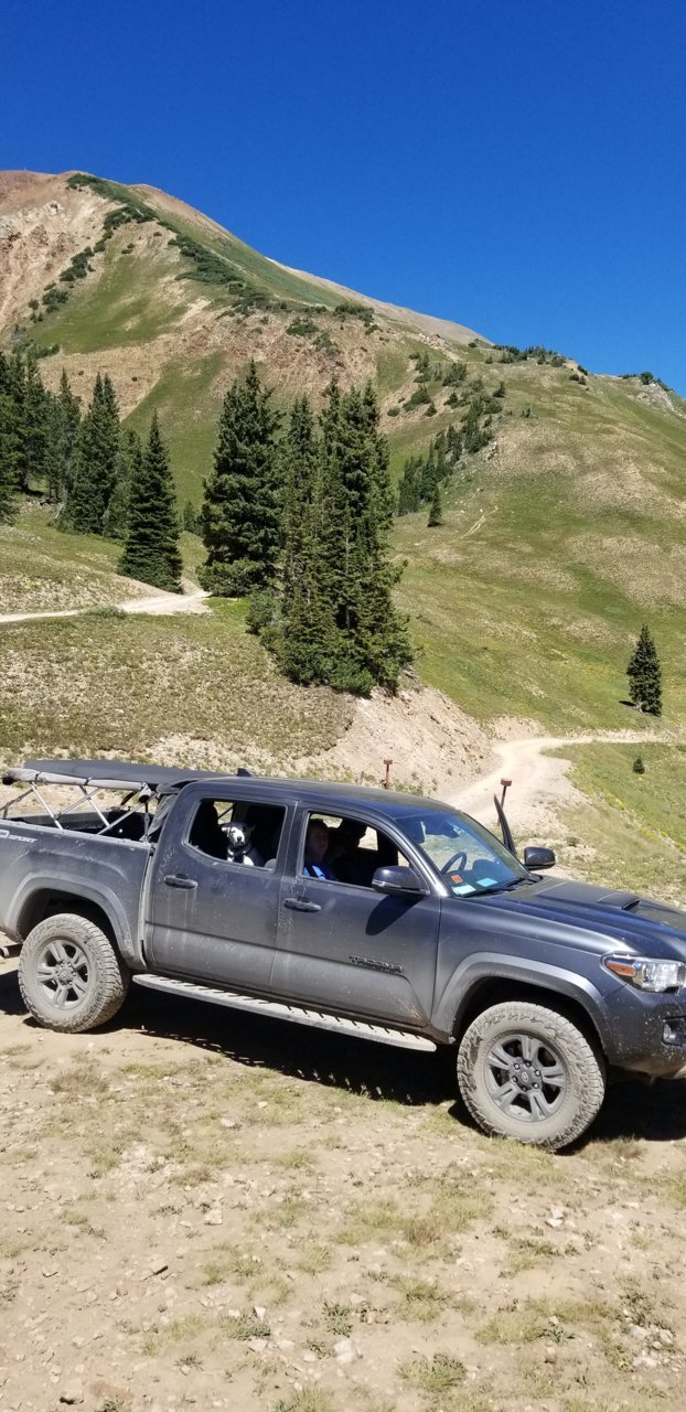

    Yule Pass, before I got into the brush. The dust on the truck just ground in those branch marks.

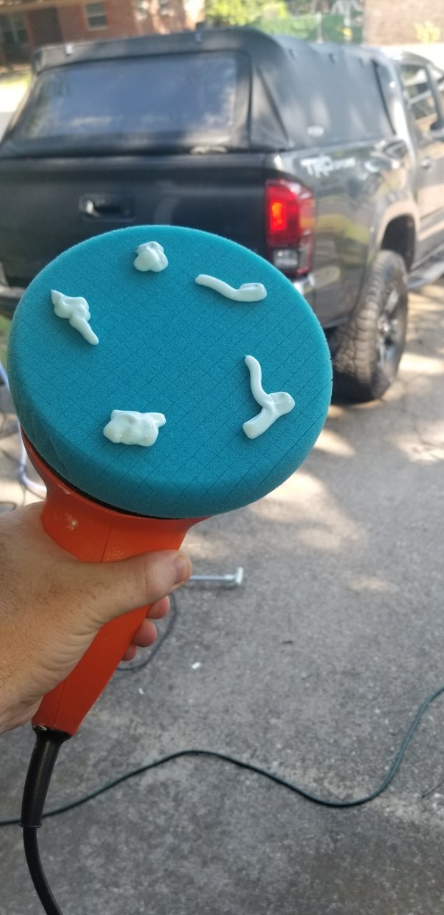

    Three passes with V34 polishing compound, followed by three to four applications of VSS scratch and swirl remover, then another wash, a clay bar, and finally a ceramic wax.
    30 bucks for the cheapest buffer on Amazon, 20 bucks for a decent set of sponge pads, 5 bucks to attach said pads, and about 18 bucks per bottle. So I'm all in at roughly 115-120 bucks at this point.

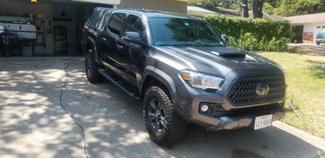

    She's looking like a mall queen once again.
    Any skepticism I had, I don't have it any more. I'm definitely on the chemical guys fan bandwagon now. They make a solid product :thumbsup:.

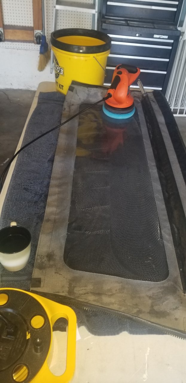

    Any experience with soft tops, by chance? I already have a couple bottles of 303 for the canvas, but need to repair some scratches and light haze in the vinyl windows. Was looking into Meguiars PlastX. Is there something better?

    What a coincidence, I just bought a softopper 3 days ago!
    As for the light scratch and haze in the vinyl window, I believe they're actually closer to a rubber than a plastic, so unfortunately you're most likely better off just replacing them. I would stick to 303 if you have it, but if you're willing to shell out a little bit of money, Wolfgang's is the best for trim and vinyl (In my opinion).
    Theoretically, you could remove the windows, tighten them very flat and secure on a flat surface, take a da polisher (like you did) and maybe try a very light polishing compound on them? I can only speculate, but that might be worth a shot before replacing them!

    Haha, already spent this morning doing exactly that. A thorough sponge rinse to knock off the dust, a couple hours polishing each panel, reattach to the topper and microfiber any residue. They are definitely cleaner than they have been, I can see through them just fine, but they aren't "factory new" clean. I've been lurking on a couple of Jeep blogs to see what they do, someone recommended the Meguiars. Might as well give that a shot before dropping 70-80 bucks for a new panel.
