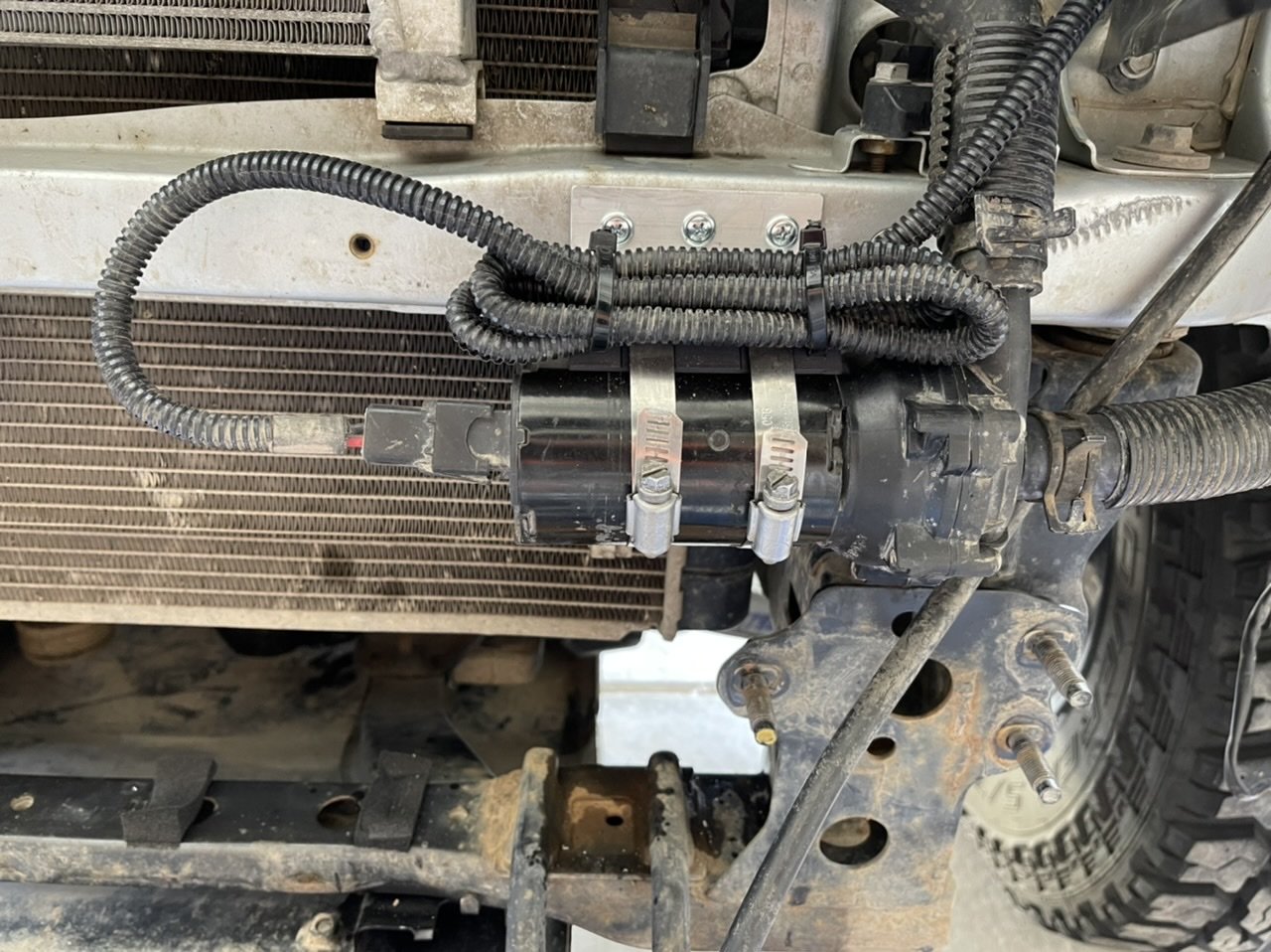

    During BAMF's Memorial Day 2021 sale I ordered a plate bumper because I wanted to change things up and also start preparing for larger tires. The bumper arrived in October 2021 and sat in my garage until it was powder coated in August 2022, and finally installed over the weekend.
    I ordered this bumper with custom cutouts for ARB's LED combo indicators, but that came with some of its own complications. First, the lights are designed to go into ARB's plastic inserts which have their own standoffs so the brackets do not allow for a flush mount installation.
    I could have just gotten some spacers and left it at that, but the lights also have a tendency to leak light out the edges of the clear lens, so I designed and 3D printed new housings in ASA plastic. Although it's not shown in the pic, the housing has gaps around the light to allow air to pass through for any cooling that may be needed and also to allow water to drain out.
    I also designed and 3D printed surrounds for the light cutouts so it wouldn't look weird having screws interrupting the surface of the bumper. These were also printed in ASA and sanded smooth and painted black.
    But the biggest issue that I wasn't aware of was the intercooler pump for the supercharger got in the way of the winch. There wasn't enough room to mount the pump behind its bracket, so again I designed and 3D printed a relocation bracket for the intercooler pump. The bracket also has integrated channels so I can zip tie the pump's power cable to it.
    Final installation of the pump relocate after the hoses are cut to length and wiring installed
    Now I just need to clean up the winch wiring and get a filler plate for the light bar cutout.
