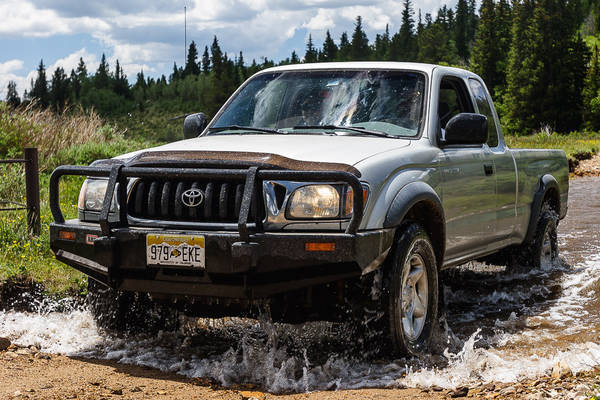

    On the trail:
    The day she left me:
    Turns out the shop that installed the lift kit didn’t torque the U-bolts enough, and I didn’t know what to look for or to check it after a week. Fortunately my attorney was in the truck with me when this accident happened and got all the insurance headache sorted out. Lessons learned, I was a lot more paranoid the second time around.

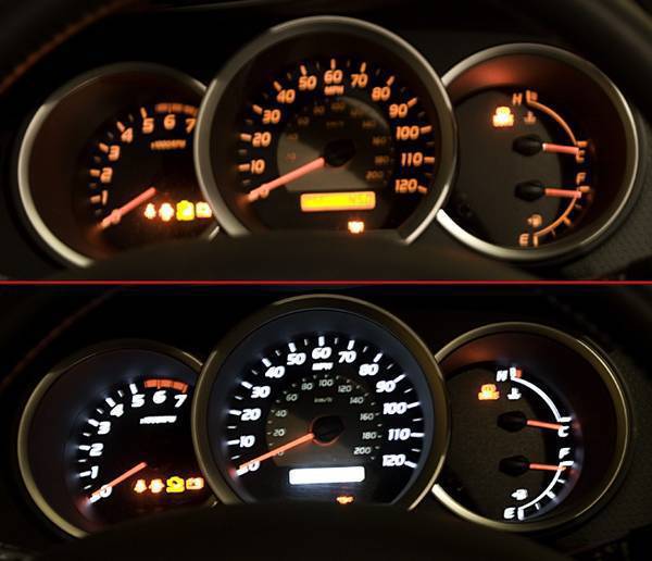

    The first mod I did by myself was changing the LEDs on the gauge cluster. I felt that the orange/red was a bit monochrome and outdated, and reminded me of my first gen. A simple swap from orange to white gauge numbers was all that I wanted. No need to go crazy with colors!

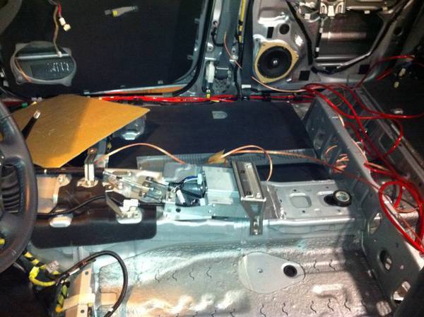

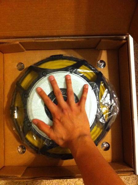

    Upgrading the audio system was the next major mod I did. My truck is my daily driver, and at the time I had a 30-minute commute each way to work in heavy traffic on a 2-lane road. The stock JBL system with satellite radio was ok, and I tolerated it until I had saved up enough money to build out a new and improved one.

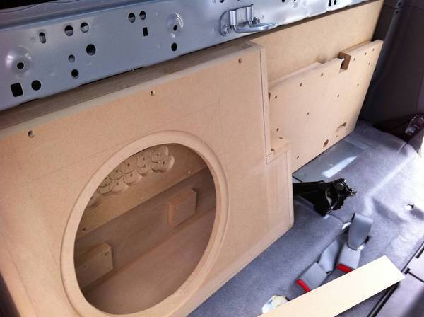

    The first order of business was to build the sub box and amp rack. I was sold on the JL Audio 13TW5 after going to a local shop and listening to it. It wasn’t until it arrived on my doorstep that I realized how huge the thing was.
    I pulled out the stock JBL sub and rear panels and, after a lot of measuring and cutting, built my custom sub box and amp rack out of ¾” MDF. I left two of the child seat safety anchors intact, just in case some day there is a little chenbro in the world.
    The spade bit drilled holes inside the sub box are a bit of a hack, but they were necessary to clear the spider on the JL 13TW5. The holes were sealed with silicone and the entire outside of the box was sprayed with Line-X for a little more strength, sealing, and aesthetics. Here is the entire assembly with subwoofer, amps, crossovers, and wiring:
    I did some sound deadening to the interior of the cab. I have some leftover material though so some day I might go back and add some more to the doors. You can see my DIY rear speaker baffle in this pic, as well as some of the wiring runs.
    Because the truck came with XM, I had a small XM antenna on the roof of the cab. I wasn’t going to need that anymore and decided to put the GPS antenna for the headunit in its place instead. This required removing the plastic housing from the aftermarket GPS antenna, but it did fit and works great.

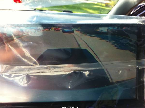

    The JBL system proved to be a little more challenging for wiring up the headunit, simply because not a lot was known about it at the time. Searching on TW I was able to figure it out, including getting imagery from the rear backup camera into the headunit.

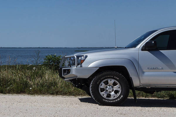

    Look at that stance! ARB with stock offroad suspension:
