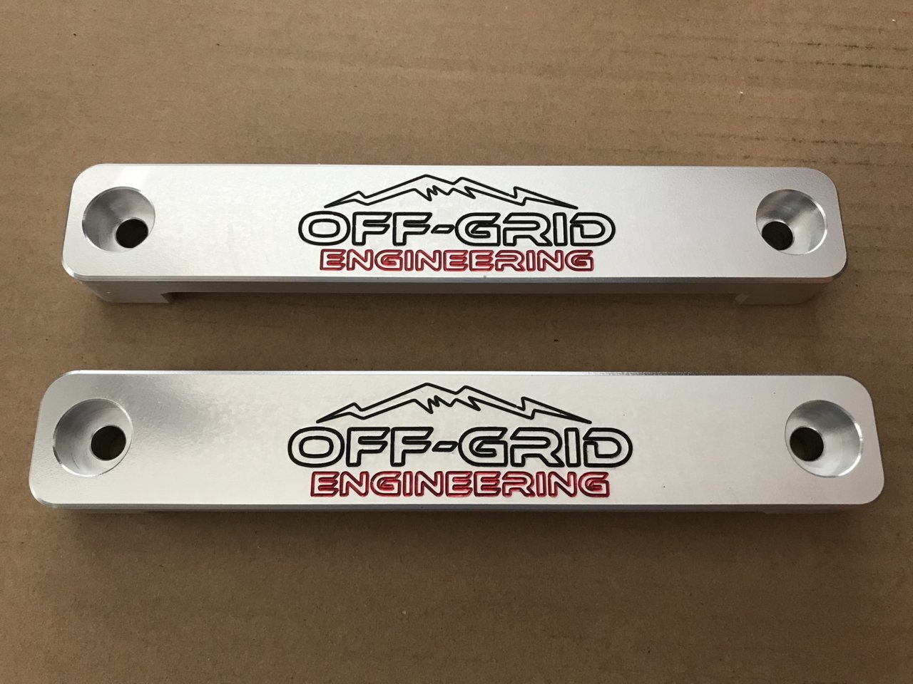

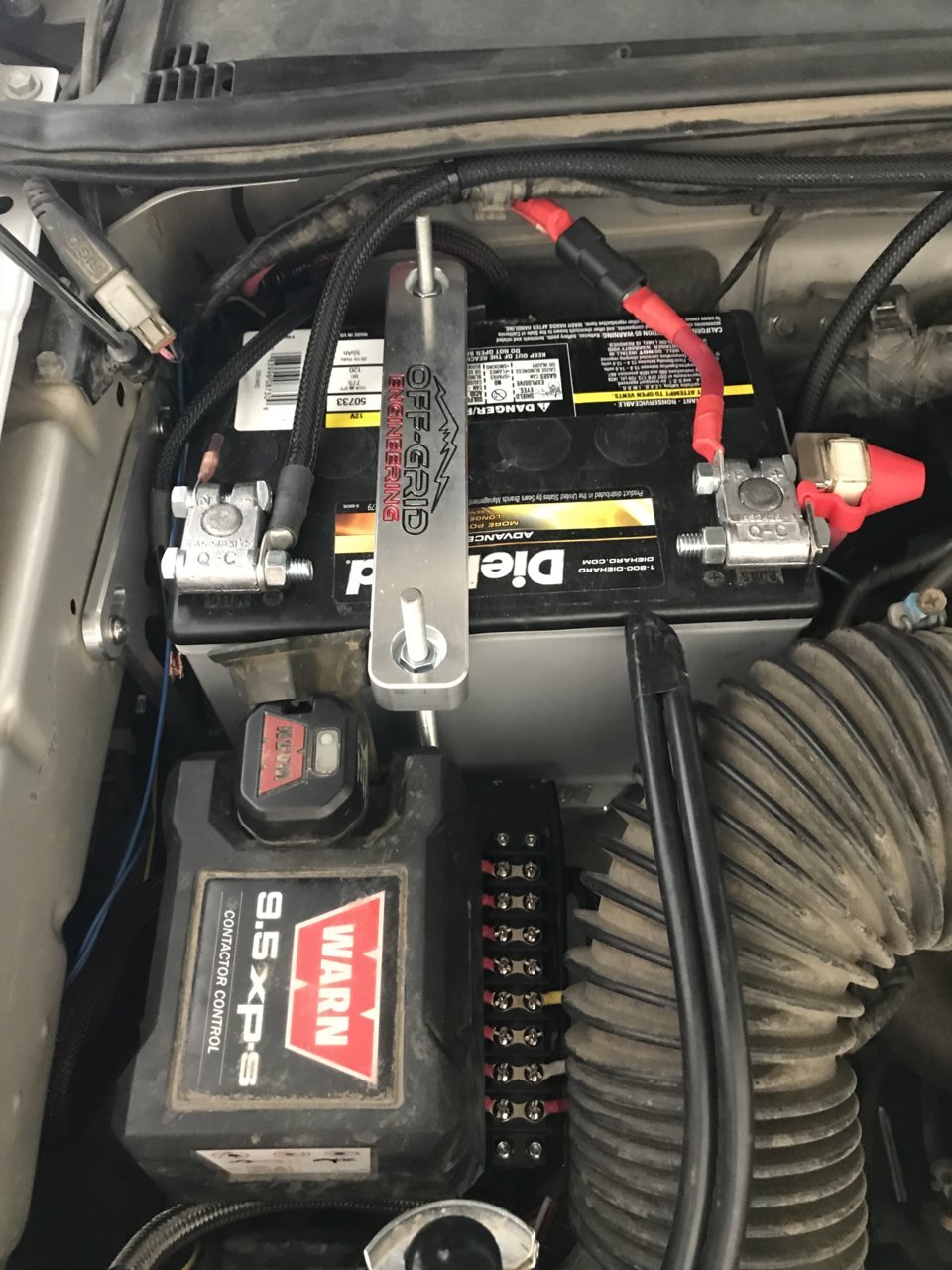

    I spent the last week slowly knocking some mods out of my pile. The biggest one was installing the dual battery system from Off-Grid Engineering. I bought this kit last year during their open house in their new shop, and it's been sitting in my basement since then. Over the winter, I filled in the engraved logo in the tie-downs with translucent enamel paint and coated with clear to give them some color.

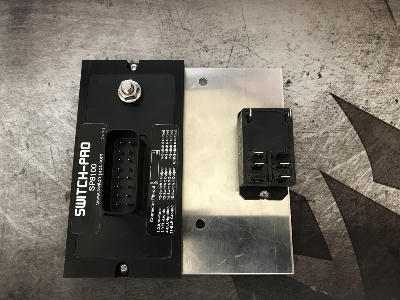

    When I got the dual battery kit I knew that I would want to hook up the Switchpro to it. The problem was that none of the ready-made trays out there would fit in my engine bay. Fortunately, the aux battery tray has a bracket for relocating a fuel resistor in new-model second gens. My truck doesn't have this fuel resistor, so I was able to fashion a crude bracket out of 6"x6" 1/8"-thick aluminum to hold the Switchpro relay box. I also needed a DPDT relay for the Baja Designs LP8's because according to the instructions, the low-beam and high-beam functions cannot both be turned on at the same time and the Switchpro doesn't have mutually exclusive switches.
    Another stumbling block was that I wanted to keep my winch box in the same location. Moving it elsewhere would have taken a lot of time and probably involve removing and reinstalling my OBA. I had a piece of 14ga stainless steel plate that I was already using to mount the winch box, so I cut it to size and drilled a few holes to be able to attach the winch box (now rotated 90-degrees) and a terminal strip.
    The plate is attached to the aux battery tray at two points - the 5/16" threaded rod (pictured) and a M8-to-5/16" threaded adapter on the fender bolt. The adapter is about 1.5" tall, which roughly matches the height of the original bracket, so a 1.5" tall aluminum spacer was also used around the threaded rod to keep things level and provide a more secure mount. This gives me some room underneath to run wiring and also provides some cable relief for the wires running out the bottom of the winch box.
    I still need to move some accessories to the aux battery, but I was able to at least verify that the chase lights and LP8's work as expected. I'm really pleased with the light from the LP8's especially - I will need to find some time to get out on a country road to fully appreciate their output.

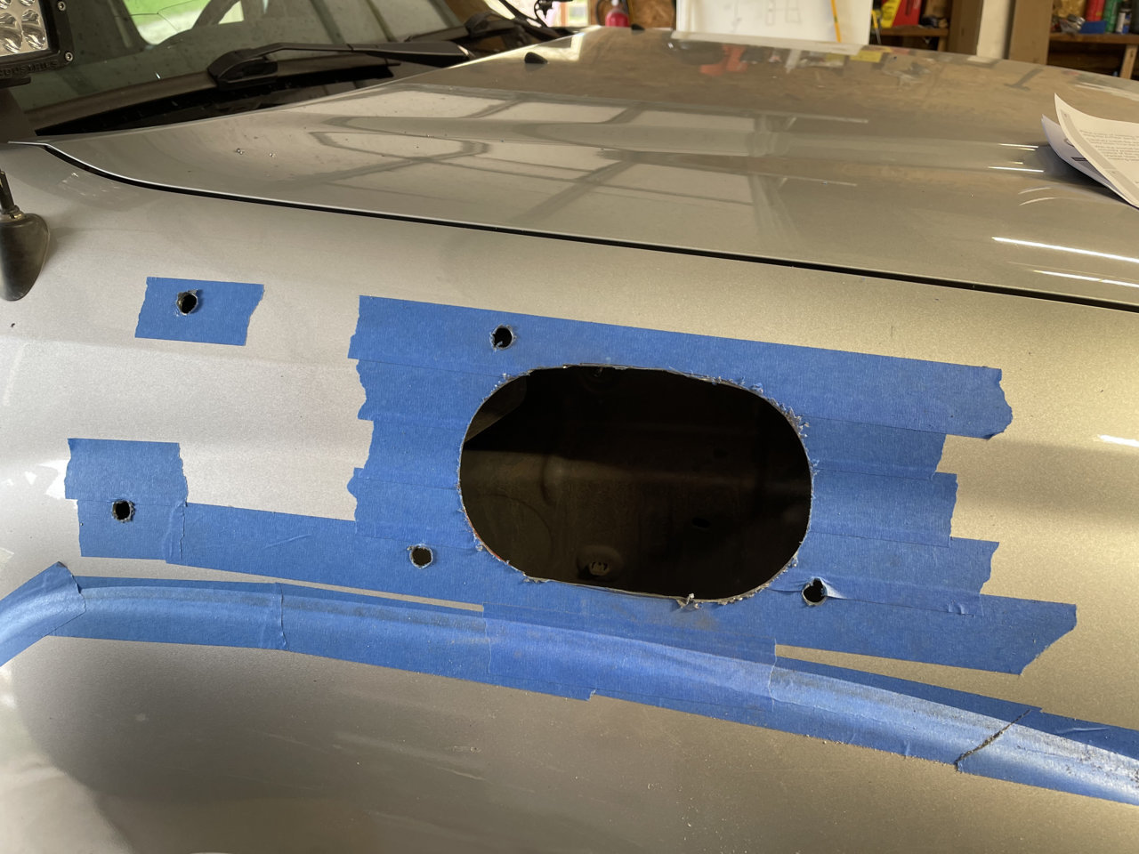

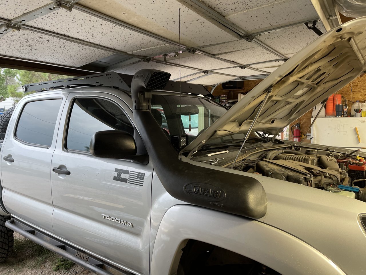

    Installed an ARB Safari Snorkel with the help of @Red Baron and @YamaDirtrider over the weekend. This is definitely not something that has been sitting in its box in my mod pile since the @3378jakesr5 Snorkel Group Buy of 2016 :anonymous:
    For this installation we had to run out and get a bigger hole saw. The instructions called for 4.5", but we went with 4.25" instead. The instructions also had some strange sizes for the mounting holes that would make them much bigger than necessary, like 16mm (5/8") holes for the mounting bolts. I'm guessing it's to allow more adjustability of the snorkel once it's on the fender, but we didn't follow the hole size recommendations. The template provided by ARB was pretty spot on and no additional trimming was needed.
    It's worth noting that I had to partially remove some previous mods such as the Slee ARB Twin compressor mount and my winch solenoid plate in order to get access to the bolts holding down the stock air intake tube. I also had to drill a new hole in the CBI bracket for the passenger side ditch light to clear the snorkel body.

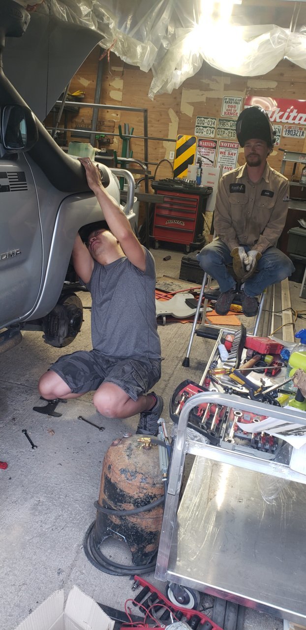

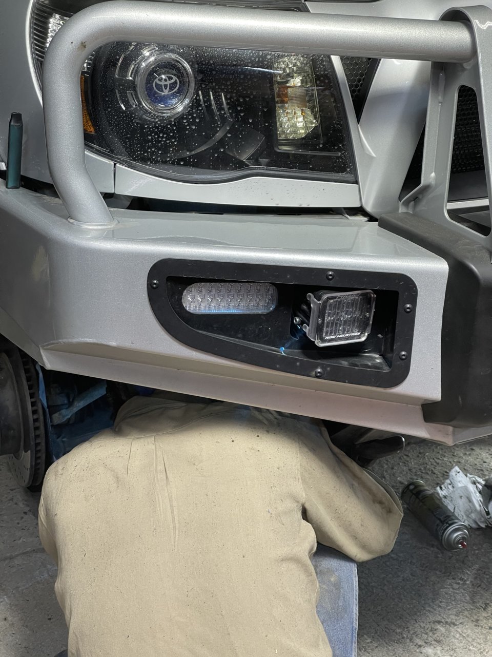

    After the snorkel was installed, they decided to play celebratory hide-and-seek for some reason. Here you see Aaron peeking Josh under my truck during one of their rounds.

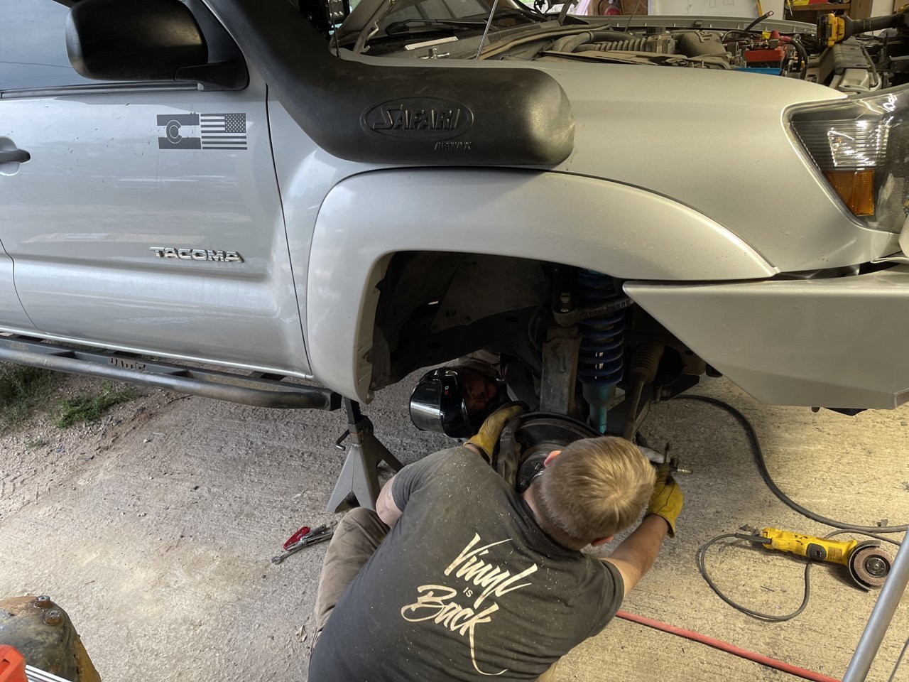

    After play time was over, Josh got to work burning in the Marlin Crawler LCA mount reinforcements.

    I was able to be one of the exclusive that had caught Davis in the wild actually working on his truck! And like normal Josh is sitting in the job :rofl::rofl::rofl:

    Looks to me like he's just trying out different ways to wear it.

    I wasn't the only one that day
