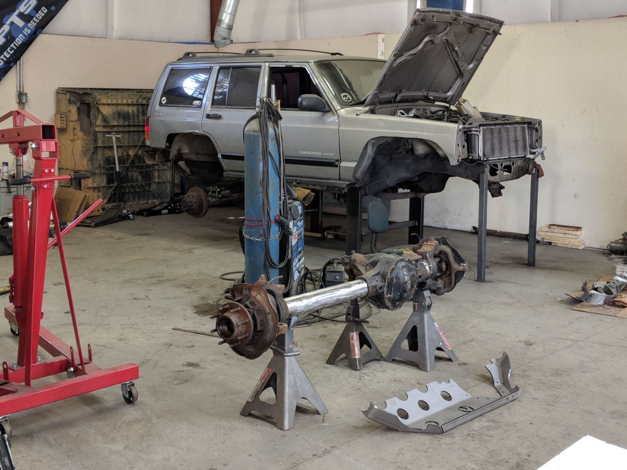

    Here's the new build of mine. It's a 2001 jeep Cherokee xj sport with 203k miles.
    List of parts:
    • Ford super 60 front
      • 1350 u joint
      • Yukon 5.38 gears
      • Super 60 axle shafts w/ 1550 joints
      • ECGS drive flange kit
      • Weaver Fab high steer knuckles
      • Spicer ball joints
      • Artec low profile axle truss
      • Artec full hydro ram mount
      • Artec upper link mounts
      • Artec lower link mounts
      • Ruff stuff diff cover
      • PSC full hydro
    • Sterling 10.5 rear
      • 1410 u joint
      • Yukon 5.38 gears
      • Ruff stuff +2 perch kit for rear axle
      • Anti wrap traction bar
    • 99+ Dodge Ram 1500-2500 van master cylinder for 3.9L 6cyl
    • (2) 7/8" to 7/8" rod end set for the 3 link
    • (3) 1.25" rod end set 1.5" tube ID for the 3 link
    • 3/4" alignment spacers
    • Pro comp Steel wheels w/ custom rock rings
    • (4) 40x13.50r17 Gladiator x comp tires
    • Corbeau Baja SS seats
    • Tanaka 4 point seat harness
    • Ruff stuff front frame reinforcement plate kit
    • Ruff stuff chassis channel reinforcement
    • Dirt bound rear unibody reinforcement kit
    • Rough country 4.5" lift leaf springs
    • NP231 tcase
      • 1310 u joints
      • Advance Adapters Slip Yoke Eliminator kit
    • Novak’s 4WD shifter cable
    • Custom front tube bumper
    • Custom rear tube bumper
    • Custom cross member for the 3 link
    • Custom boat sides
    • Front shock hoops
      • 14" Fox 2.0 DSC coilovers custom tuned from accutune
    • Rear shock hoops
      • 14” bilstein shocks
    • H.D. Off-road (no lift) engineering shackle relocation kit
    • Chevy lowering shackles
    • Custom roll cage

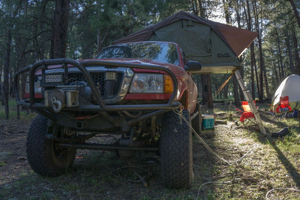

    What kind of vehicle is a 005?
  12. Aug 26, 2017 at 6:55 PM
    cmack
    cmack Well-Known Member
    Jun 10, 2016
    #189259
    7,436
    18 Burrito
    A Frankenstein bastard crawler that resembles a ferd :anonymous:
    mbmack1 and TXpro4X4[QUOTED] like this.

  15. Aug 26, 2017 at 7:09 PM

    What in the ever loving god is this....
    DustStorm4x4 and cmack[QUOTED] like this.

    Lol a lot of random parts from various auto vehicles chopped and welded together to make this hahaha
