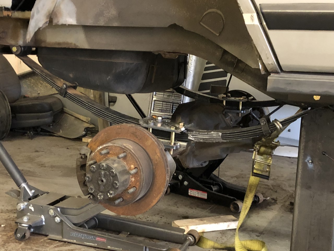

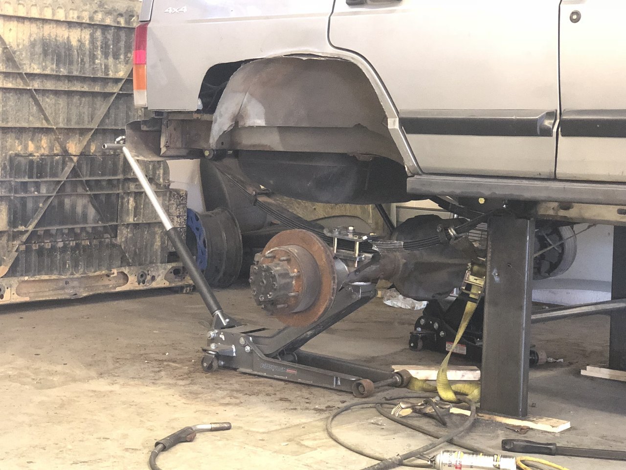

    It’s mounted. BE566168-1A8D-465C-A88A-2881211F0E5F.jpg 572A6151-ECB6-422C-814F-997FAA0E6426.jpg

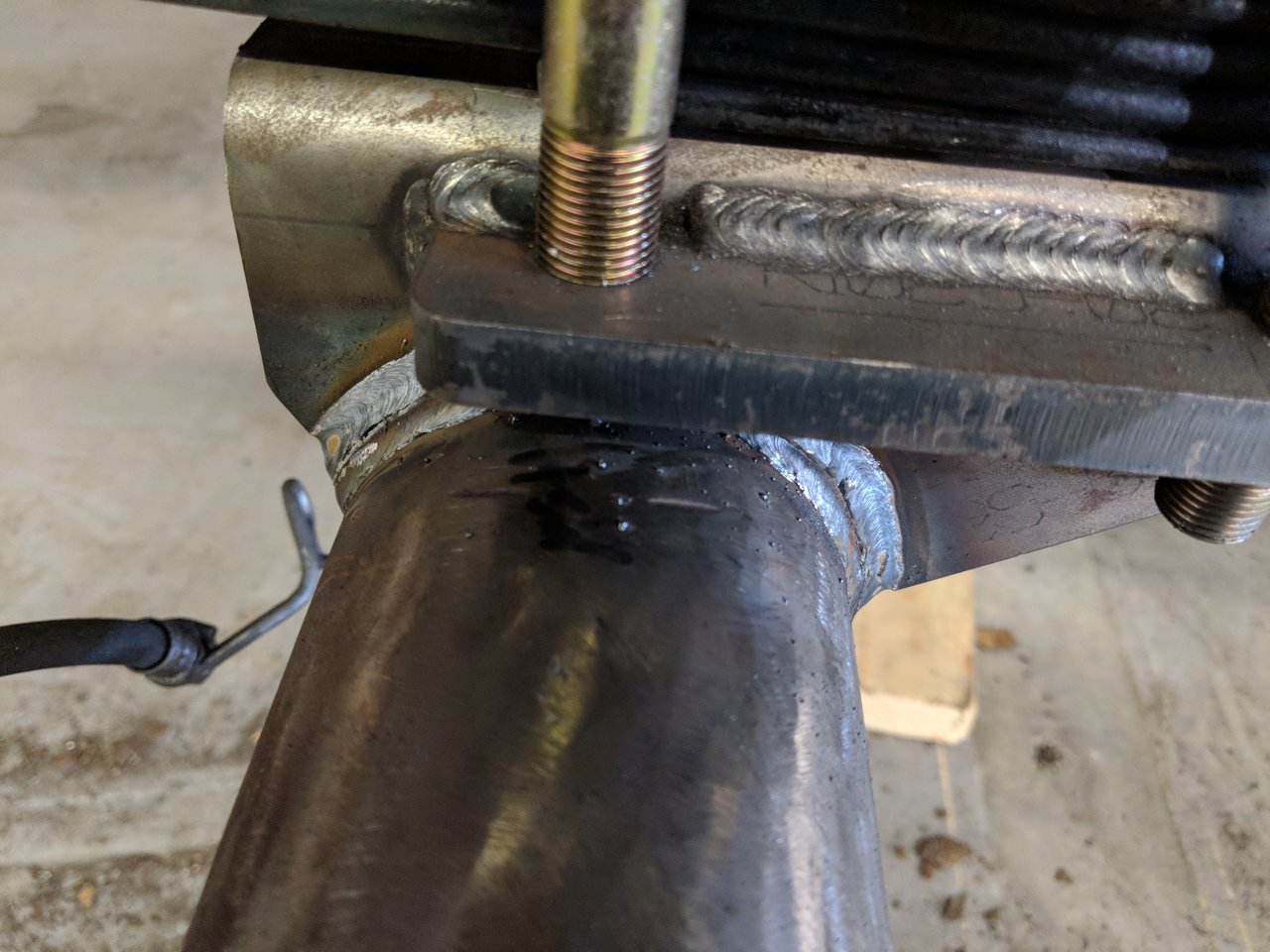

    He just post pics, but not of the Bullshit that had to be fixed to get it in.

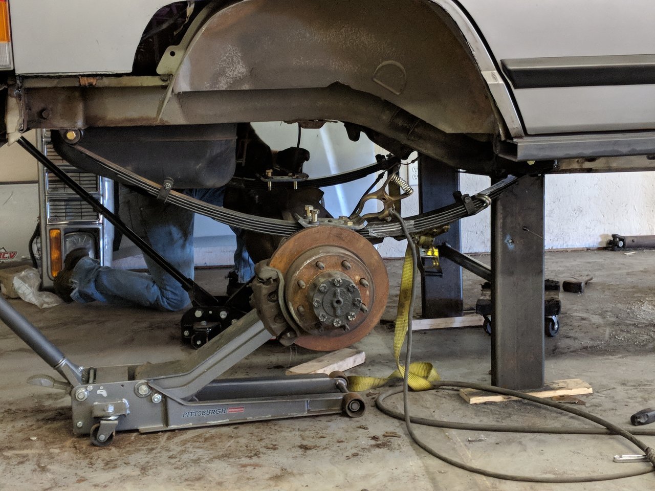

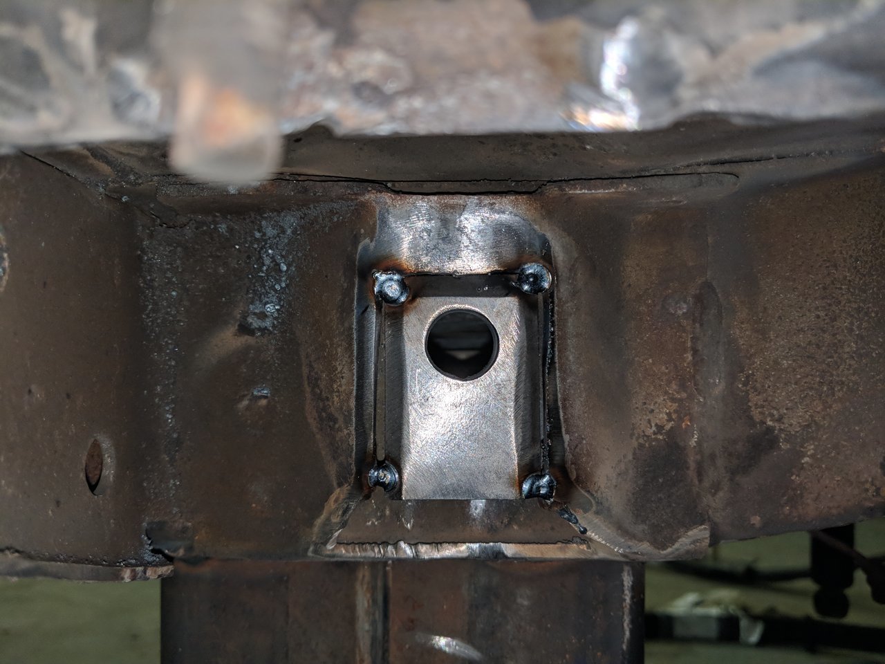

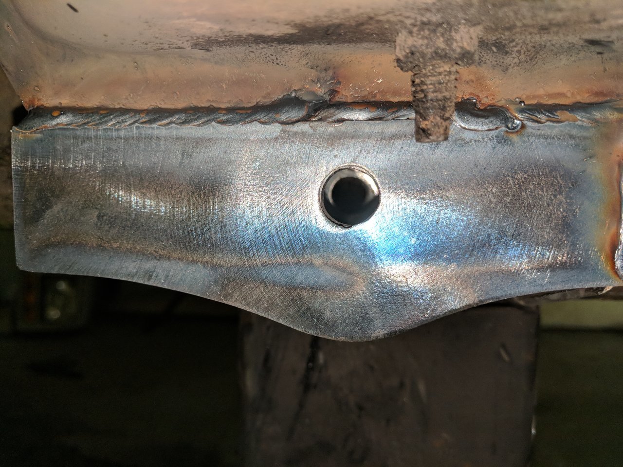

    To get the old springs out. The bolts broke. All of them. Had to be cut out the frame and replaced with new. And basically new hangers. Went back with 1/8 and over that with 3/16
    Now we can get the springs in.
    Now to adjust the angle and weld the perches on.

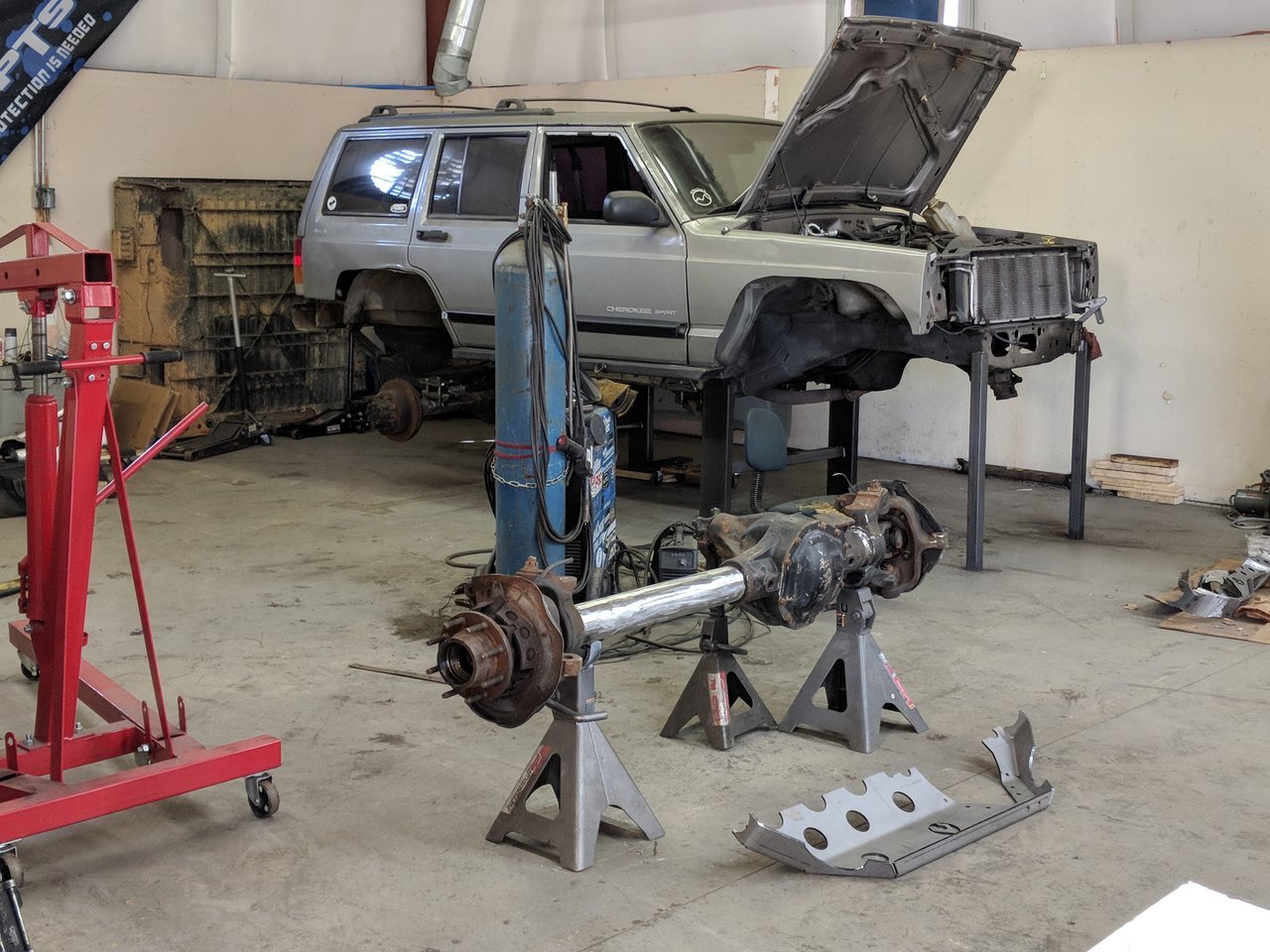

    While he was cutting slider legs. I cut all that poop off the front axle. And he was CEO of grinding. HNIC.
    Now I'm cutting and bend slider tubes.
    Got the area cleaned up and axle placed for me to add the goods
    Now back to our regular schedule of andy
