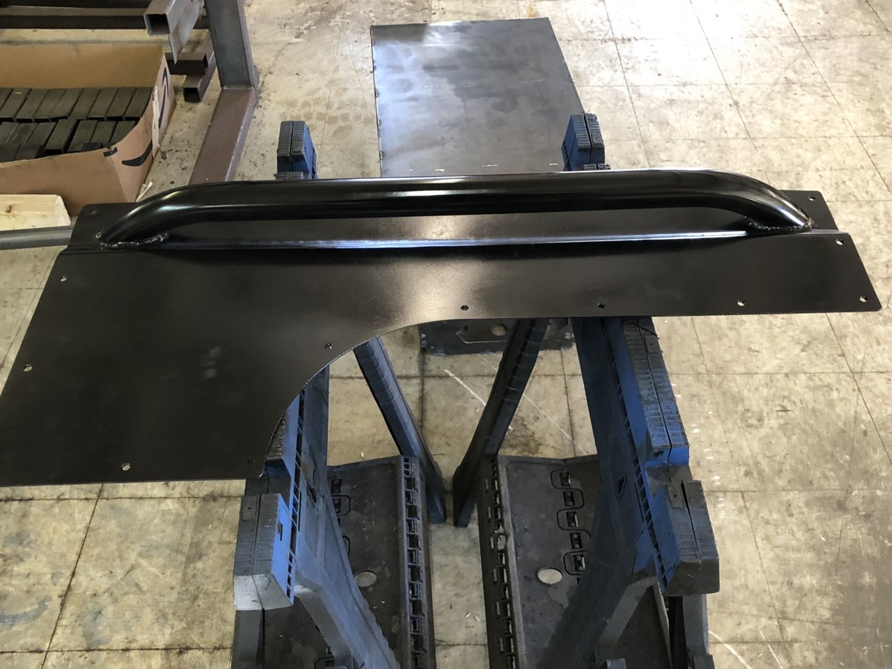

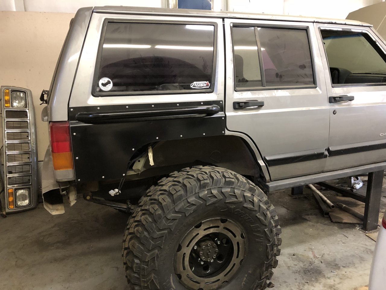

    Did paint some armor the other day at the shop. Was gonna color match it the best I could but I think the black suits it better. 01DD07E2-0B6A-4728-AF6F-069E1153F17B.jpg2A9138C8-2938-4F04-BD44-4080E543F06B.jpg

    Looks good

    Thanks dude. Figured black would be best since everything else will be painted black.

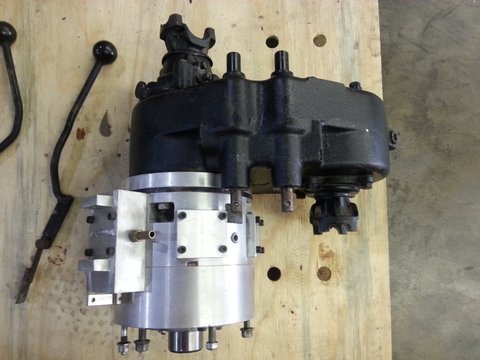

    a klune David v drive (Klune V/d20). Which is a 4:1 reduction box, mated to a dana 20 modified for twin sticks.
    This will give me 4 speeds. 1:1, 2.46:1, 4:1, and 9.8:1.
    Not gonna happen right now but maybe later on. Want to get out and drive the Jeep first and see how it handles, see what all I want to do with it before I drop a ton more money into it. Went into this build confused and cluster fucked now it’s time to step back and learn some shit.

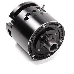

    check out this black box thing
