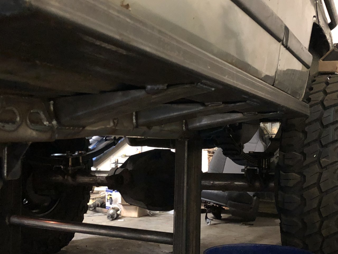

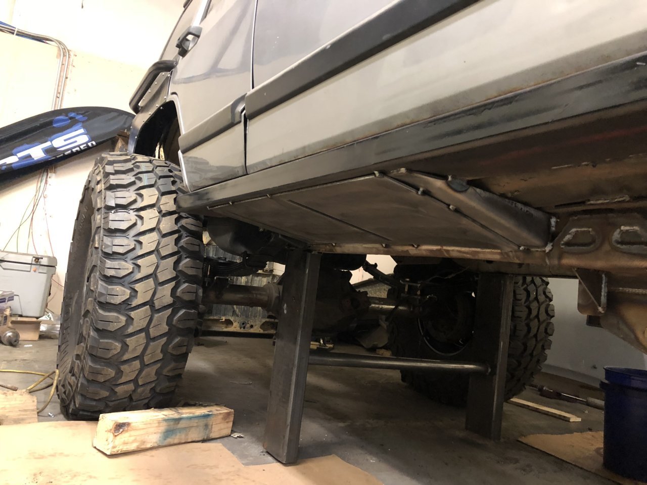

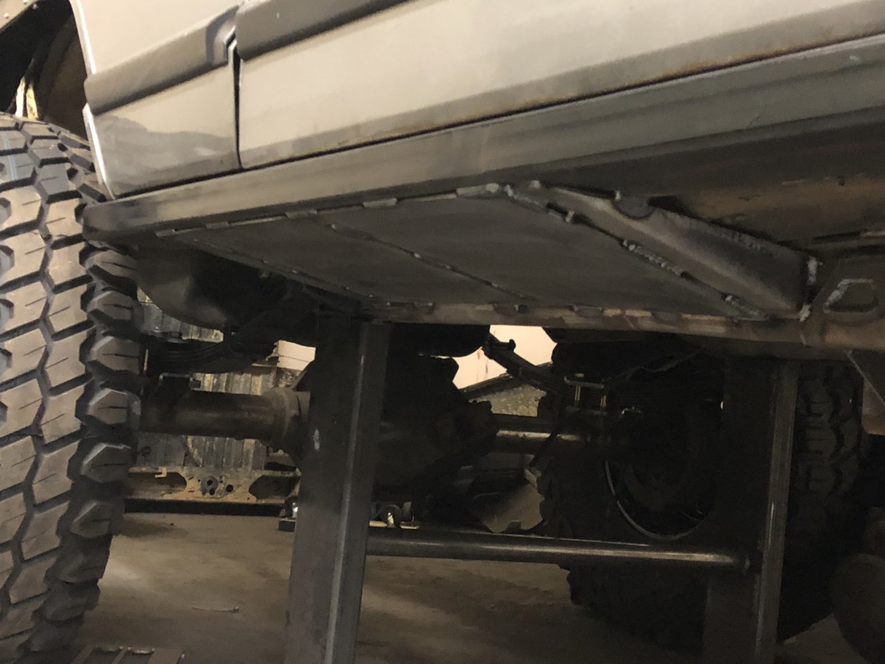

    Baby boat sides in the works
    E67E3501-7402-4409-80DC-CE9A29A21EBA.jpg 5EA52FF9-CB45-4E2B-892F-16A4A8C62BF2.jpg

    So, what keeps mud and junk from accumulating in there? Any way to drop and clean out?

    Spray it out the best I can not really concerned with it to be honest.

    There's another plate that goes in front of the plate he took a picture of. Can't add the other brace and plate till it's on it's own weight. The legs that are holding the jeep up are in the way to finish that part of the job. The edges around the 3 sides are a pretty tight fit and the bottom of the boat side by the frame has a 5/16" gap all the way down and has Stitch welds 2 on 8 across the bottom. So the only place where mud would get in, is there. And that's where y'all wanted holes for a drain haha
