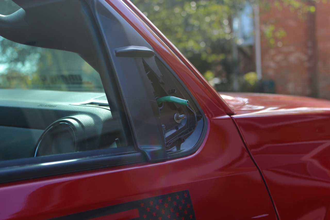

    Replacement OEM Passenger Mirror:
    • Broke my mirror on the trail
    • Replaced with OEM one and was able to reuse the factory color match cover

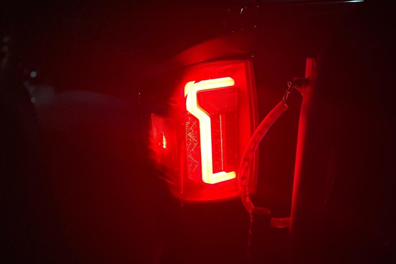

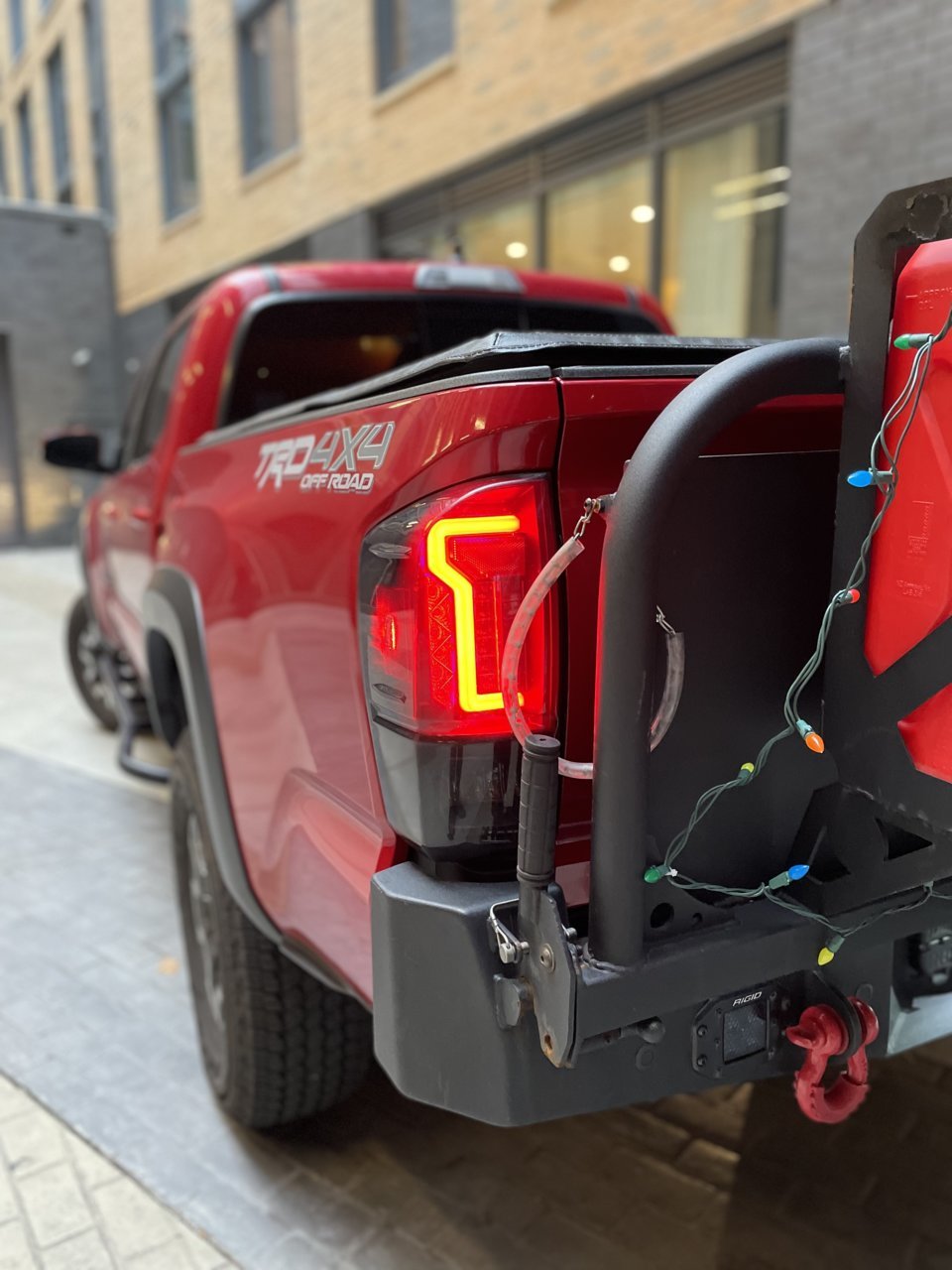

    Winjet Smoked Raptor Tail Lights:
    • Sent to me by Chris H.
    • Love the raptor look!
    • They look the best at night!
    • Buy here
    F1E68D25-5EAA-4218-BA77-6C9BABD08FF7.jpg 3F6A3AB8-720B-483F-A76D-FE8BB713C054.jpg

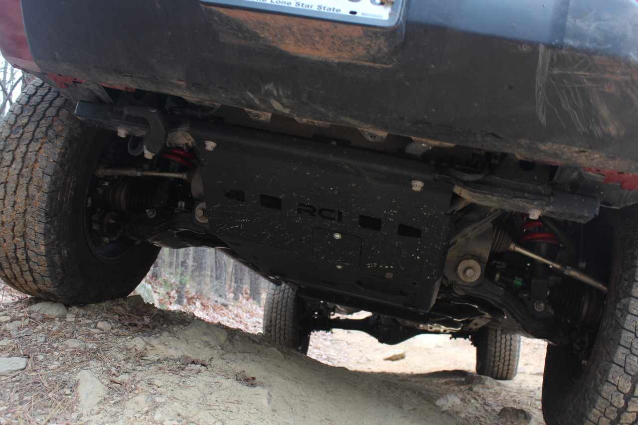

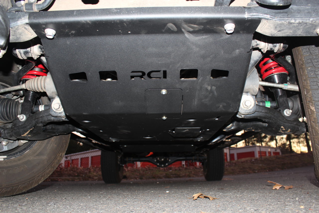

    RCI Full Skid Package:
    • It is clear that the stock Tacoma skid plates are tissue paper garbage
    • Upgraded to RCI full skid package that covers engine, transmission, and transfer case
    • 3/16" Steel
    • Buy them here

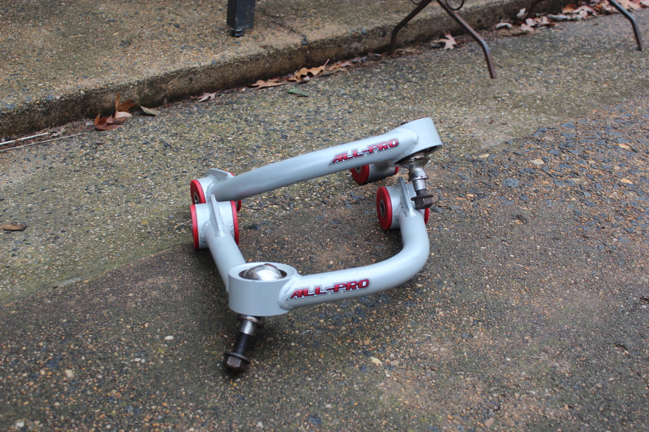

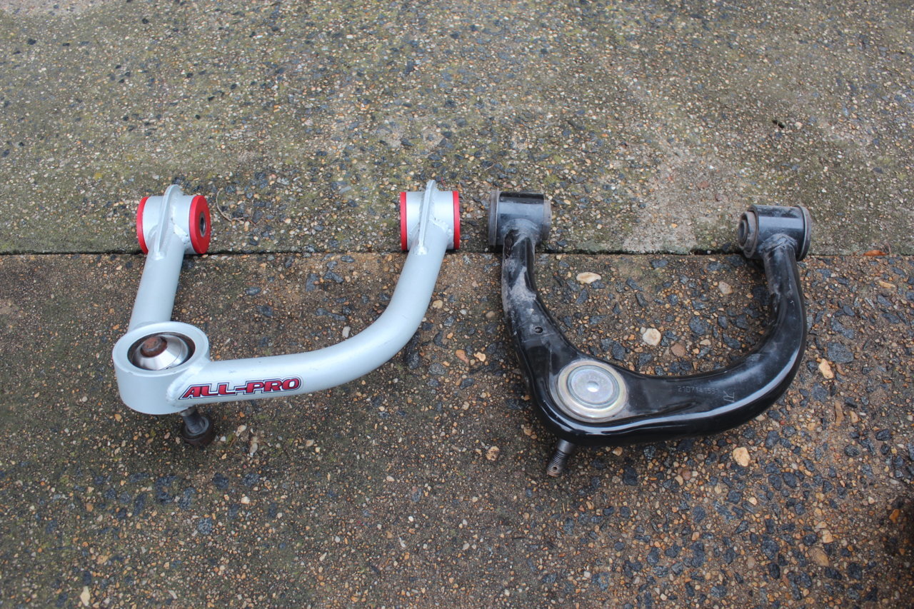

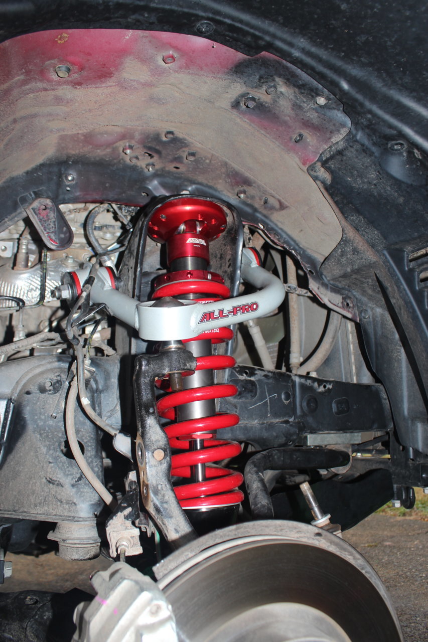

    All-Pro Off-Road 1.25" Uniball UCAs:
    • Thank you to TJ for sending these out for the build
    • Smaller than stock UCAs that allow for bigger tires in the future
    • Make the lift feel 100% better
    • Buy them

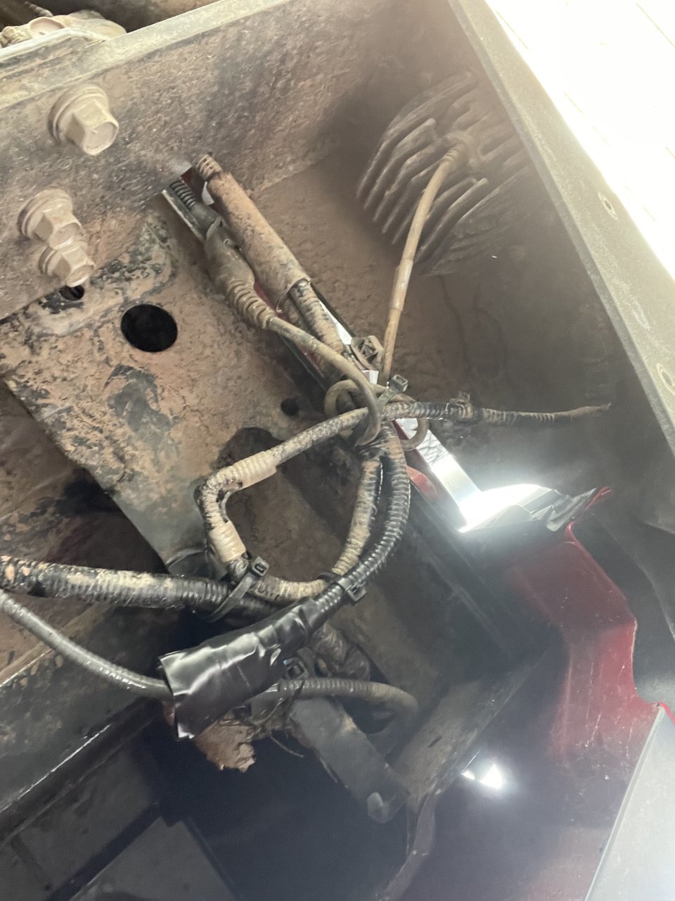

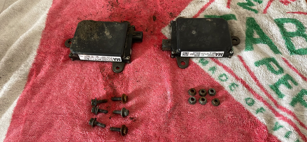

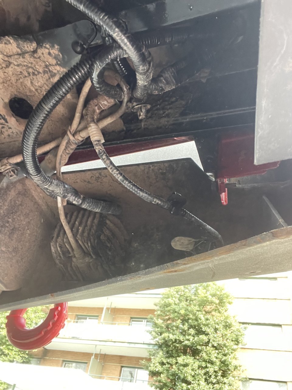

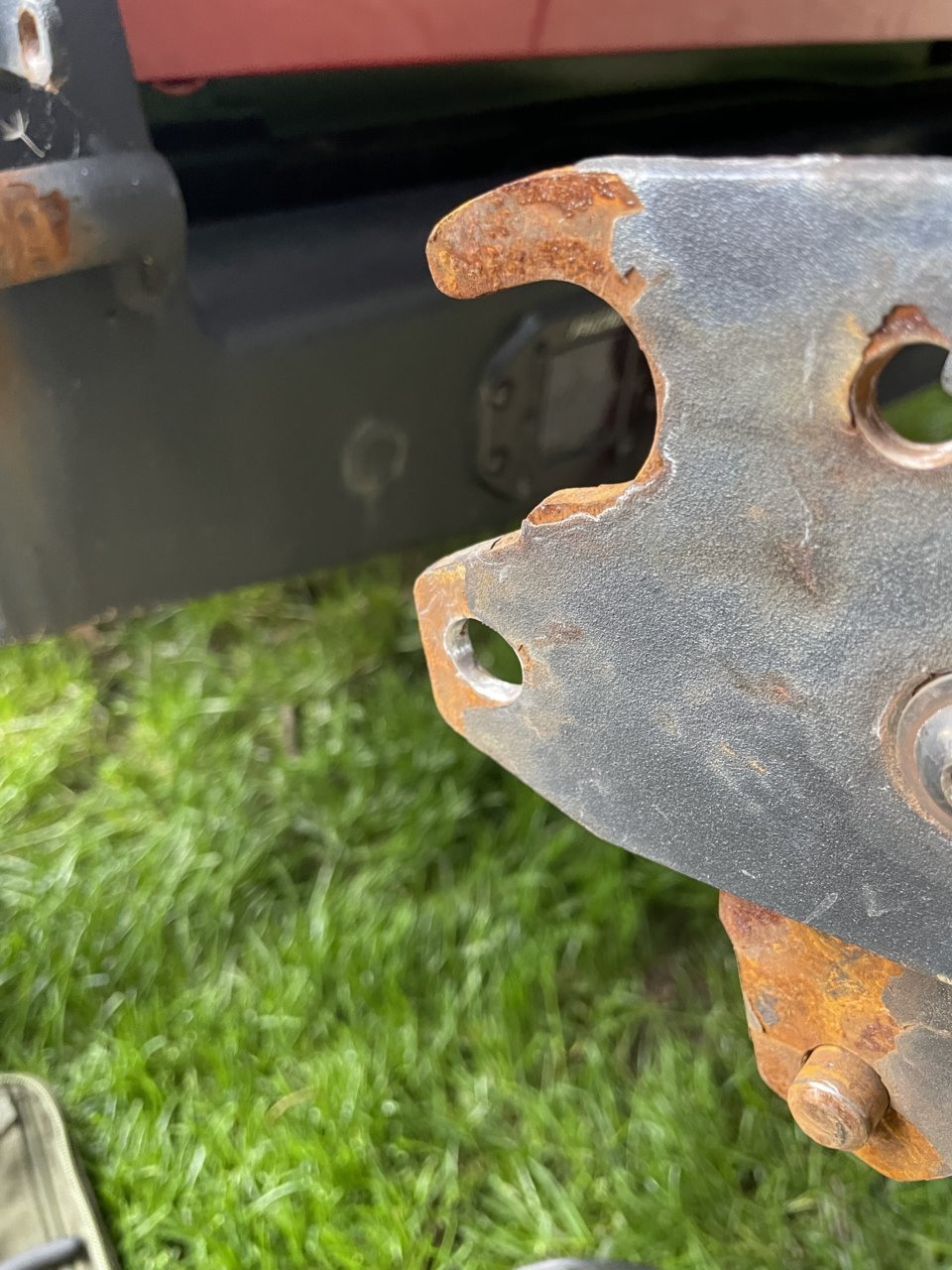

    Blind Spot Monitor Delete
    When we installed the after market bumper (SOS Offroad Concepts Swing Out), we decided to bolt the BSM to the bumper. Not because of functionality, but so the harness could still have all its components attached.
    Turns out the BSM needs room to breath and an air gap. Because it was flush mounted on the inside of the bumper, it short circuited with water. This caused all the safety features to seize and blew a fuse.
    The best thing to do was remove the BSM all together.
    View from the bottom showcasing the old plug that has been wrapped and zip tied in place.
    Another view of the same thing. You can see the old bolt holes in the bumper.
    Here are the removed monitors with their hardware.

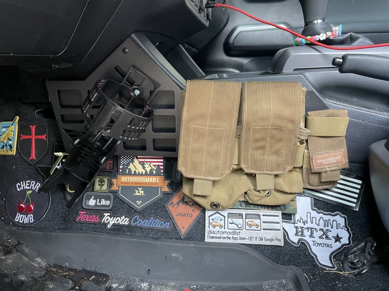

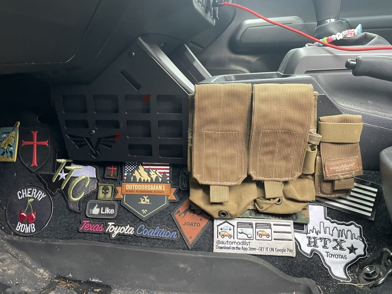

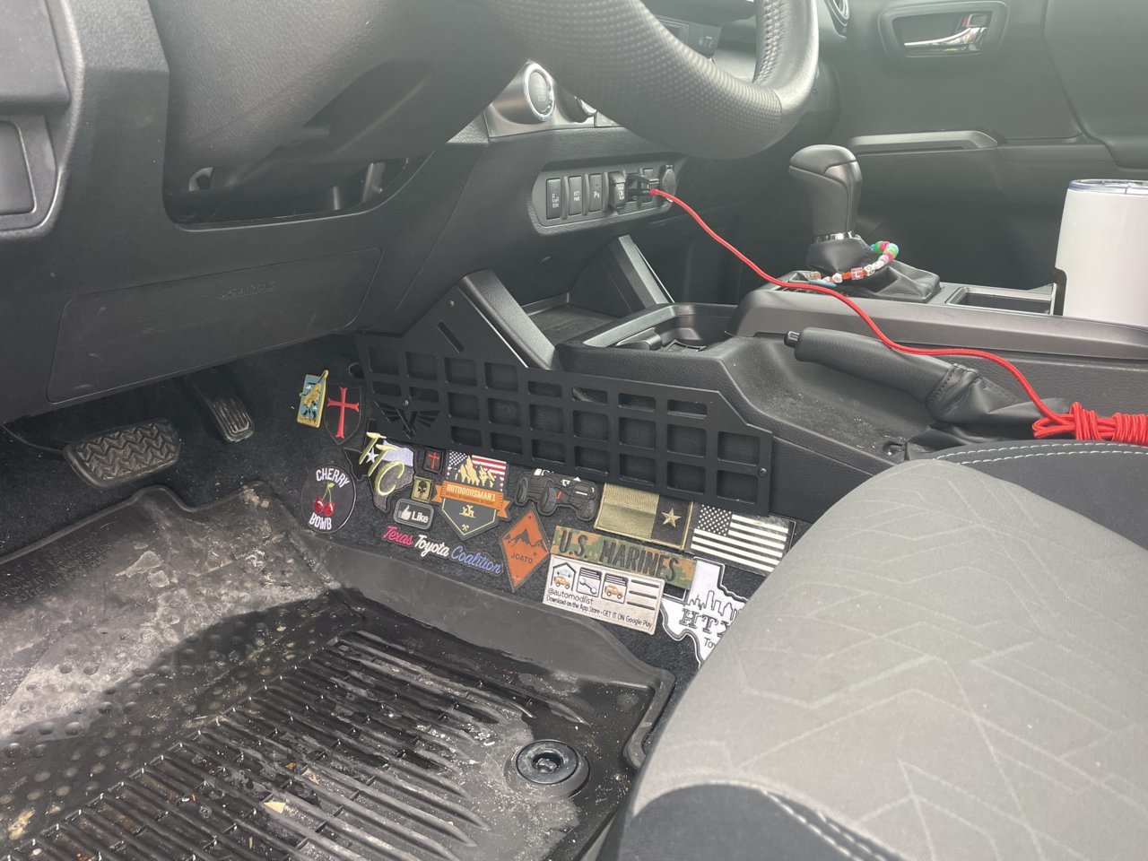

    Victory 4x4 Center Console MOLLE Panels
    A quick and easy way to allow for more customization and organization in the cab!
    YouTube tutorial here!
    Buy them here!

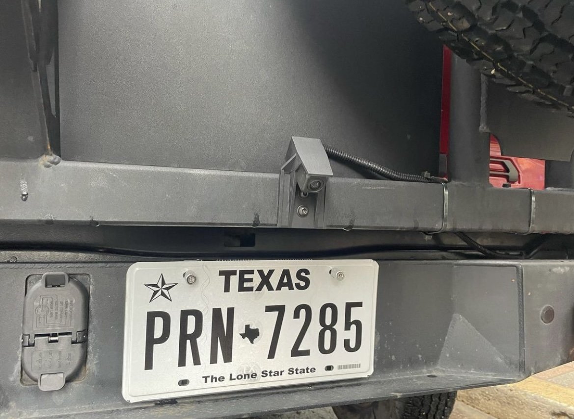

  9. Feb 28, 2022 at 6:20 AM
    #29
    KidWithATacoma
    KidWithATacoma [OP] Taco and Tacos Lover
    Jul 4, 2016
    #191186
    534
    Mac
    Arlington, VA
    2021 TRD Offroad
    Debt
    Backup Camera Relocation
    Moved the backup camera from the tailgate handle to the swing out! Video and install here!

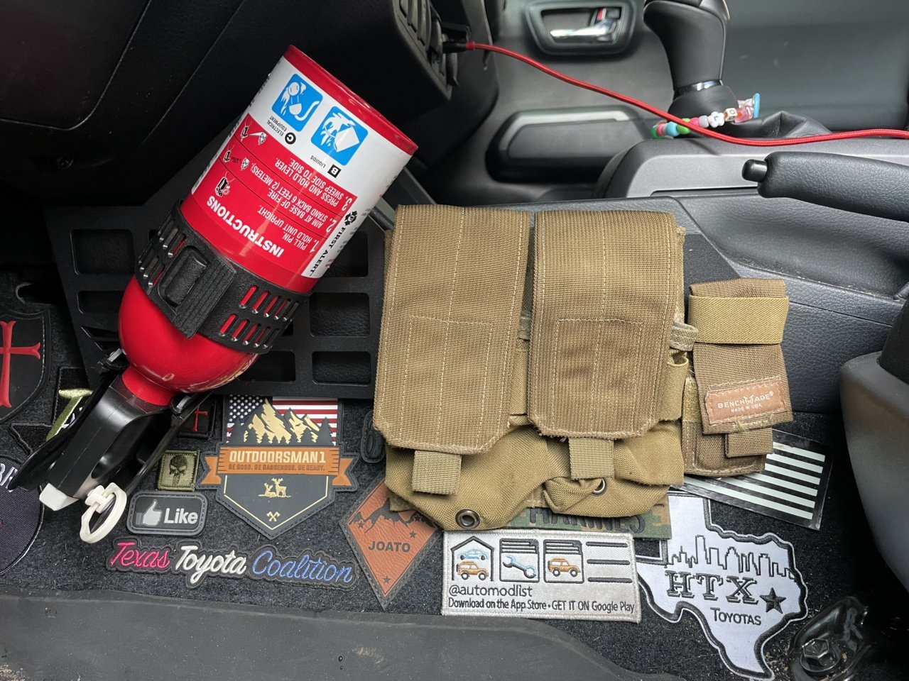

    First Alert Fire Extinguisher
    The First Alert fire extinguisher is an important addition to the Victory 4x4 MOLLE panels. Nice and close to be accessible in any emergency.
    It was important to have it mounted at an angle to ensure that the other pouches were not hindered.
    The red lines indicate where the fire extinguisher mounts to the panel.
    The mount/holster is bolted to the panel.
    Here is a view that showcases the top bolt with its washer to help stay in place.
    Here is the washer!
    Most likely will make a full video soon about the full setup of the MOLLE panels!

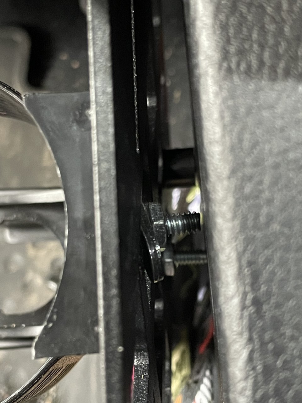

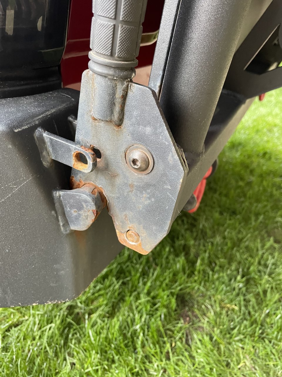

    Improved Bumper Handles
    • Latch was not attaching when bumper handle was engaged
    • Make the safety latch hole a little bigger
    • Big improvement!
    27CCD3D8-3E8E-4A1B-AA54-A8505C1C91ED.jpg E071FBE8-498F-4DE5-B5BF-1DC9E98C6372.jpg

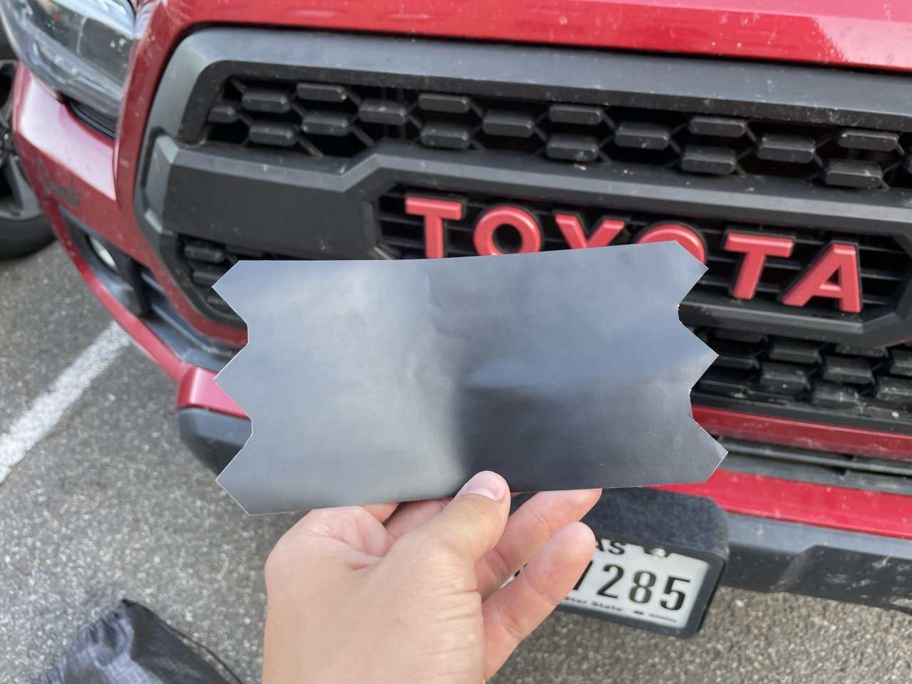

    DIY TSS Sensor Matte Black
    • All chrome must be destroyed
    • Shoutout to Ricky for the vinyl that I have used for multiple projects
    • Does not effect sensor use, see here
