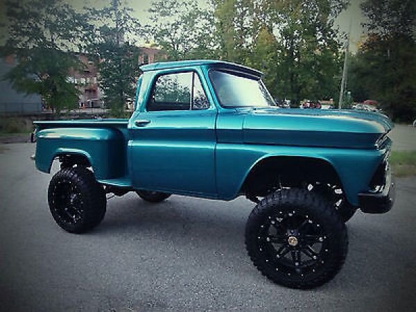

    Boy, did I get surprised. Came to check on this thread cause someone was gonna hybridize a 1963 Chevy and a 3rd gen Taco
