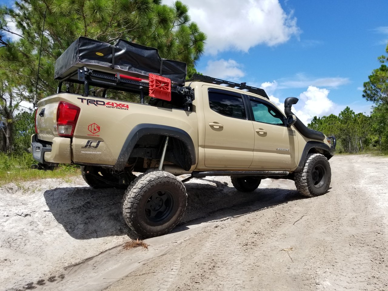

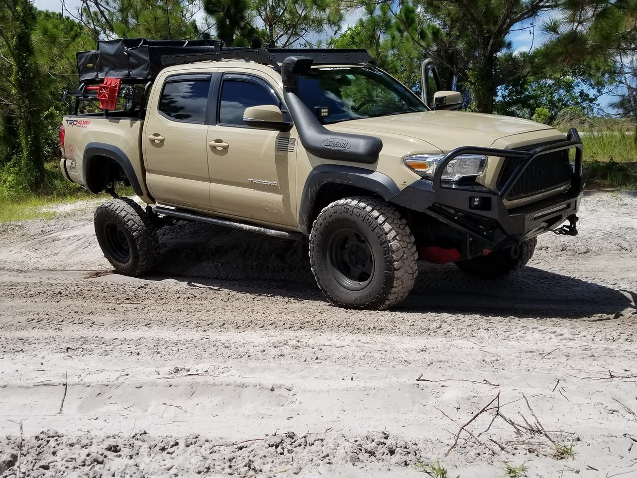

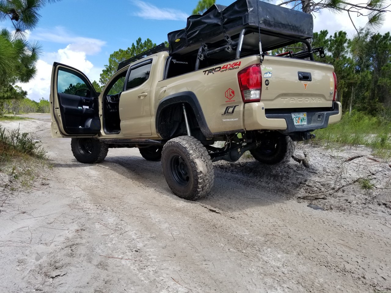

    The finished product. Not even full flex, need bigger hills in South Florida.

    With the tent, rack, spare 33, and about 150 pounds of other stuff in the bed, I got about 3/4" of squat. Without any weight, I'm at 4.5" over stock. The ride quality is soooooo much better too.

    That's maybe 2/3 flex too. Post install measurements showed 9 1/4" down and 6" up travel.
