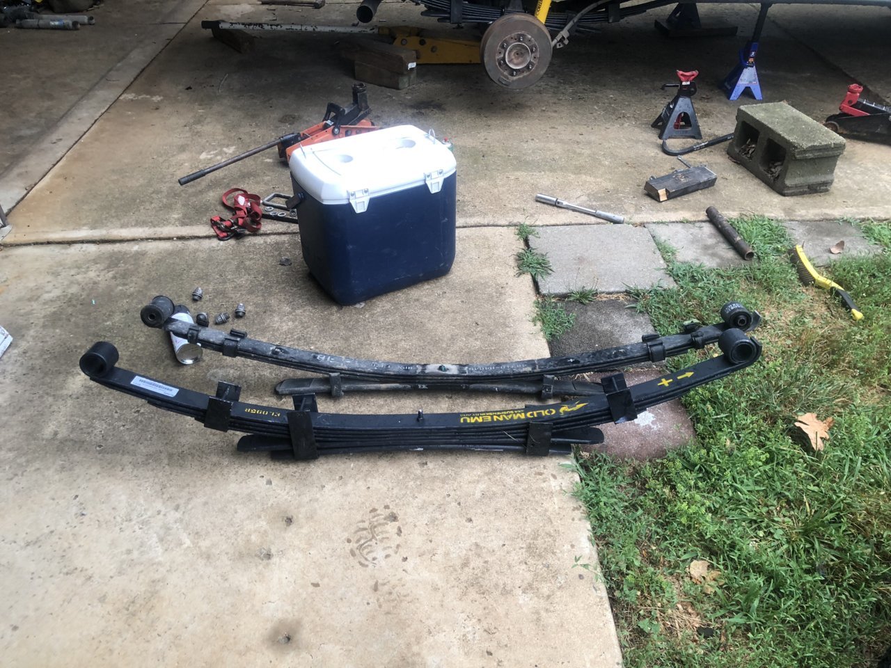

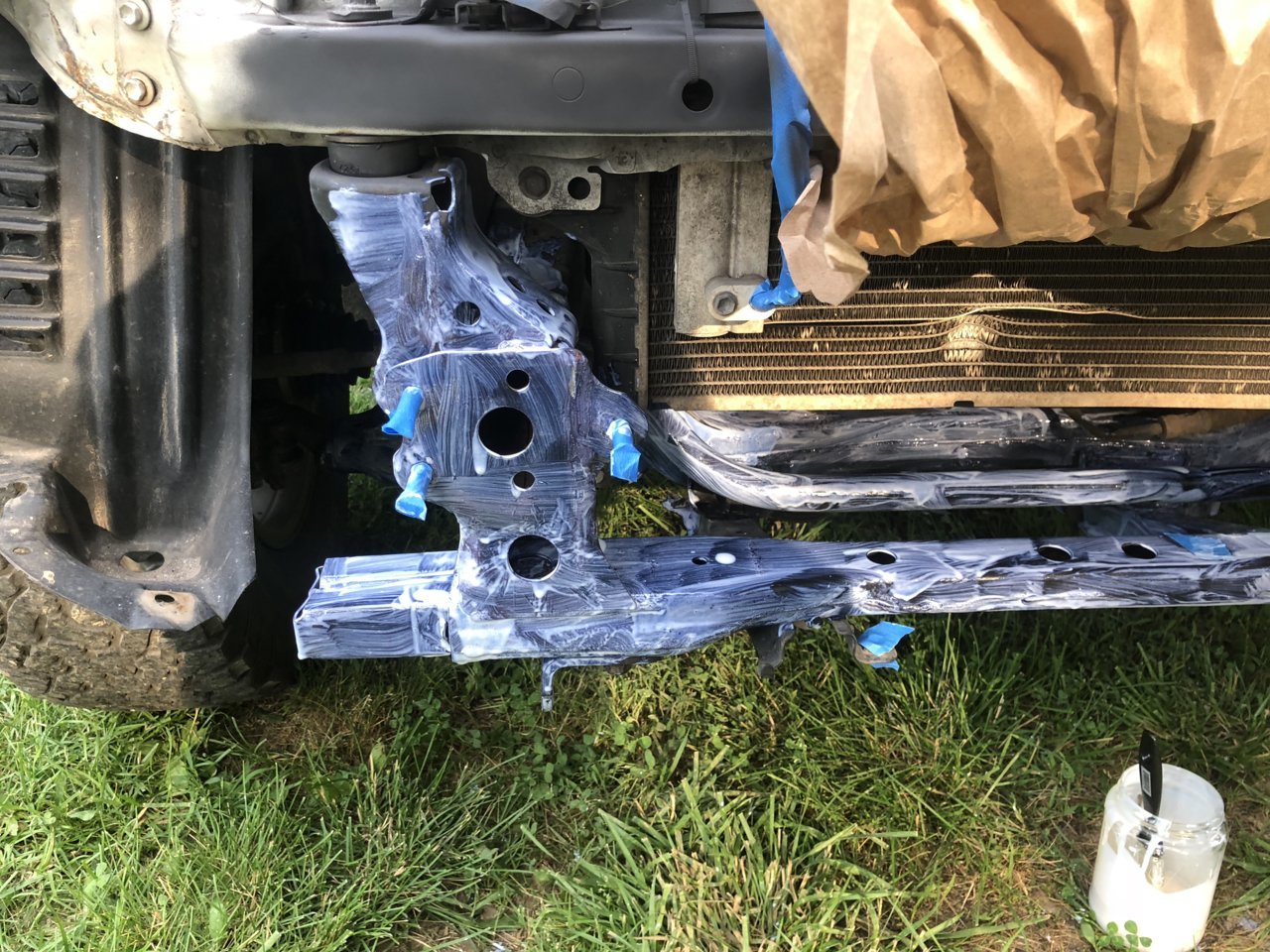

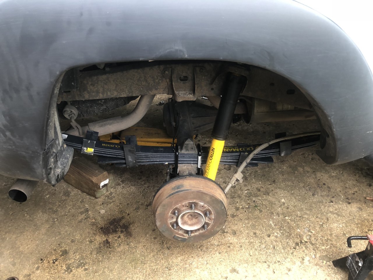

    Finally put on the OME nitro’s and Dakar leaf pack in the rear. Hopefully today I’ll get the front done. It always seems to rain when I work on my truck.
    Recently I started using a rust converter on the frame works pretty good.
    Also I installed my ARB bumper should have placed it higher but it is what it is some people put it much closer to the flares and I wanted to leave some space so I went with 20mm Gap as ARB recommended.
    And I changed out my wheel bearing.

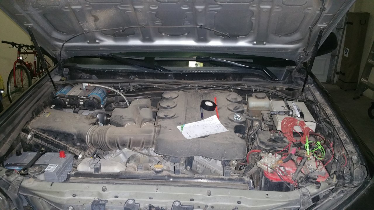

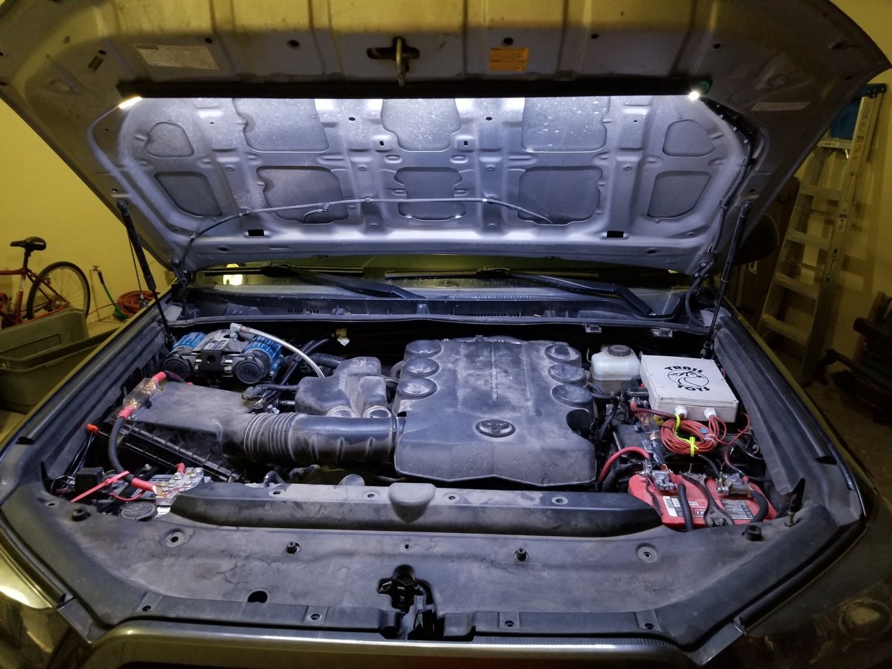

    Reviving this. I bought the Fluke meter and have been more than happy with it.
    Now I have also finally got the second battery under the hood and have been doing MAJOR underhood rewiring/rerouting. This is the one thing I wish i had just pony'd up the money for to do all at once in the beginning but because i didnt i made more work for myself along the way, complete with the most work to date to take wires run from the passenger firewall nipple to the drivers side battery and moved them over to the passenger side battery. going to try not to cut the wiring any shorter and find a spot to store them cleanly, if not well then cutting will ensue. The pic posted is the before picture. I will post up an after pic soon.
    Now i just need to find a spot to put the trailtoysNSA box on the passenger side. or maybe mount my ML ACR somewhere else. decisions, decisions.
    Also bought radflo fronts for my baby on black friday so that is going to be AWESOME (when they come in off 4 week backorder)

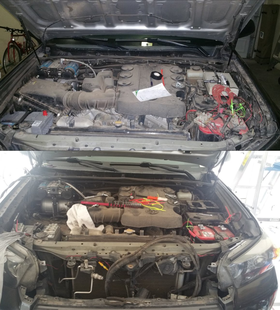

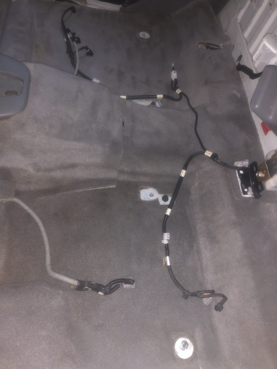

    rerouting the wiring has been a bit of a pain (that might also be an understatement), even though I am getting more efficient at it, though the worst part was my Amazon ML-ACR and switch being DUDS!!!! I am beyond pissed about that because I lost an entire afternoon to BS troubleshooting a BAD ML-ACR from amazon. I should have trusted my gut when i noticed the old solder on the wires and tape residue on the wires and on the back of the ACR. When I got all the way done and tried to get it to function it dint function, and I spent a lot of time fighting with it before determining that it must be the ACR. I swiftly ordered a new ACR and switch from OGE (since I had already bought their wire harness to route to the switch) and they SWIFTLY shipped me one! (Shameless plug for OGE: they were helpful to me all along the way when he helped me determine the style of Deutsche connector I would need to modify my ACR to work with his harness. He was responsive and caring and literally within 10 minutes of each order I placed, the item was SHIPPED!!!!) Last night I got it all plugged in and it WORKED! I shed a tear of joy that everything was correct the way I had it wired and routed and all I had to do was swap out the ACR. It was a beautiful moment to see those lights pop on on the switch and hear that "click" from the ACR.
    Attached are beginning and intermediate pics (teasers because I don't have final pics yet, cool your jets they are otw). The intermediate day is where I have the airbox taken off and I thought I had about gone out of my damn mind fighting with the stupid dysfunctional ML-ACR. I thought myself crazy for going through the headache of all of this but its going to look great all buttoned up with everything wired up and ready to go. I am going to fab one more item, a small bracket to mount my 2/0 gauge winch power anderson connectors too (both the one from the winch and the one from the starting battery). until next time...........

    Finished it tonight!!!! Yaaaas!!! It feels good to start some thing, get it right, and finish it. Hooked up my solar panel again and everything is back the way it was but BETTER before the great underhood wiring experience of dec & January.
    Now let's play a little game of find the ACR because I hid it quite well :)
    Next up, radflo front covers, serpentine belt & idler pulleys, front wheel bearings, and spark plugs.

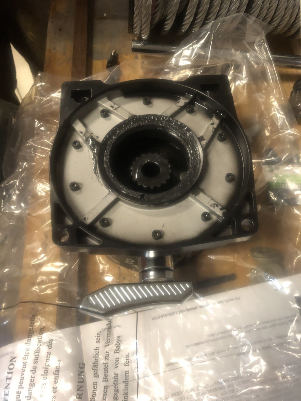

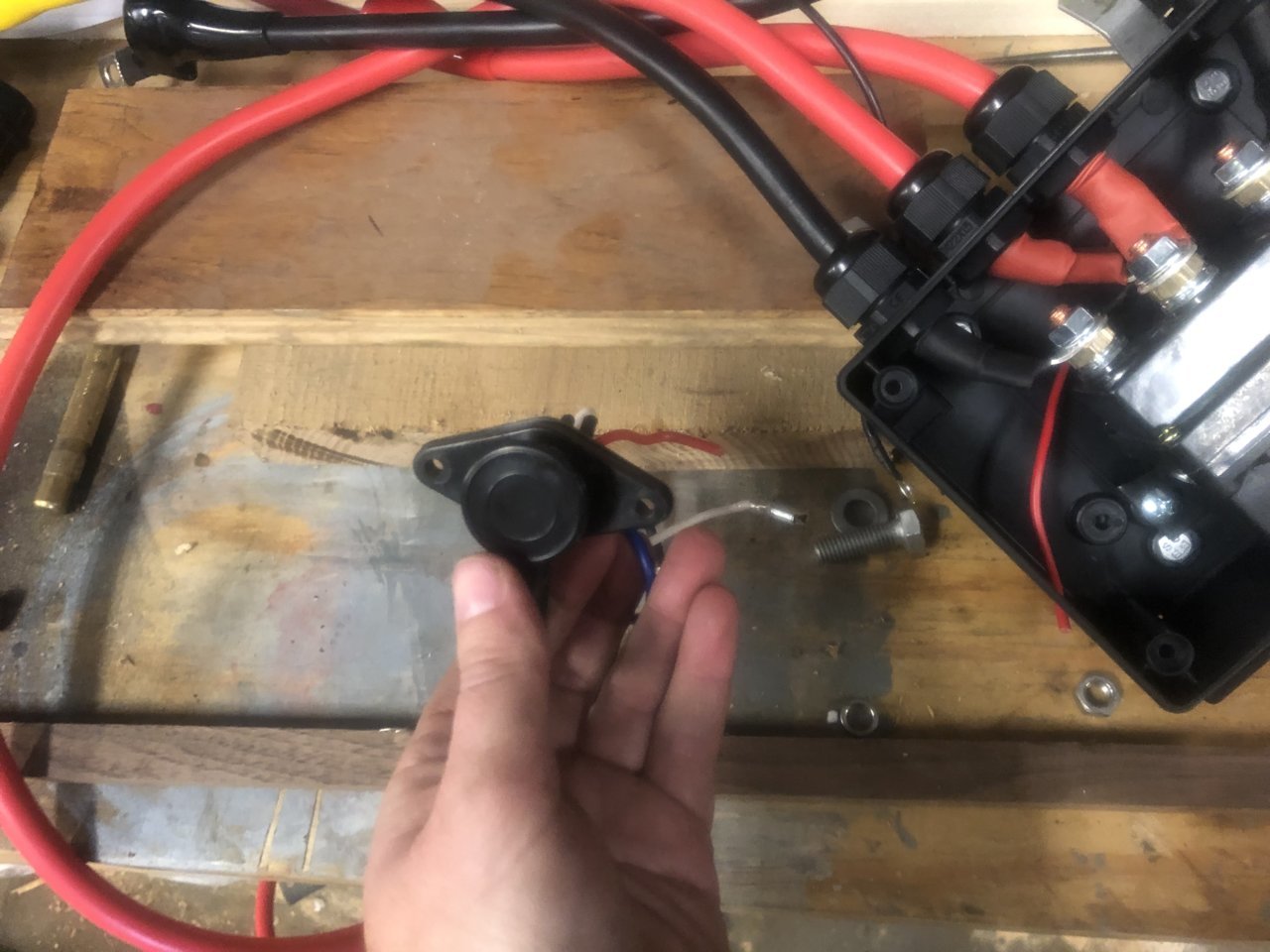

    Installed a HF Badlands 9K winch into my ARB bumper last night. Relocated the remote plug so I could keep a clean look. With it clocked right you do not have to trim the handle to fit in there.

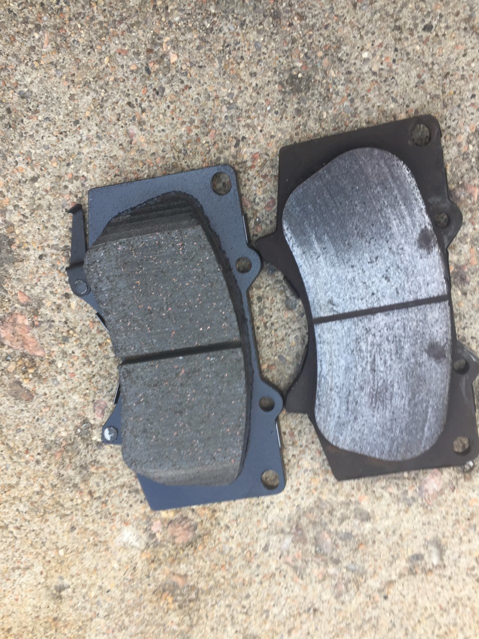

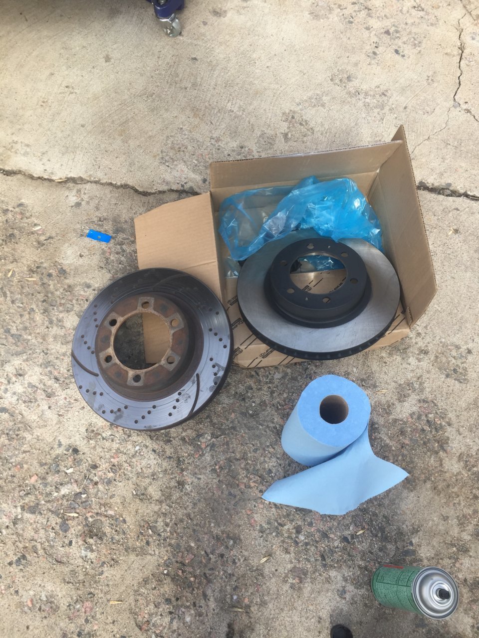

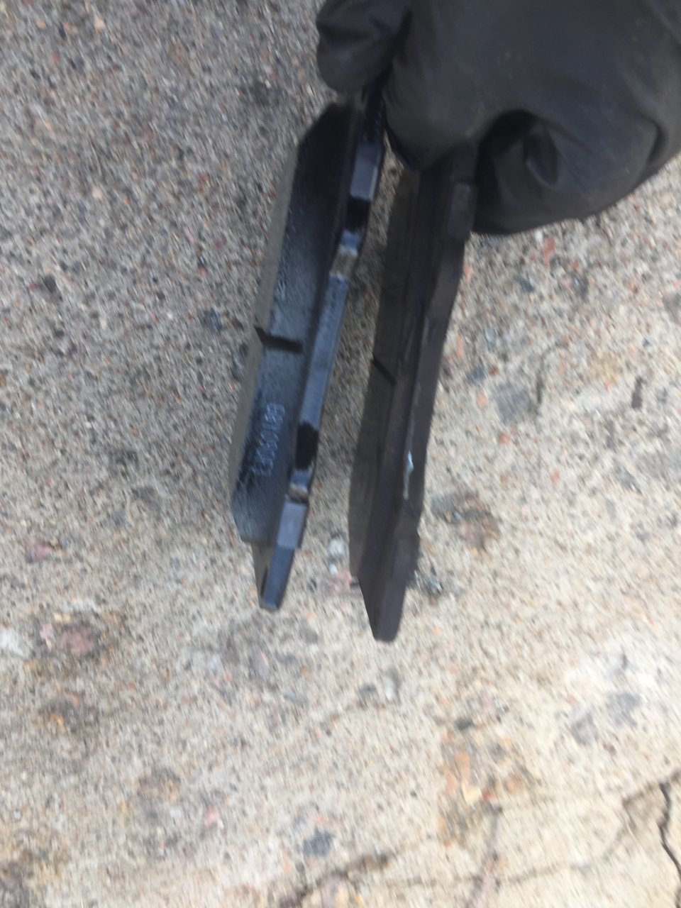

    Changed out my front rotors and pads the other day.
    Went back to OEM rotors paired it with akebono ceramic pads.
    Came fromEBC rotors and hawk pads.. The hawk pads were nice, but didn’t last long, and ate the crap out of the rotors.
    I’ll see how this set up goes

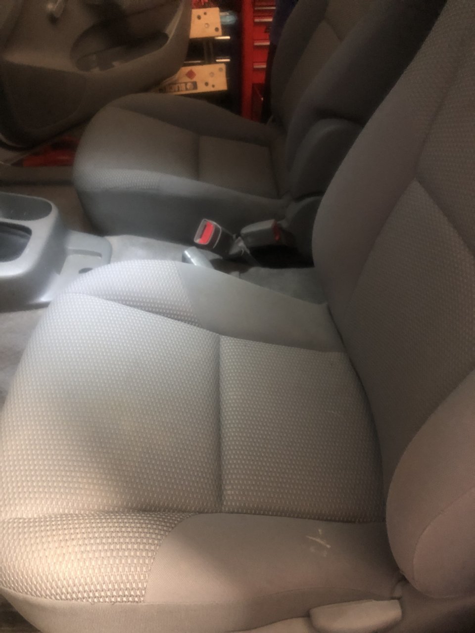

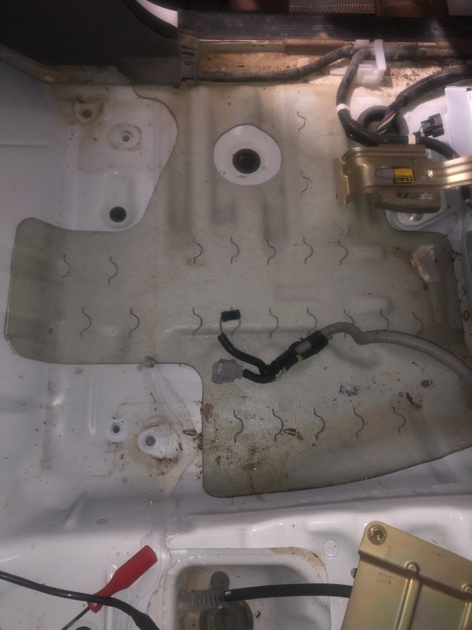

    Did the bench to bucket swap. No drilling required all the holes were already there Uber the carpet. Used the old seat belt clips because the ones that came with the seat do not connect to the seat belt for whatever reason. Took out the old weight sensor and put in the passenger side seat. Used the old wiring harness from the bench seat and after hiding the wires under the carpet it looks pretty clean!

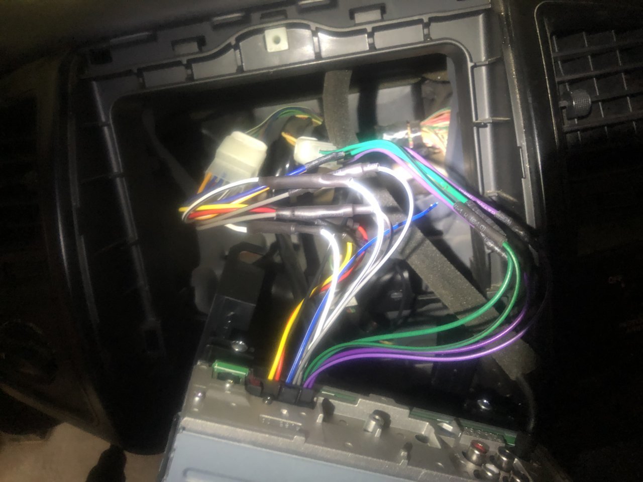

    Upgraded my radio, I bought a double din so my cb could be mounted in the radio but my helper got over zealous and ruined the face plate cover so I will have to buy another one in the mean time I guess I’ll mount the cb between the seat. Soldered the wires then put shrink wrap over them. New radio sounds way better I was surprised because it’s the same speakers.

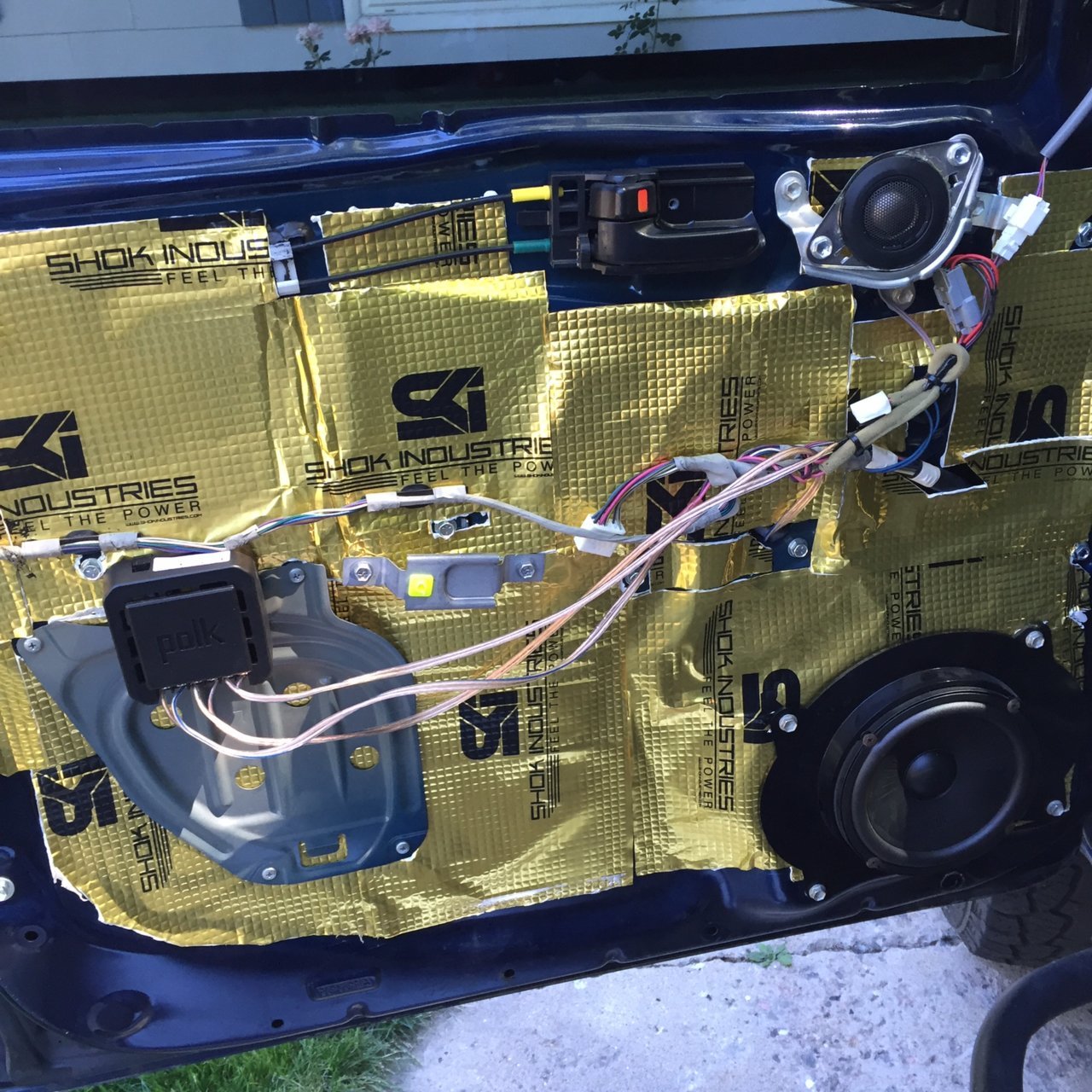

    ICONS Front & extended Rears DAKARS LR UCAS Wheelers Super Bumps F/R Homersoshi & Bumper insert, Ultra Gauge, Wet Okole seat covers, AFE air filter, Truxedo tonneau cover, LED White Cluster swap by yosh2000, Audio upgrade, ECGS Bushing, rcbs204 Lighted 4x4switch, Bullaculla trailer harness relocate bracket SOS Concepts IFS skid & sliders Anti- Dark RedLine Hood Struts Matt Gecko Bed Lights BHLM Depo Tailights Fog light anytime mod ABS cancel mod Rear diff breather mod Brake light 35watt mod Relentless u bolt flip Mobtown Recovery Bar Sound deadener doors rear wall

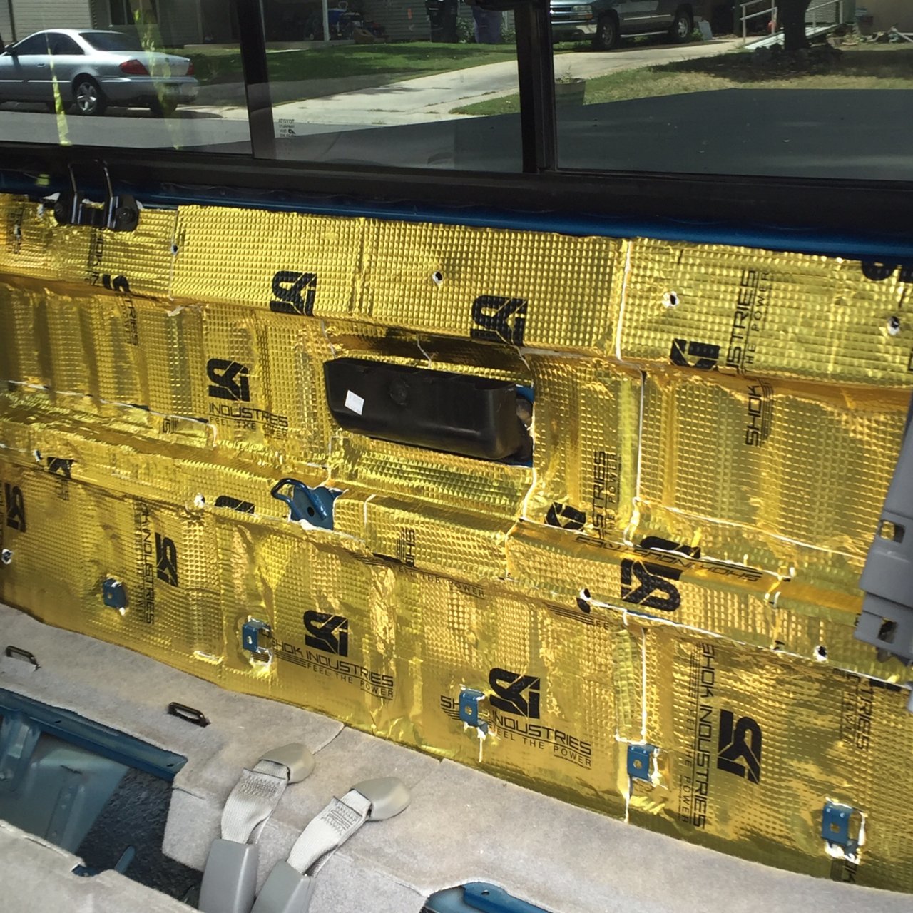

    Yeah and when you put speakers it’ll make it even better!!!
    While you in there add some sound deadner:thumbsup:
    994006A7-90C7-4B01-9000-96AA89F427EB.jpg A5E03E08-2647-4A7F-AC07-D2A07C3D1797.jpg It’s very therapeutic :D like putting together a jigsaw puzzle

    I plan on doing an upgrade and sound deadner for sure I hate it when people do not take the time to do that.

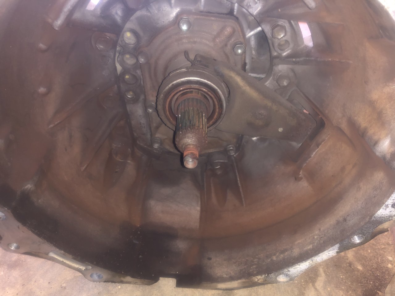

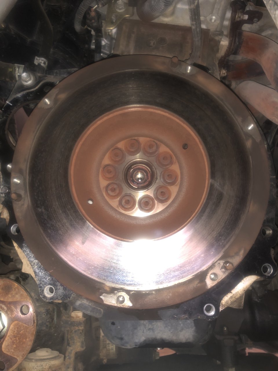

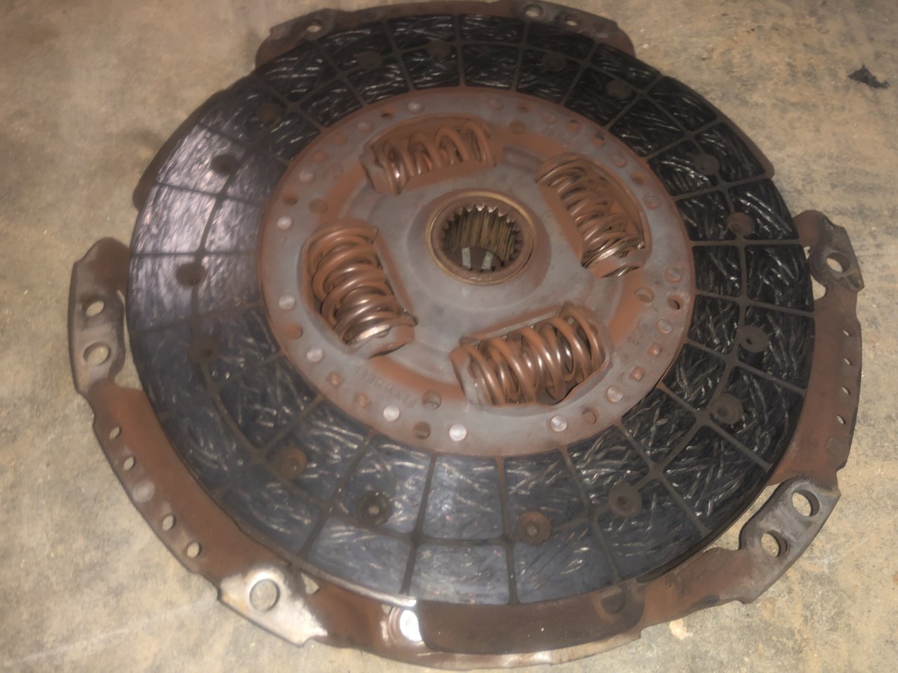

    New clutch installed and flywheel turned. Good to go for another 150+k
    I obviously changed all the bearings and transmission rear seal that had a small leak.
    It was a PITA and I am glad I went to my friends house and had help. The bell housing needed a little forplay to finally line up but we got there. Also I was glad I had a ride to the machine shop to get the flywheel turned. Next clutch I’ll upgrade the flywheel and clutch but this one is like driving a car lol.
    Flywheel before had some blueing to it but. I heat cracks
    Old school lablome I believe and he did a great job for $30 but since he fit me in same day in a pinch I gave him a tip
    After being turned took off a 10/1000th
    Old clutch not dead yet but didn’t want to wait any longer.
