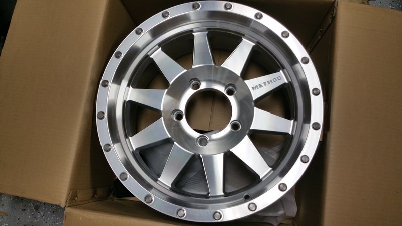

    Wheels & Tires:
    Method Standards, machine finish 18x9, +18 backspace
    Nitto Ridge Grappler 295/70/R18

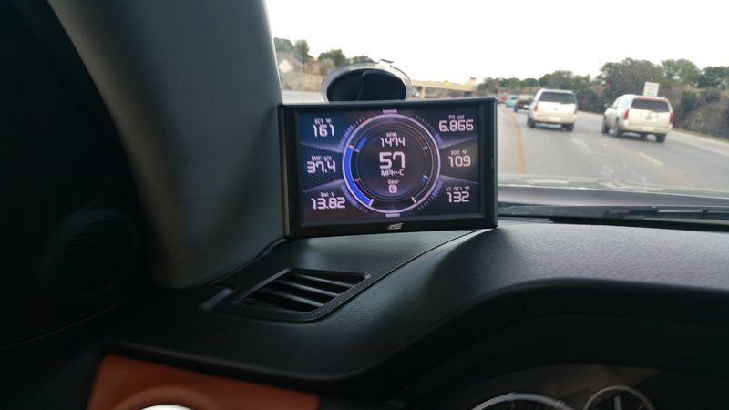

    ESP 3 compartment metal under seat storage unit

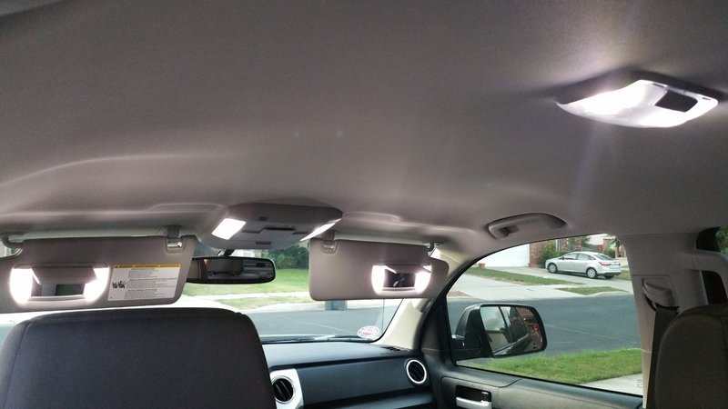

    InteriorLED's (Photo is from the 2016 Tundra I traded in, But I moved them over to the 1794)

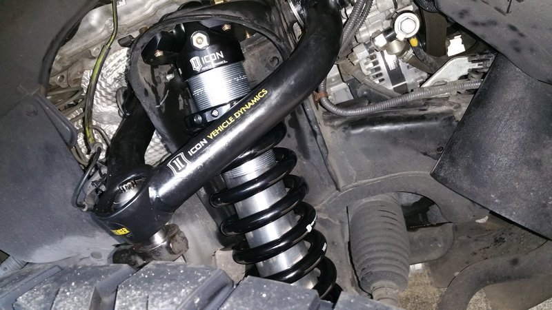

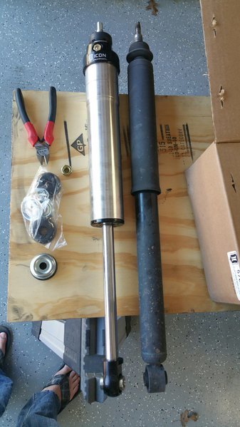

    I started to collect parts, Got the wheels on sale from Amazon and then the Icons during Black Friday
    [​IMG] [​IMG]

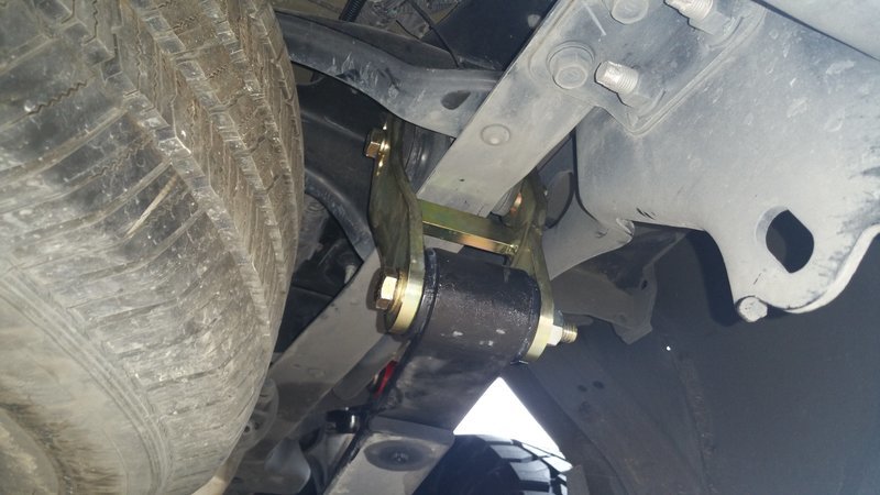

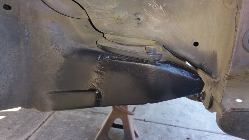

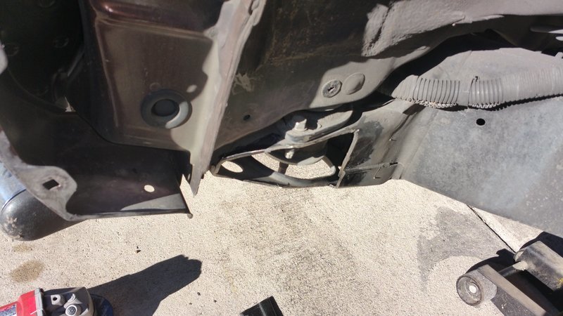

    In preparation for new larger tires, I did the body mount chop up front with plates from Relentless. I am not a professional welder by any means, but the grinder cleaned it up some

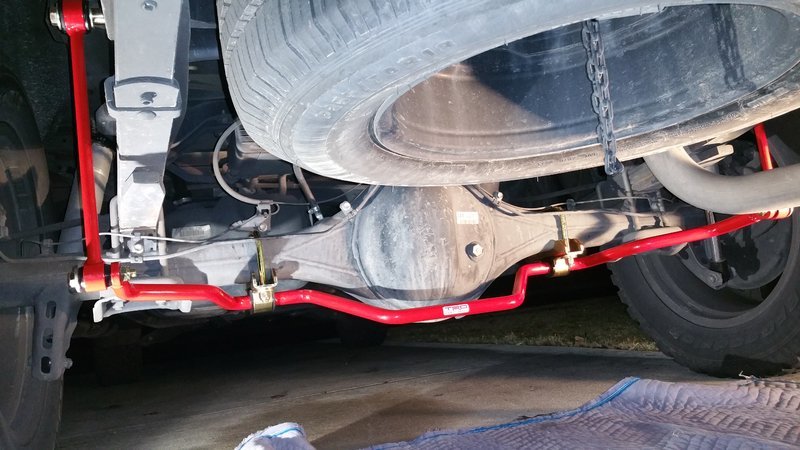

    Then I tackled the rear suspension.
    Hopefully someone learns from my mistake, I did components in the wrong order. I started with the rear shocks, then did the rear sway bar the following weekend, then the shackles the next. In hindsight the shackle should be installed first so you donot have to undo all the previous work, then the shock, then the sway bar.
    Christmas weekend I tackled the front suspension, plus wheels and tires
    After the alignment, I had to heat gun the front part of the inner fender well where the tire was rubbing

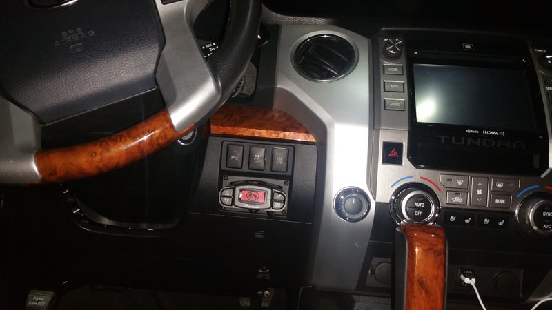

    Got in on an early group buy for an Edge Insight CTS2 for Toyota's from a Tundra Facebook page. It displays the correct speed for the larger tires plus displays temps and other info
    Christmas was good to my truck this year - P3 Brake controller with ESP dash panel and the ESP metal storage system
