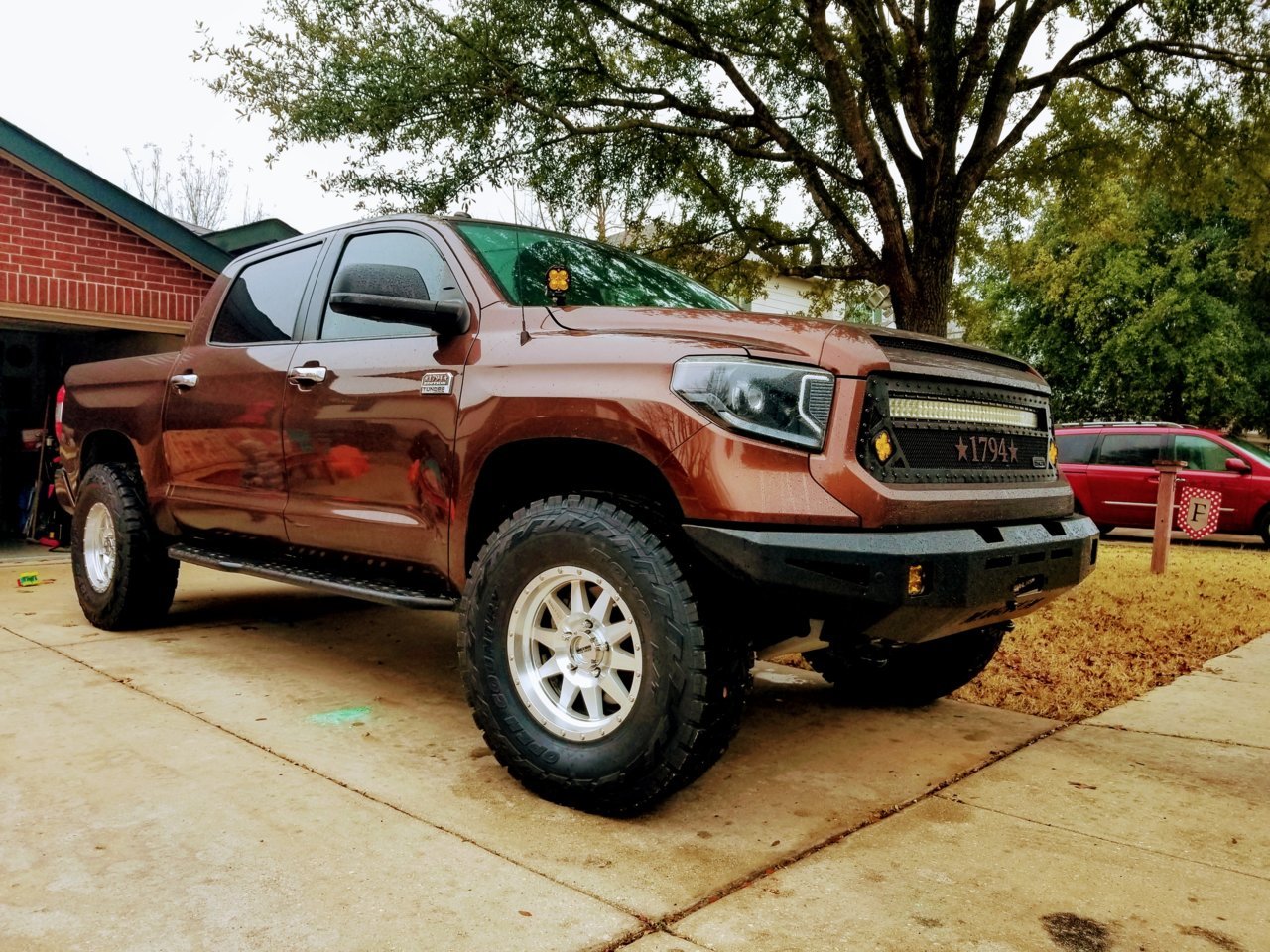

    Installed some Toyo RT 37x12.50R18 tires last week. Also installed some SPC UCAs to help push the wheels forward and still get a good alignment.
  10. Jan 25, 2021 at 8:53 AM
    #70
    Cfincke
    Cfincke [OP] Well-Known Member
    Feb 7, 2017
    #209946
    145
    San Antonio TX
    2014 Tundra 1794 sunset bronze
    Icon front & rear shocks, icon UCA, Method Standards, Nitto Ridge Grapplers, Retrax cover, TRD sway bar
    The 37s were just catching the mild BMC I did a few years ago, did not think I would ever go larger than 35s. Made a few cuts and hammered the plate back. Now have 1/2" of clearance. Going to road test the truck for a week or two to make sure I dont catch it anymore and weld it up.
