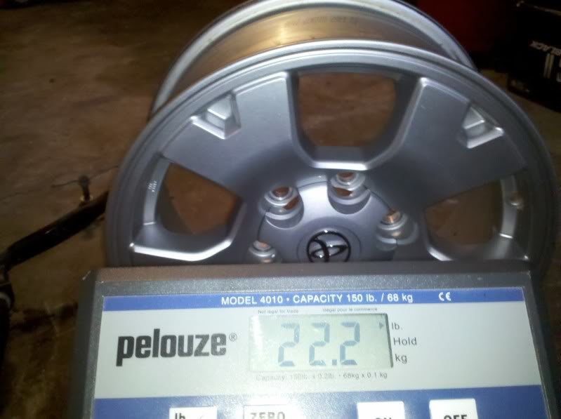

    I know I weighed my stock OR wheels when I sold them. I'll look for the weights

    Chris(NJ)
    Chris(NJ) [OP] Well-Known Member
    Jan 21, 2010
    #29777
    5,052
    Usually in Central Jersey
    08 Indigo 4x4 DC OR
    Mods are currently being changed .....
