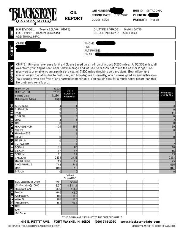

    Don't mind me. I'm just putting this in here for easier reference the next time I have to search for it :)
    I'm also putting my reminder in here that I just changed the air filter again today. Truck has 57,520 on the ticker.

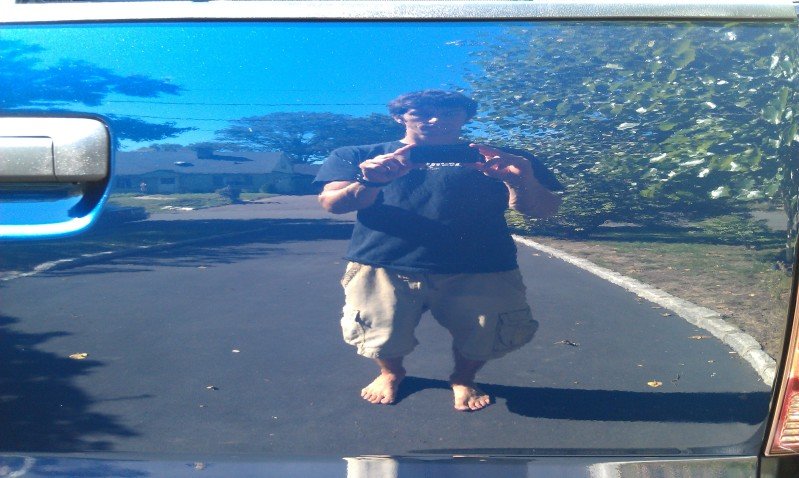

    Finally gave the truck a nice detail! I missed the opportunity to snap some good pics but hopefully I'll do that this week/weekend. I didn't do the normal picture taking throughout the process so I sorry, no cool in-detail pics of the mess
    Washed w/ CW&G
    Clay (Gray-Mild Cut)
    Rewash w/ CW&G
    Polished w/ PwS on an Orange Light Cut Pad
    Waxed with CG 50/50

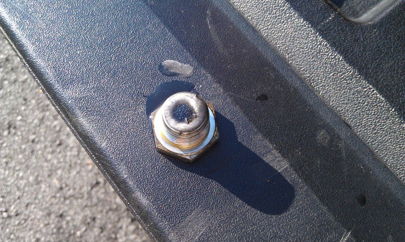

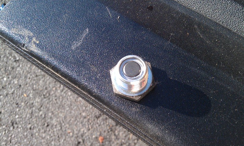

    10/5/12: I changed the manual trans fluid w/ MT-90 at apprx 62k miles. OEM fluid looked good and magnet held the normal dusting/shaving.
    Wiped it all off :)

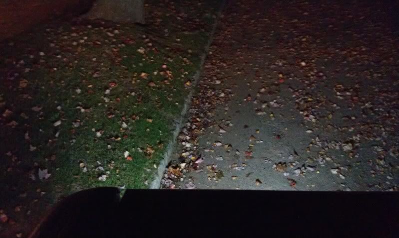

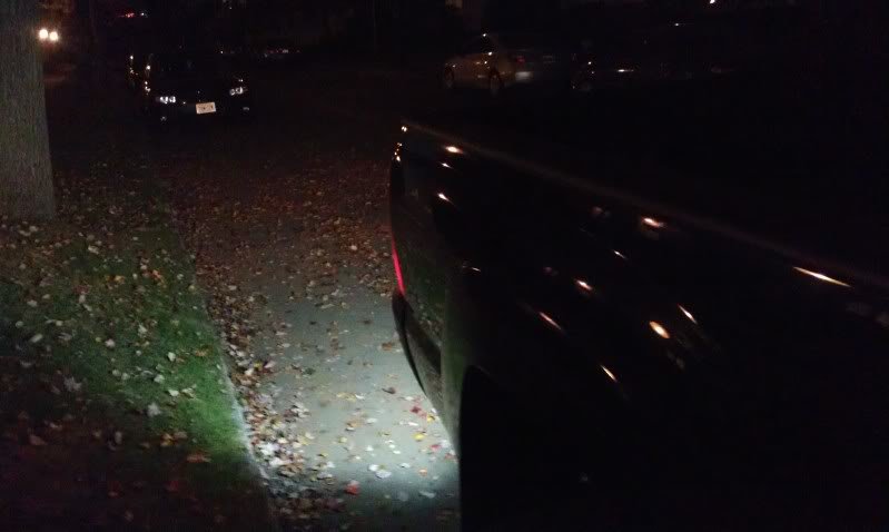

    10/27/12: Added one (of two) Rigid Industries reverse auxiliary lights.
    Mounted:
